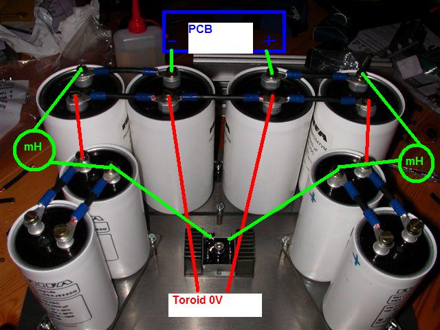

Hello!
I want to wire my PSU like on the picture.
Any doubt if the ground wiring is OK that way. (Ground loop?)
I would like to do it that way because then I would get a stright and clean way of the wires.
Thanks for your comments!
Martin

Martin,
I would connect the 0V wires from the toroid at one point just to be shure. The rest looks fine although the heatsink on the bridge rectifier seems very small compared to the aluminium chassis you bolted it to 😉
