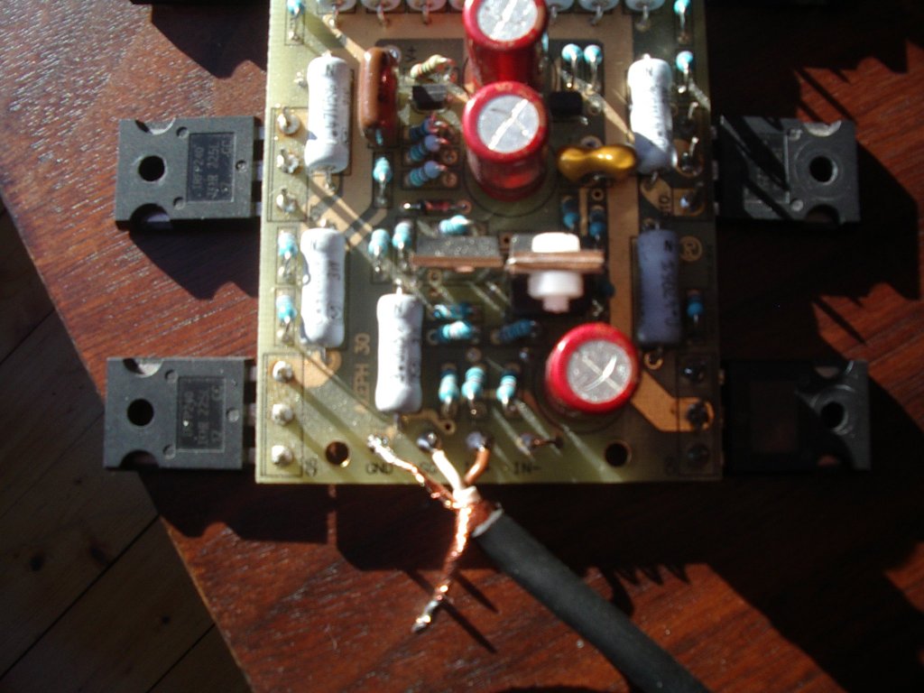

I have 2 aleph 30 pcb laying on my board and i have lost my papers on them. Can someone help me with the input connections ?
I have a bad pictures if that can help.
From left: gnd, sg, in+, in-. In the in- there is a small wire to the right unmarked hole.
Is In+ to pin 2 on xlr ?
Is SG to pin 1 ?
Is gnd to pin 3 ?

Pin 2 on XLR is +in and 1 is Signal Ground (SG).
As far as I can see in the picture, the -In is taken to ground to make the amp a single ended amp instead of a balanced input. Will work fine.
Cheers.
Leave the shorting jumper off of the board and make a shorting jumper to plug into the XLR that connects pin 1 and 3 when you are using the RCA inputs. Pass Labs supplies these with the amps they sell.
pin 1 is SG, pin 2 is in+, pin 3 is in-
