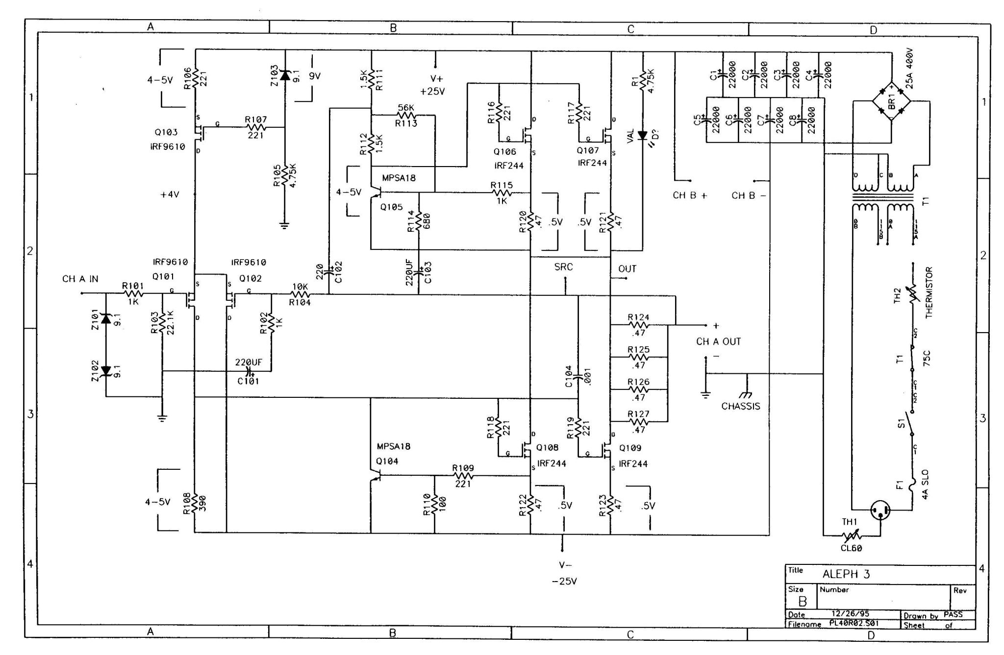

Just bought a pair of Pass Aleph 3 amps (original not clone/copy) but they are noisy and need a recap.
Does anyone have a schematic or circuit design for them and maybe a recommendation for which cap model to use, was probably going to look at Clarity as I've used them before.
caps - any brand name
you can bypass signal ones (small ones on channel pcbs) with nice solid cap (0u47-1u), piggybacking on copper side
best to open it, and measure what exact size you can squeeze in
