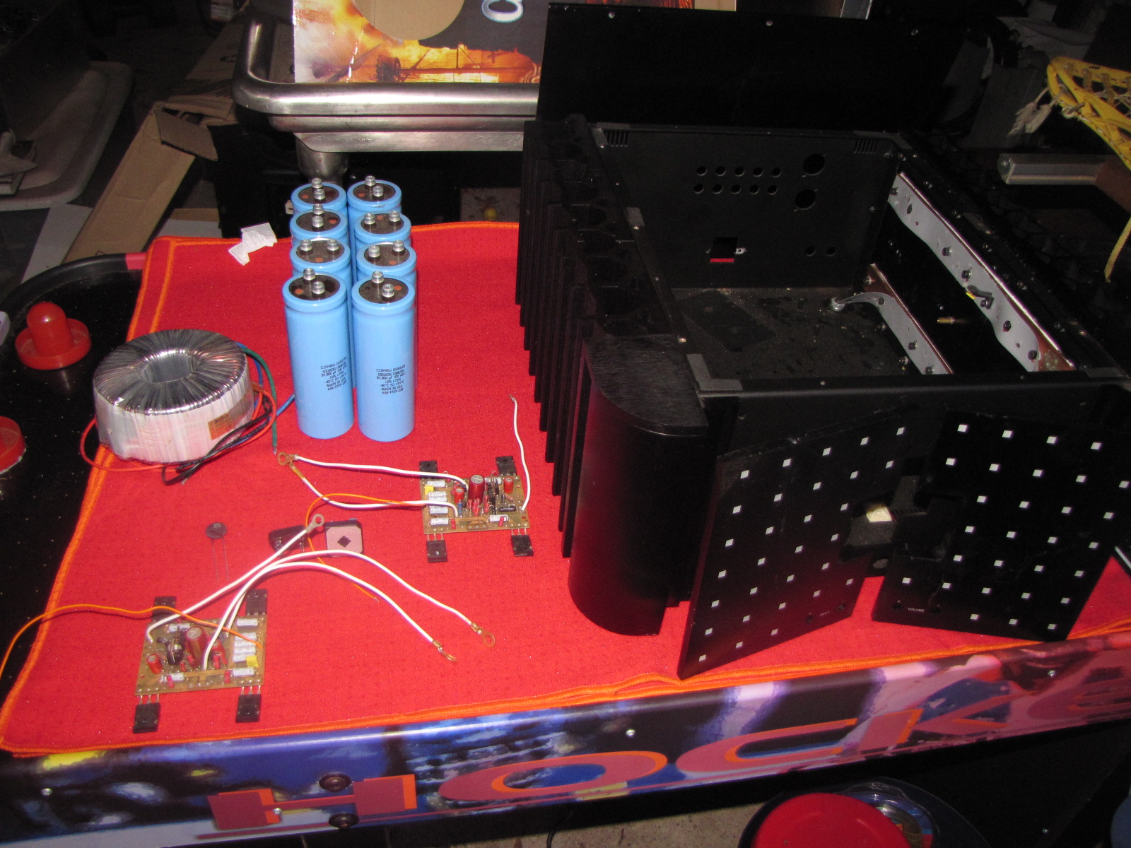

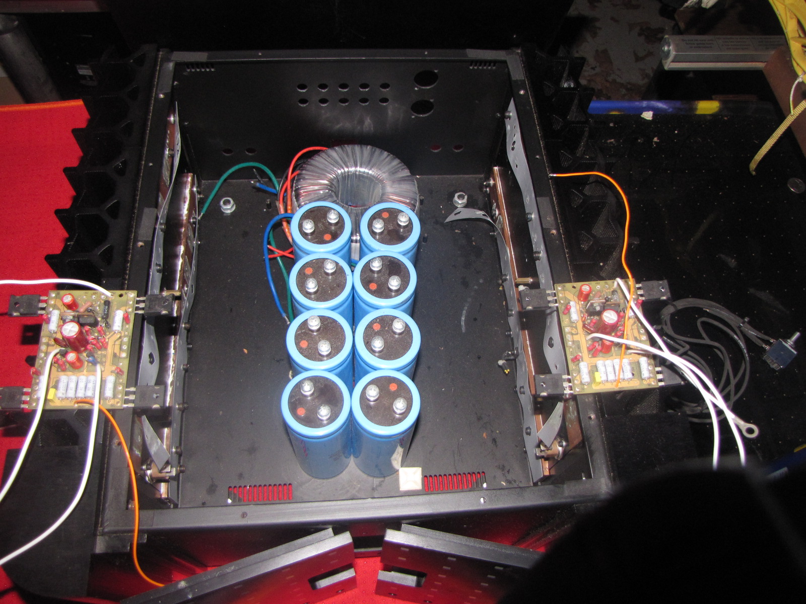

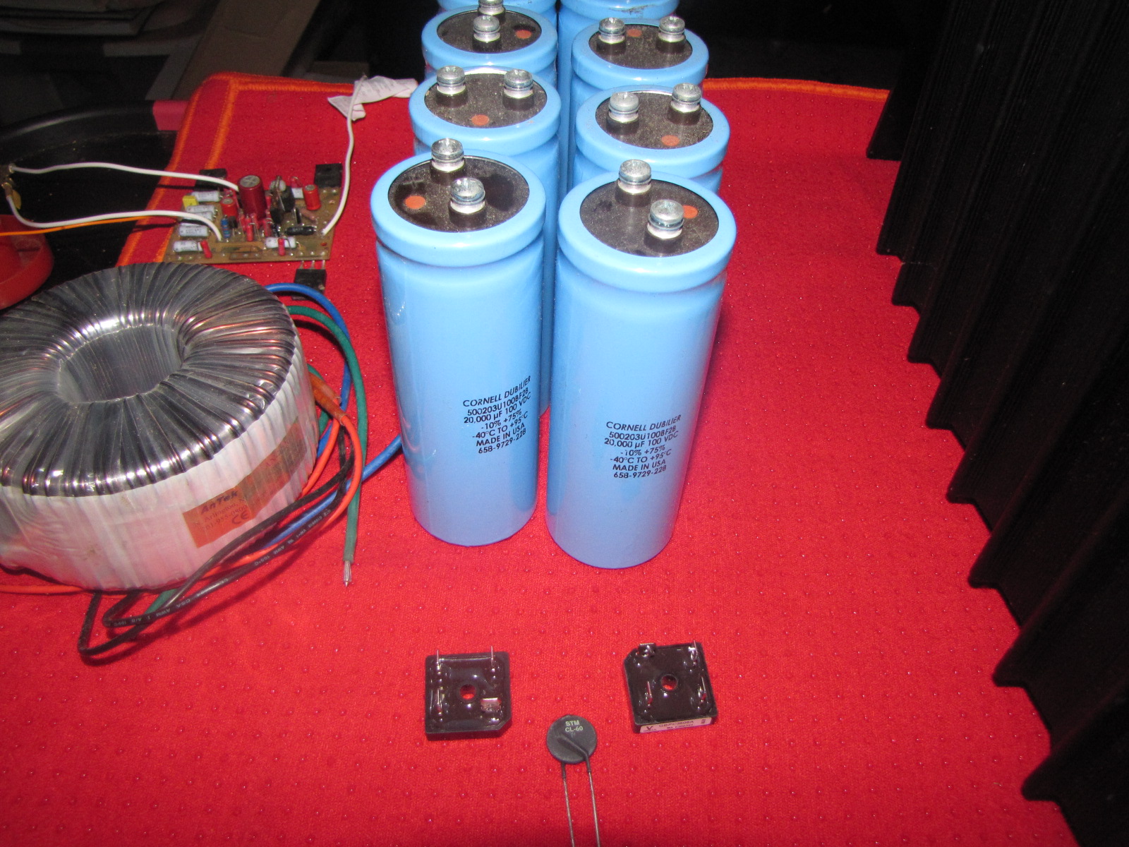

Newbie building a Aleph 3 . pics. attached. looking for info on the build and want to use 20k 100v caps in pic and looking for info on PS LAYOUT ,also would like to point to point [hardwire] the ps components. tnx in advance hopefully the build turns out ok!!

THAT KIND OF INFO, TNX ! ALSO ORDERED 4.7 UF JANZEN CAP FOR POWER SUPPLY . FOUND ALEPH3 POWER SUPPLY SCHEMATIC TODAY : ] I ALSO HAVE ANTEK 20+20 THINK 600VA
Think you are right to keep the electrolytics as far away from the heat sinks as possible.
You could cut a square piece of FR-4 or aluminum - drill 4 holes near the corners
and then connect the 4 terminals of the electrolytics to it.
This would be your ground reference node.
If you use FR-4, it will need to be sprayed with a mask to stop oxidizing.
You may want to consider insulating the tops of those electrolytics.
Will your case have ventilation from the bottom and the top ?
I see you are using a soft start - good.
I'm wondering - How important is it to keep the diodes bridges away from the amp circuitry ?
You want to keep the loops formed by the transformer - diodes - first large cap tight/short since current flow there is large and transient as it only flows when the voltage across the transformer secondary is higher than what is stored across the capacitance (plus the diode drop)
Thanks for the advise - I'll try to keep the secondary - diode - first cap loops short.
