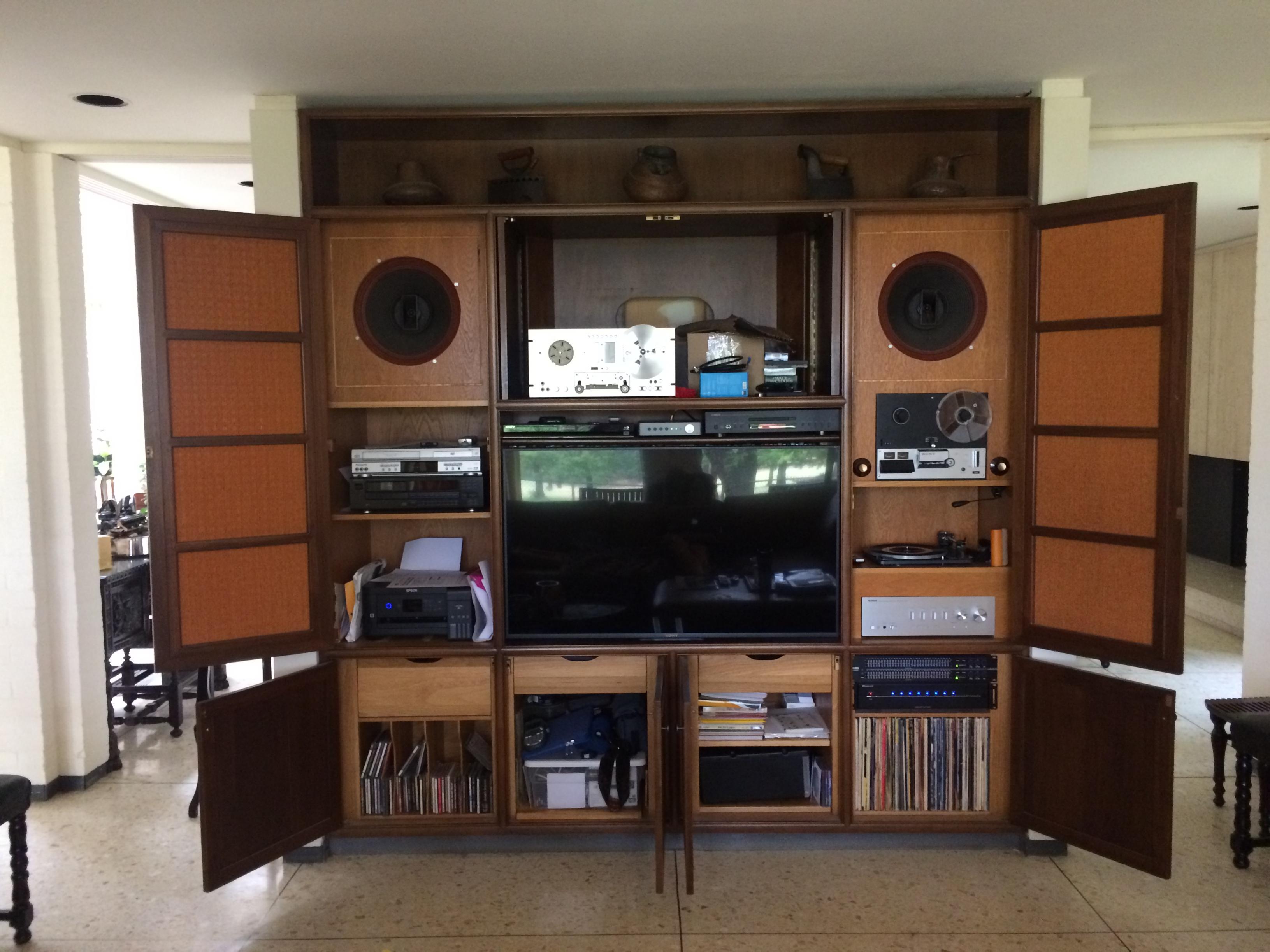

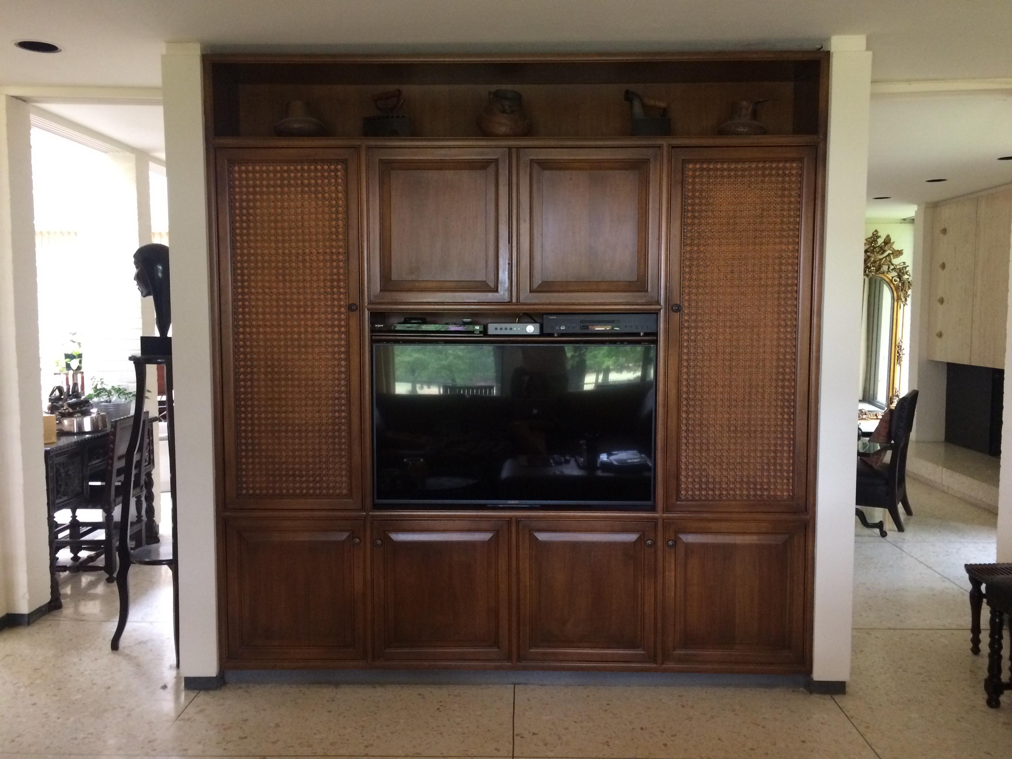

Five years ago my wife and I purchased a very unique modern design home that was built in 1967. The house was equipped with every possible high end feature available, including close circuit TV, electric curtains, solenoid controlled lighting from a central panels (one panel built into the master bedroom night stand controls every light in the house), stereo speakers in the ceiling of every room but one (Frazier of Dallas 1.5 cuft cabinet speakers with 8" Altec woofers and Foster horn tweeters), Sony RTR player, Dual 1009SK turntable, and a Fisher tube receiver (Fisher unit long gone). The one room without Frazier ceiling speakers is the "Media Room", which has 15" Wolverine LT15 triaxial speakers built into a walnut wall media cabinet . See attached photos.

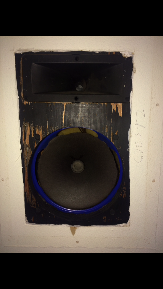

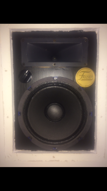

I spent last year (with the guidance and help of a great guy Glen) sorting out the Frazier speakers, rebuilding the original drivers, building new crossovers, and tuning the cabinets. if you are interested in more information, I posted the restoration process at Vintage 1967 Built In High End Home Hi Fi | Audiokarma Home Audio Stereo Discussion Forums

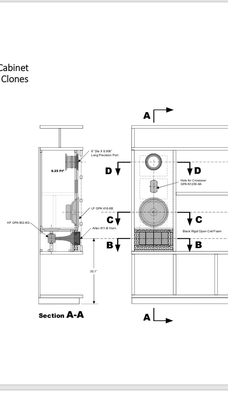

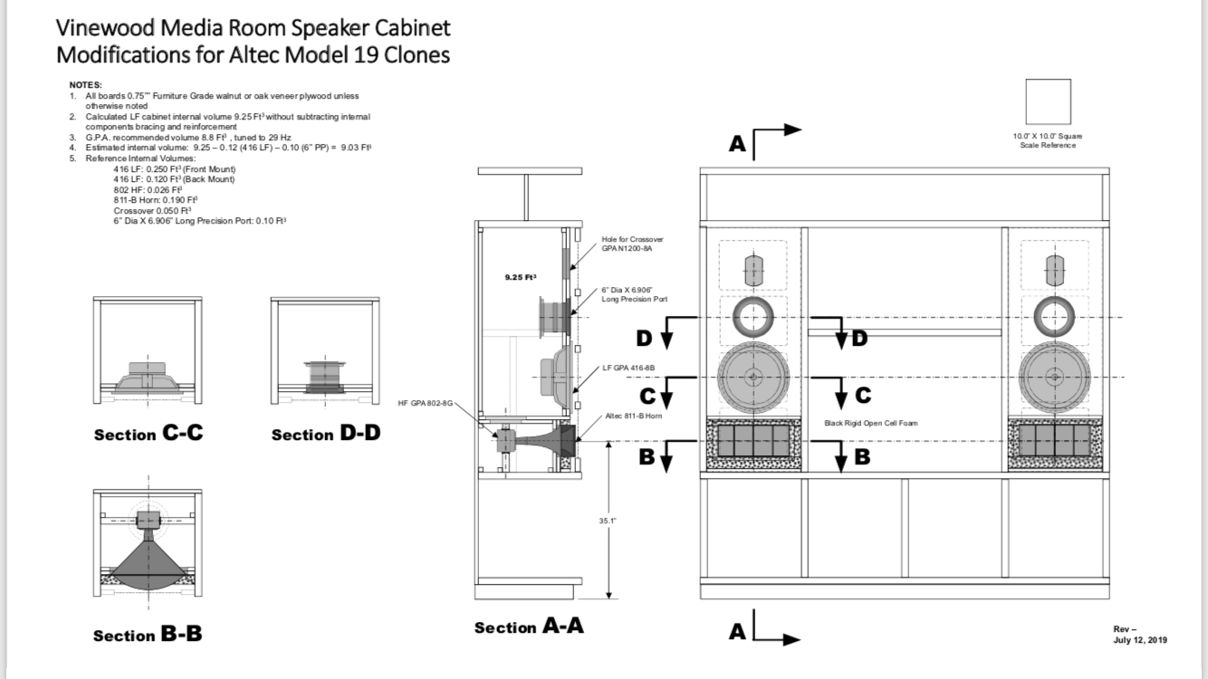

Over the past year I have spent many hours sketching different speaker configurations for the media center. Most of them utilized the Altec 604 coaxial as the basis. I started off trying to keep some of the electronics in the two side areas behind the hinge screens. But I came to the conclusion that it was best to make use of all the volume on the sides, and relocate all electronics to the area above the TV. This area (originally for the TV) is nice and deep, ventilated, and can be totally hidden by two doors that slide out from either side to disappear when open. This also gives me the freedom to change electronics more easily should I want to play with different amps, preamps or sources.
I thought I would try to fit an MTL configurationinto the space available. While I could just about make it fit, the compromises I needed to make did not guarantee success. While volume was adequate, port location and cross-sectional area were not optimal. Going back to a conventional bass reflex design was the best option. But I was hoping to get deeper base in the conventional 604 would get in a bass reflex cabinet. Also the 604 tweeter height was a little bit taller than my seating height on the couch. Without electronics in the area I could mounted lower, but the screens on the doors have woodframe bars that would block the tweeter with the door closed. So a complete re-think was required. FYI Wife is very understanding, but one house rule is that with the door closed the cabinets must look the same. I also do not want to butcher these beautiful walnut cabinets.
I had been reading a lot about the Altec Model 19, and had heard only good things. So using the dimensioned drawings I found of the Model 19 cabinet my plan changed course. Using the modern GPA 416-8B in a 8.8 cuft bass reflex cabinet gets me a respectable 25 Hz bottom end (according to GPA). While installing the the Altec 811-B horn below the 416 can get me the tweeter height closer to optimal. Reading the Model 19 manual I even discovered instructions on how to position the cabinets upside down for studio use. As a final bonus, the drivers clear almost all the screen obstructions.
I was looking for some sign from the audio gods to tell me if this was the best direction to go with the cabinet design. The sign came from an ad on eBay forAltec 811 horns for sale in perfect originalcondition, and just 15 minutes drive from my house. Within one hour of seeing the ad I purchased the horns and brought them home.They were just as described perfect condition and they only cost me $90. In seeing these huge aluminum monstrosities my wife commented "Well if you don't use them for the speakers, I can make them into some very interesting flower vases�.
Over the past year I have been putting aside funds for this project. Last week I communicated with Bill at GPA, and told him I would be putting in an order for all the parts I needed within the next few weeks. Oklahoma City is just a 3 hour drive North of me. So I can pick up all the components and save both shipping and worry.
Now I need some input and comments from the DIY Audio community. Please take a look at the attached plans (low resolution in photo, high res in PDF) and let me know what you think. I am especially interested in any comments regarding the port location and size, placement and type dampening material to use, and any thoughts concerning cabinet rigidity. Note that I have isolated the HF horn completely from the LF volume. I have also moved the LF and HF drivers closer together. Depth of driver mounting is identical to the Model 19.
The top,bottom, and sides of the cabinets are 1.50" furniture grade plywood (no voids). The front and back of the cabinets will be 0.75"� furniture grade plywood with0.75" MDF bonded to it. I am thinking that with this thickness there is no need for any internal bracing. But I need some reassurance.
All comments and suggestions welcome.
Thanks in advance.

I see two different sets of furniture here ?

Personally, I'd hide the big ducted port ( or just make it a simple slot port located at the top of the baffle board ). I'd also hide the crossover face/knobs ( within a drawer maybe ?? ).
Aesthetically, I'd prefer to see nothing but an expanse of nice wood grain above the woofer ( but that's just my opinion as if it were my stuff ).
I like the horn height and woofer layout / that should work well enough for you ( & the shortish throw distance to the couch and glass ).
I'd also advise to the making of a plain mockup ( removable ) plywood baffle-board where you can experiment with different box tunings ( and maybe port locations ).
It's not a slam-dunk that you're going to get the bass response that you expect and want due to this media center effectively being located ( acoustically ) in a much larger room than its immediate location.
Locating the woofer almost 1/2 way between floor and ceiling will trigger some rarely encountered room modes ( exactly which ones, I can't really tell you ).
You'll want to get a test mic and learn to use something like REW ( to help identify and then tame your somewhat hostile room acoustics > from all the glass & polished marble/terrazzo ).

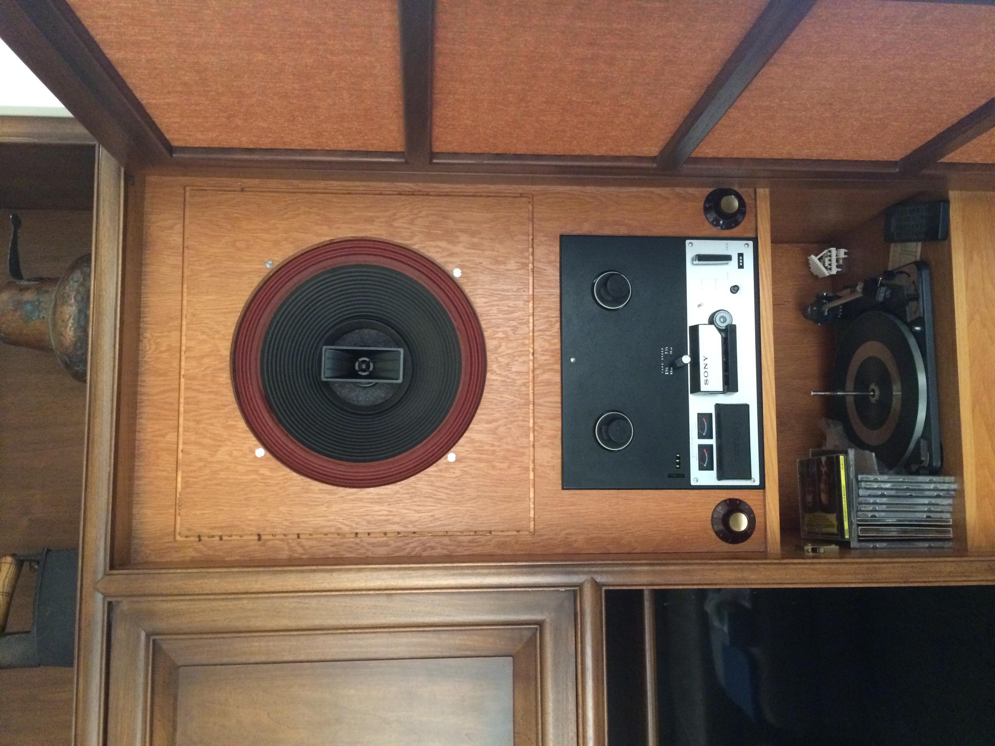

FYI. Some of my posted photos are from the prior owners furniture.

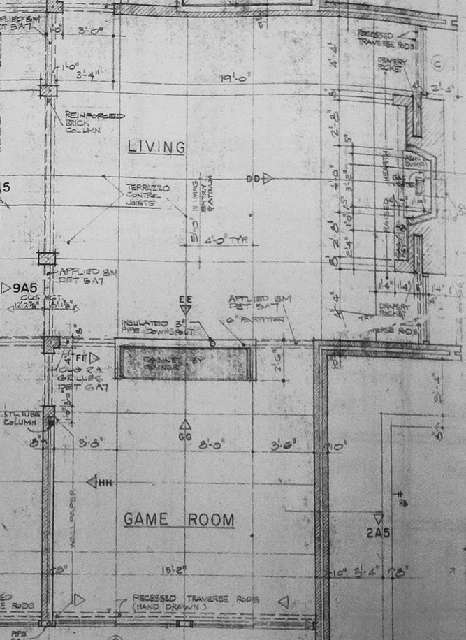

GM, I was hoping you would respond to my post. Regarding your request for more detailed info, attached is a photo of the house's floor plan blueprint showing the media room dimensions, and the living room behind the media center wall.
The woofer I plan to be using is the Model 19's 416-8B. I was just referring to the driver height of some cabinet designs using the 604. The only other knob I have available to turn is the baffle board inclination. I can incline it down a few degrees if it can help in any way.

I tried helping on several sites including GPA before the buyout/reconstruction and while I helped some, the basic structure of FB is no place for any serious effort nor long term storage for reference, so basically avoid it like the plague.
Re the room, pretty much what I feared, got a ~same divided room situation locally, though his is a large separates horn system, so some flexibility.
Regardless, the 'heart'/'magic' of the M19 is its XO combined with driver spacing and offset, so need to adhere to the factory spacing dims as close as practical.
Ideally, the width/height of the horn recess should be the same with replica foam inserts, though IIRC these are no longer available, so either DIY something close or line with 1" acoustic fiberglass insulation same as the early M19, Valencia 846B and 878B Santiago.
The closed off horn box should be ~stuffed with blocks of rafter fiberglass insulation or better still, open it up like the M19 for some extra net volume [Vb] and just damped like it.
The Woofer box appears long enough to justify centering the vent at L [i.d.]*0.848, so up near the top or a shelf vent at the very top or either located out of sight on the top [each will have minor tuning differences].
Then there's the room modes to consider and while we can assume where the modes theoretically are, we don't know how lossy the floor or ceiling is, so short of mapping it they may be offset one way or the other.
Know any roofing, foundation details?

Thank you for the input GM. Attached is a Rev A drawing showing the port center relocated to 0.848 X the box inside height dimension. Any thoughts on port configuration? Round versus rectangular, single versus dual, etc?
The spacing between the horn and the woofer is currently slightly smaller than on the 19. But if it is critical I can match the 19 spacing. I changed it to better match the grill openings, but most of the time the doors with the grills will be open.
I have enough volume to meet the GPA recommended 8.8 ft.³ for the 416 woofer without adding the volume around the horn. Plus people have commented that it is beneficial to keep the volumes between the horn and the woofer separate. Personally I want to keep the volume for the horn separate to allow me to re-position the angle without affecting the sealing of the cabinet.
Regarding construction of the room. The floor is pier and beam construction. Floor joists are 2” x 12” on 12” centers. The terrazzo floor is 8” thick concrete and quartz stones. The flat roof ceiling is also 2” x 12”s, but on 18” centers. It is also a flat roof, so the space between the ceiling and the roof is stuffed with fiberglass installation. The surface of the ceiling is not conventional American drywall but is what is called here plasterboard. Which is both thicker and smoother. FYI, the walls are not plaster but are double row brick construction. The left wall however is covered with a tapestry like material floor to ceiling.

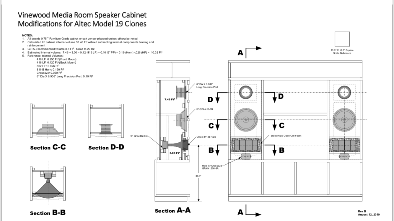

Check Out Rev B to Cabinet Design
Well I am finally back home and have some time to revise the Model 19 cabinet design to incorporate GM's and other DIY member comments. Thank you.
The Rev B changes are as follows;
1) 811B horn has been raised 3.5" to 38.6", Closer to ear height.
2) 416-8B woofer CL distance to horn CL change to match Model 19.
3) Horn and woofer now occupy one cabinet volume, which;
a) Simplifies cabinet construction.
b) Reduces cabinet depth to be less square.
c) Provides more than enough volume for bracing and tuning (1.0 cut).
4) Crossover L-Pad panel rotated 90 deg and moved to below the horn. This will require I fabricate a new panel. But the GPA panel is not as classy as the original Altec panel anyway. I can get some brass panels made at a local trophy shop with the Altec logo silk screened on.
5) Grill support on door now centered across middle of woofer. But doors will be open for serious listening anyway.
No sawdust is on the floor yet. So more comments are welcome. Copy of Rev B drawing attached.
Final Custom Built In Altec Model 19 Cabinets Rev C
Was hoping to get some more thoughts from GM or others on the Rev B version of the cabinet plans I posted last week. But in the absence of any additional comments, they must be perfect. Right? 😀
Well not perfect enough for me at least. So therefore attached is Rev C, what should be the final version. Barring any unexpected discoveries when I cut the front off the old cabinets and see what is back there.
Changes from last time are mostly fine tuning and details.
a) Front and back now 1.50" thick, matching the thickness of the existing cabinet sides and bottom. The 0.75" Baltic Birch isn't that expensive for the little I need.
b) Back of cabinet positioned to reduce excess estimated cabinet volume to 0.3 cubic ft over the optimum 8.80 cubic ft. Enough to provide for tuning and unexpected added bracing. Although with all sides 1.50" thick, I don't expect any added bracing will be required.
c) Details on corner reinforcements and L-pad installation added.
For grins I did a estimate of how much the completed cabinets would weigh if they were designed as stand alone speakers. About 220 LBS each. Good thing I will never need to move them. 😉
Heading out of town again for a week. Will begin ordering all necessary components, hardware and wood when I get back. Any last minute comments or ideas welcome.
What's to check? No dims on rev B. Forgot about the eigenmodes, but the layout is too 'fixed', so it is what it is.
Rev C: I have a 17.25" ctc spacing and an i.d height of 46.1/0.848 = 54.36" based on recommended vent offset.
0.3 ft^3 isn't enough to audibly affect tuning.
