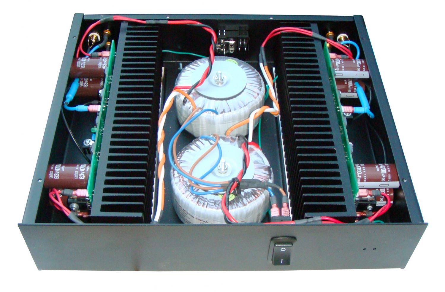

Hi Hugh,what size transformer and type do you recommend for the NAKSA125 and what price is the very clever case that can be sold with the NAKSA125 modules fitted to drilled and tapped heatsinks... thanks 🙂
Hi PP,
Transformers needed are 2 x 300VA toroids each with two 35Vac secondaries - see website. Standard toroids are fine earlier used with the AKSA 100 is just fine.
Altronics, Harbuch and Tortech all make them in Oz, easily sourced. They cost around $75 each.
The case is $165 plus GST, with complete holes, cuts, folds, and semi-gloss powder case. Makes building the amp a snap. See attachment!
Hugh
