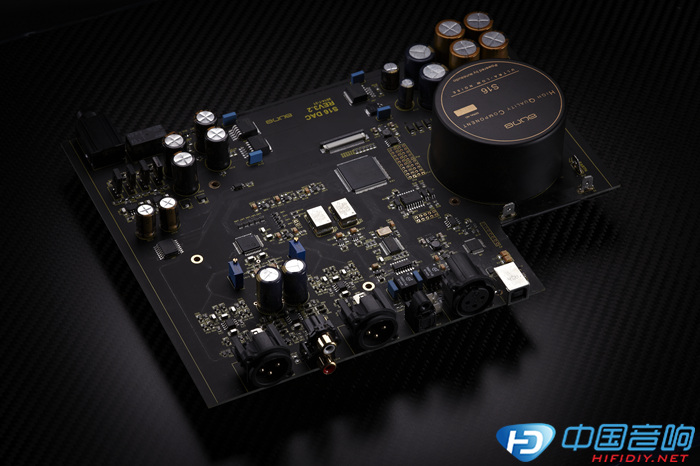

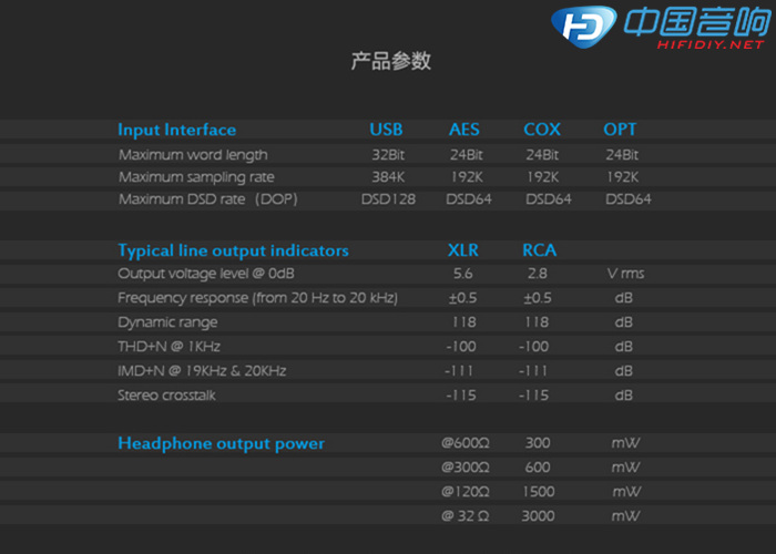

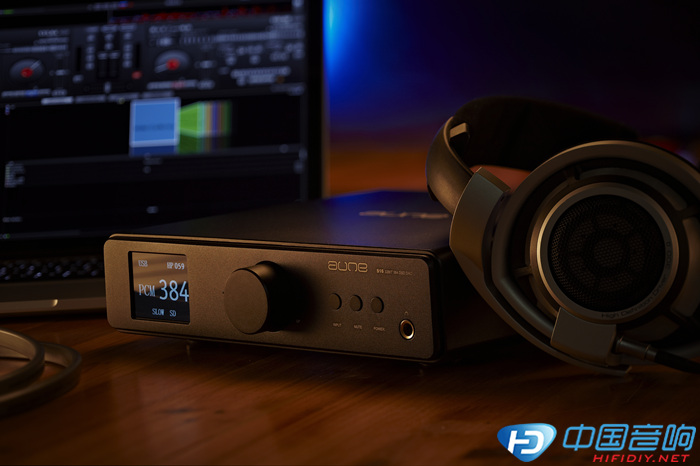

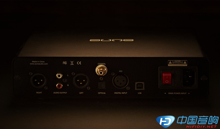

The above is true up to today that I can't help to purchase their S16 DAC because the spec is too attractive. I am posting a few of their pictures here as reference. S16 is developed based on AKM's AK4495SEQ. There is another driving force for this purchase because during my recent removal, I found my AKG 701 headphone sitting in a drawer that I don't have any headphone amp for it. S16 is having a headphone output that can bring my AKG 701 into live again. I am expecting to receive it within the next few days that as a diyer, I am always looking for rooms to improve.
I am using Weiliang's dual AK4399 digital section and Universal Tube Output from diyhifisupply as analog output today that; I believe, is the best DAC I ever have. I am longing to see if someone can work out a "public pcb" for AK4495SEQ (perhaps dual) so we can have a taste of newer technology from AKM.
