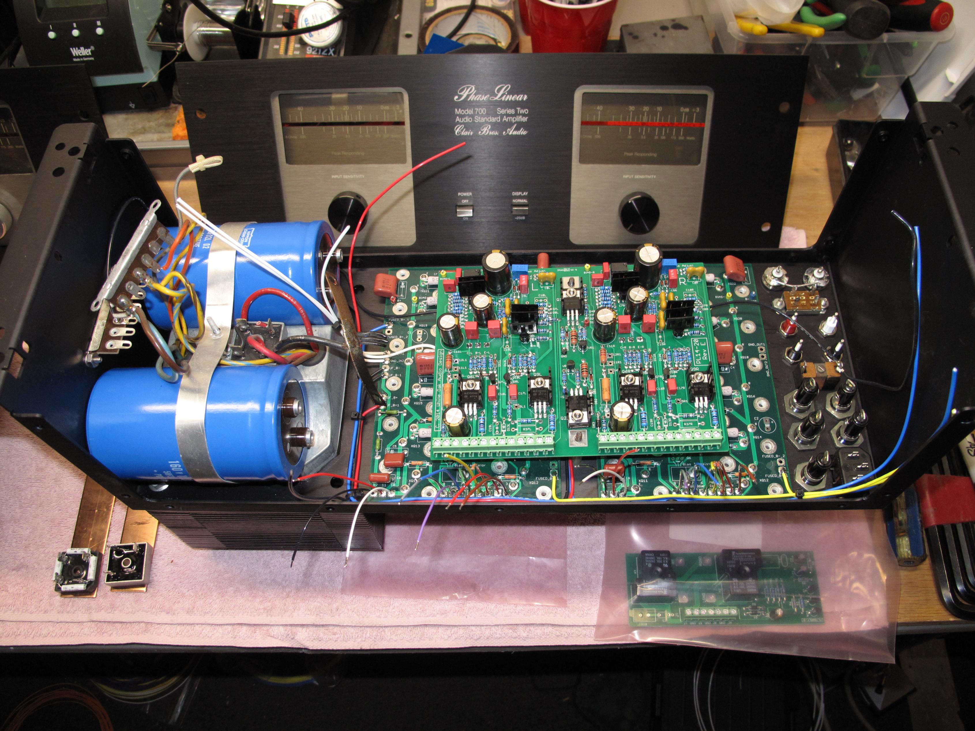

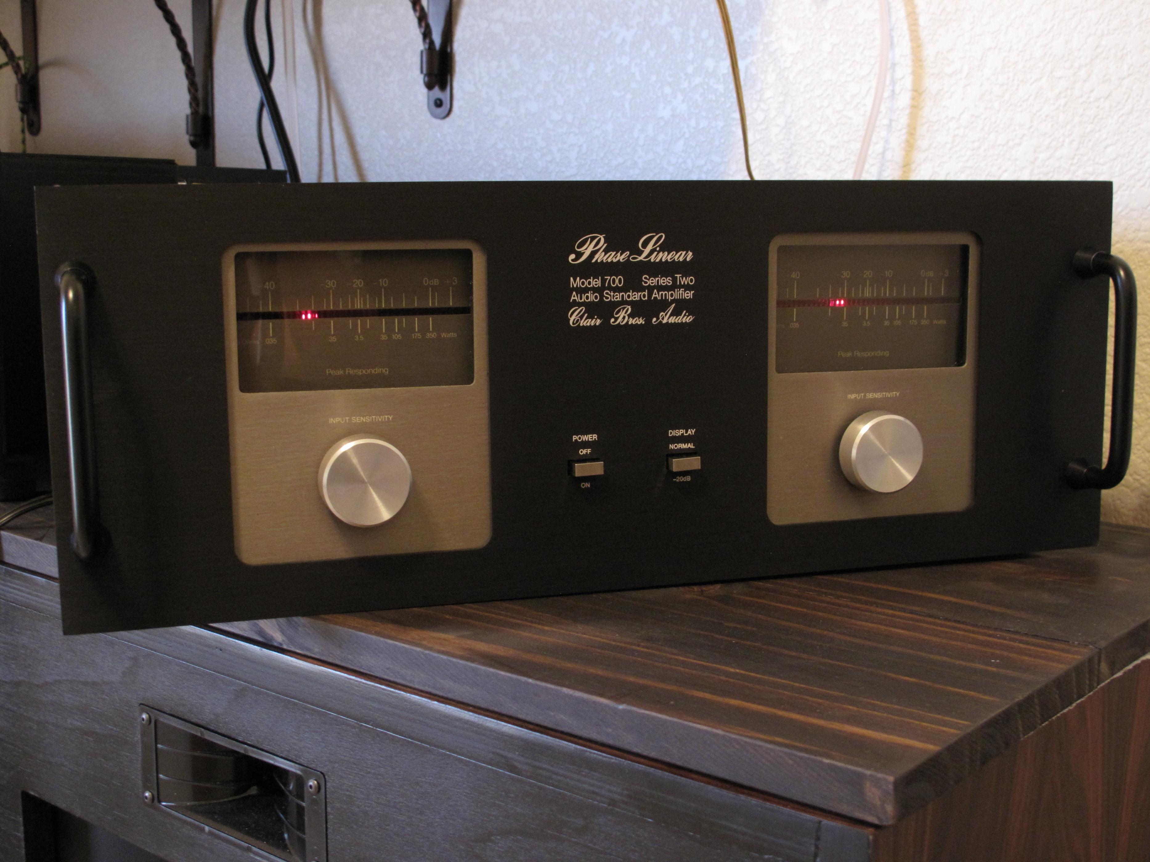

Dan, he must not have read your answer very closely. I look forward to building one of these soon to go with my hand built White Oak Phase Linear 700 Series II Clair Bros special. I scored some of these amps and have been building them for some of my friends. Been looking for a preamp I can put together to go with it. Maybe I'll offer them as a "Pair".
