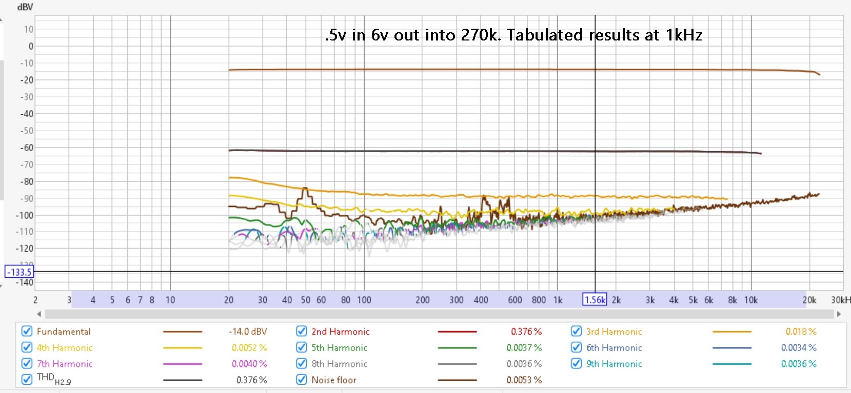

I at last built up my Akido line preamp and compared input tubes-12AX7 and 12AT7, using 12AU7 for low impedance output to drive a single EL34 to about 8watts.

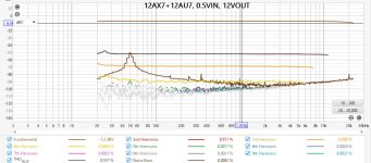

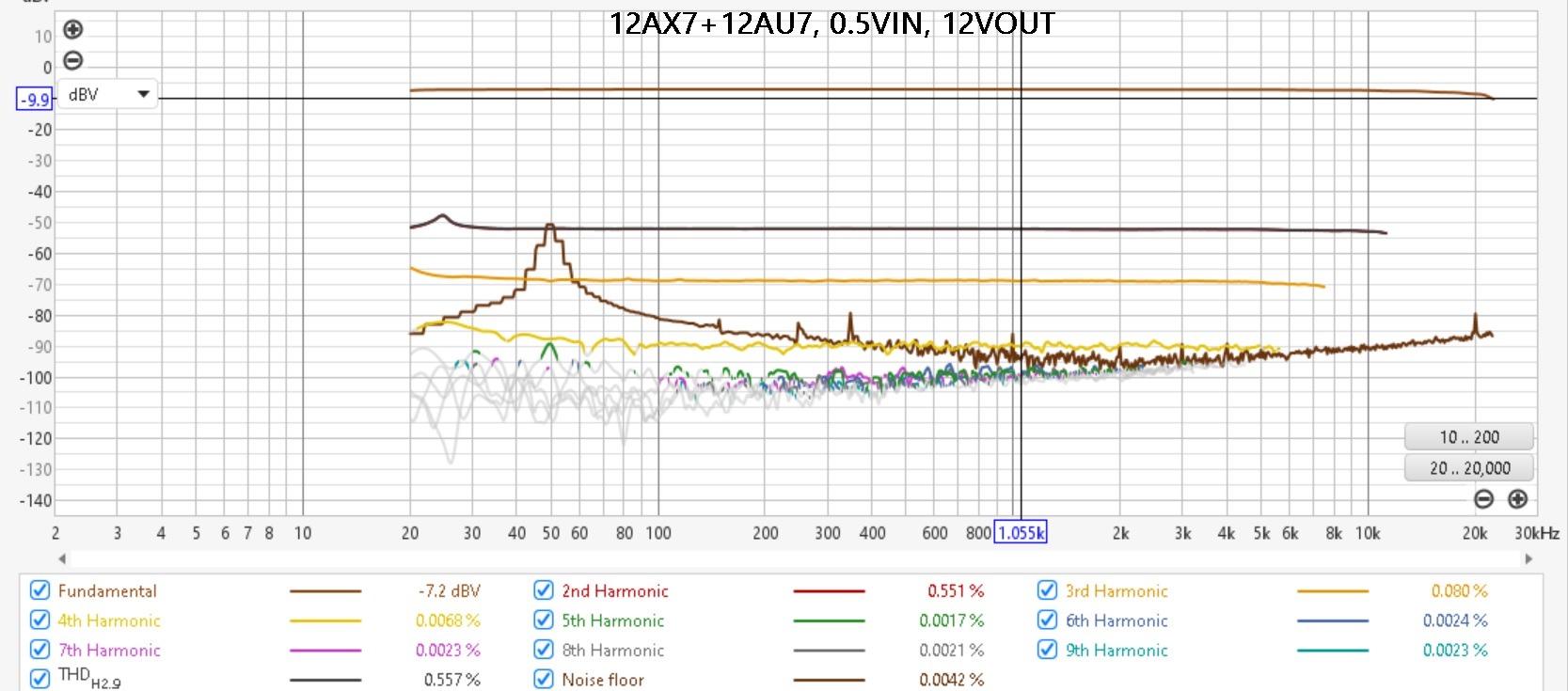

With a 12AX7 input tube, the gain is about 24x but max input is about 0.5v (12v out) before the distortion increases rapidly.
With a 12AT7 it's half so 1v in = 12v out before the 2nd harmonic starts to ezceed 1%.
The HT is 200v from a PS21 regulated power supply. I am waiting for parts to finish the output stage so can't audition it just yet.
With either tube, 2nd harmonic distortion predominates. (there is no global feedback)

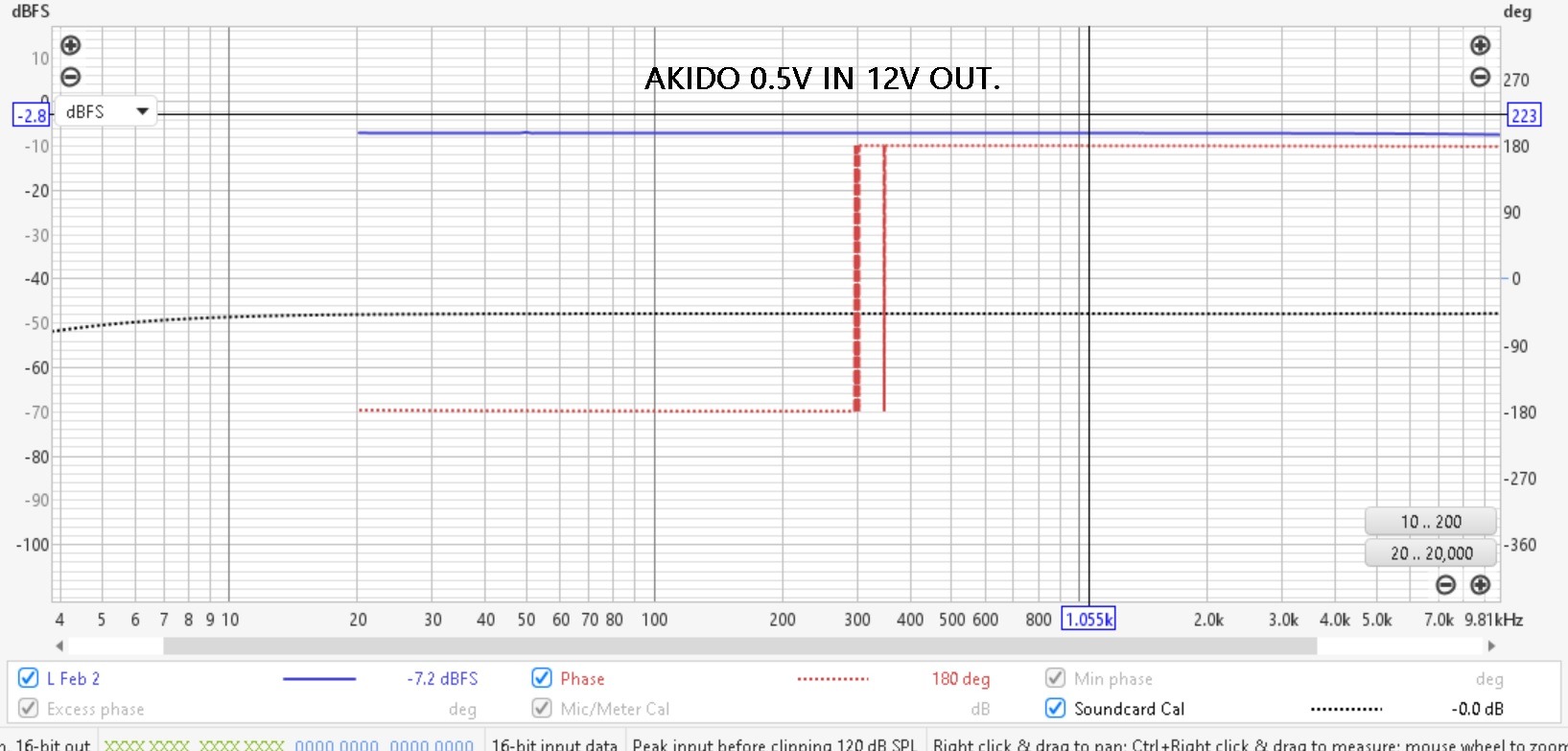

But I can't explain the phase shifts - from +180 to -180 instantly, with the frequency of the switch varying with input level and tube type.
I suspect it's something to do with the Akido's noise and hum cancellation design.

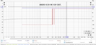

I've not had anything similar when measuring the old SE amp, nor 2 MF X10 clones nor solid state amps.
I disconnected the power supply feed capacitor to the lower triode of the output 12AU7 but this did not have any effect, so it's still a mystery.
I'll put it down to, as you suggest, a measurement artifact.

Still have the strange measurement phase effect of an apparent 360degrees shift which doesn't happen if I do a loopback test.
