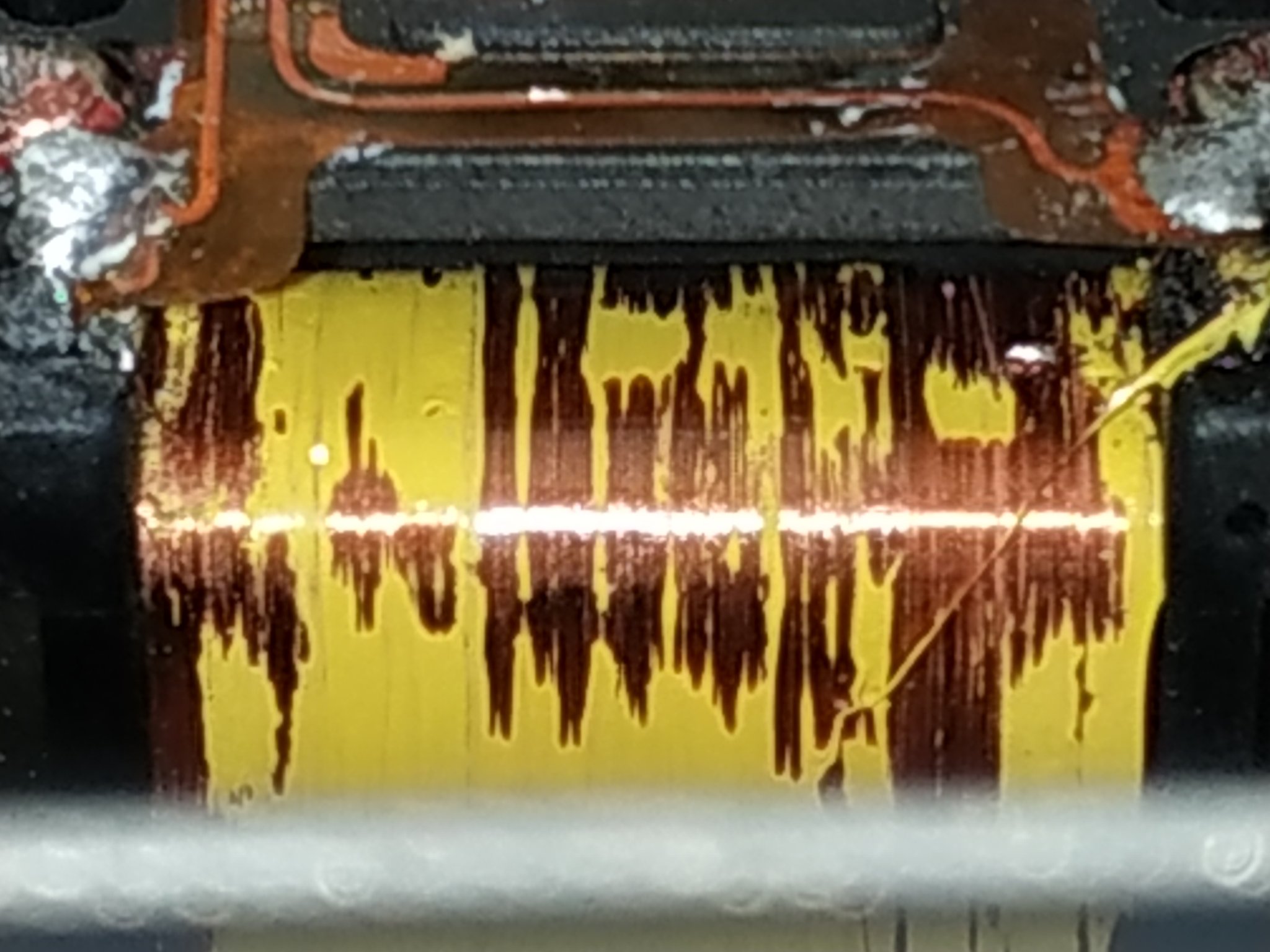

The coil is quite removable from the linear drive with moderate disassembly, so I took mine out for a closer look. Like HF loudspeaker units these appear to have a tendency to fail first on the section of wire trailing out both ends to the solder terminals - one or both of mine had gone here. Once was still accessible with tweezers, and I was able to successfully take off one wind and refix. The other was unfortunately not accessible, so I fished around gently and found what seemed to be a loose end. I connected all back, and regained continuity - unfortunately at a much lower coil resistance (around 0.15kohms) than other contributors have suggested is correct (3.16kohm). So, I must have either damaged the coil and broken out another 'end' of the winding and / or it's shorter somewhere - most likely the former. I tried it, and sure enough the door issue was tamed, without the TR3 grounding mod....but, the control was not there, sled just moving too wildly. I guess this probably illustrates a lack of voltage being induced in the sensor coil, due to the insufficient (less than 5%?) windings still in play.
So, the guitar pickups pointer from electricboyo is now looking most helpful, thank you. I'm thinking about a repair of the coil, it's pretty simple construction, albeit very fine winding, as observed - I shall look into it. I may try rewinding it myself (!) and / or approach a friendly guitar pickup winder 😊.

I also removed the sense coil from my Akai to try and repair it but failed for the same reasons. My plan was to try and rewind it or get someone to do it for me but so far I haven't done any more with it.
The wire for the Akai coil is, I think, 0.04mm diameter, which is available but very fine and easily broken. Winding this isn't going to be an easy job and beyond my skills.

In my case, I removed the sensor coil completely several times in the course of repairs (requires some careful disassembly of the Akai linear motor / sensor assembly for the KSS-151a, easier than in some other Sony's). Initially I hoped a sensor coil from say a similar KSS-151a Sony or Denon might be substitutable as they looked very similar. Alas, the dimensions are different and electrically I suspect they measure differently - only the Akai's sensor coil body seems to suit the Akai magnet / rail. So, once the coil was off, under magnification I looked for any obvious break near either terminals (the coil wires mount to the same terminal as the ribbon tape does). Maybe just unwind a turn and therefore an easier fix for some?? Nothing was obvious in my case. So, I opted for gradually unravelling the coil to find a break. I eventually found a the break and as a first attempt tried to resolder the remaining (shortened coil). After some real difficulty with such fine wire (and some degree of inexperience!) , it was eventually reconnected. It measured badly now but nonetheless, when tested (with the discussed resistor mod removed) it likewise tamed the door fault. The CD now went on to read too, but the sled was prone to significantly over-shooting during track selections and playback tracking. Sled control was now well out of calibration, due to the amended / shortened sensor coil. I could not see any easy way to compensate electrically, I tried adding the resistor mod partially, also some resistance in series as a looksee - as expected it didn't make up for the (now) incorrect sensor coil. Resistance adjustments (with a resistor in line) either just killed the motion totally or left it uncontrolled. It needs roughly the correct sensor coil...
So, I decided to attempt to get some wire and wind (my first ever!) coil. I noted the winding direction and relevant terminals (important!), then removed the original wire and measured the total length as best as possible. I then tried to get some resistance and length measurements and ***** the wire guage required from basic maths and visuals. I had nothing to compare too and no other estimate posted at that point. It was approximate and I could not risk going too low on the wire-guage as I understood it would probably be impossible without a proper winding rig, by hand. So, I went for as low as I dared, 0.056mm, and probably the lowest guage I could easily source. I figured I would just wind as close to the original number of turns as possible, and see how it worked out back in use! I used an online calculator I found via google to help approximate the number of turns on the original coil Vs the resistance required with the DIY winding, so I could count / measure when winding. If it worked I could always get something more accurate and better made...maybe somewhere?! I figured, as the unit was not operating anyway, then any working linear motion feedback system for the sled would be better than none, as long as it got close enough when travelling the electronics would likely control it well enough to let the laser home-in, and it didn't need to be as perfect as, say, a voicecoil, with the incredibly tight clearances and tolerance, which affects performance and matching alot. Clearance required for this coil is not a problem, it can even be a bit messy, worst case, as long as the winding has enough, tidy enough, turns in the right direction
Once the sensor coil was again removed and stripped of all original wire. I found the right size insert / rod to act as a (very) basic coil-body holder to insert into a held-down, handheld drill, feeding wire from the reel held on a stick between the knees! The wire broke many times the first 10 mins I tried, it was so fine. I got better, adjusted the speeds and angles to minimise the strain on the fine wire, learnt how best to let it slide / guide multiple passes, with just enough tension. I had a fair few failed attempts in the beginning and had to remove and restart. Eventually, I had a run which was about 80% of what I had calculated as required turns / resistance. I could have persevered to get the perfect run, but I decided to give it a go, as it was...
...basically, it worked straight away. It didn't even need any adjustments.

Are you able to tell me which terminal is the start and of the coil and which direction the wire needs to be wound. I didn't make a note of this information when I removed the old wire from my one so I can't make that repair now even though I have the wire and a small coil winder.
Hi - not sure how best to explain from memory...one end needs to be fixed to the former /.body first (I think it was fixed on first at the rearward / transformer end, there are multiple passes required, obviously wound as one continuous length, winding in the same rotational direction. At the time, I made an aide-memoire as I unravelled the original, as I thought I might need to come back to it! I also took some close-ups before it was disassembled. The video should be the best guide - I hope this helps. All the best.

I wound the coil for my one today but unfortunately it didn't work for me. The resistance is 2.9K with 7500 turns of 0.05mm wire so slightly lower than hoped.
The tray will now load smoothly without the wire link in place but the disc doesn't spin and nothing else happens once loaded.
If the sled is moved back manually it goes crazy and hammers back and force against the end stops so I now have another fault with this crazy CD player.
I would definitely try connecting the coil ends the other way around, in case that is the fault...it may be difficult to see the correct direction from the video... Alternately, try rewinding the other direction to what you have.
Unless there is some other fault, it should come down to correct winding direction + correct connection terminals.

I tried reversing the sense coil and it is now behaving itself. The disc spins up and loads as it should and the tray operates smoothly without any issues. That is the first time in 20 years it has been reliable without the wire link mod so I think my coil is good, just 180 degrees out. It was easy to fix with two small track cuts and a couple of wire links.
