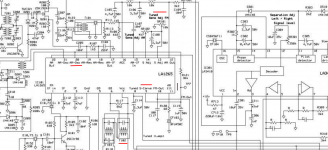

Got an Akai AT-27 tuner that works fine except for FM Auto/Mono feature.
When FM Auto is selected ALL stations are muted.
When MONO is selected all stations play fine.
I reckon FM Auto should select FM STEREO, if available, and MONO otherwise.
Any ideas?

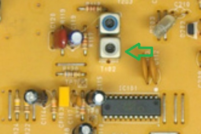

Your AT-27 is out of alignment. The quadrature detector coil T102 has drifted over the years and is no longer centered.
To fix this, you need a non-magnetic flat blade adjustment tool with approximately 1.5mm x 0.5mm tip. A bamboo chopstick that has one end shaped will work.
Tune to a strong FM station and slowly adjust T102 (see attached pic with the green arrow) on either direction until the station is no longer muted. You don't need to turn the ferrite core that far, only a few degrees. Note the old position with a marker so you can return it to the old setting if this doesn't work.
There is another adjustment for the FM "TUNED" sensitivity SR101 10k. Tweak this trimmer resistor if the above step didn't work. Same procedure, mark the old setting with a permanent marker first so you can revert to the old setting.
Good luck!

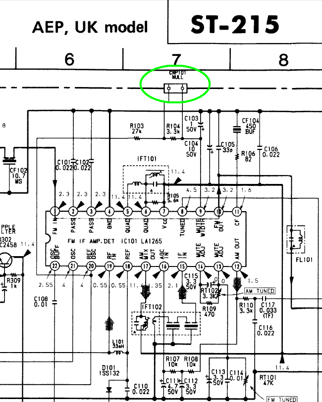

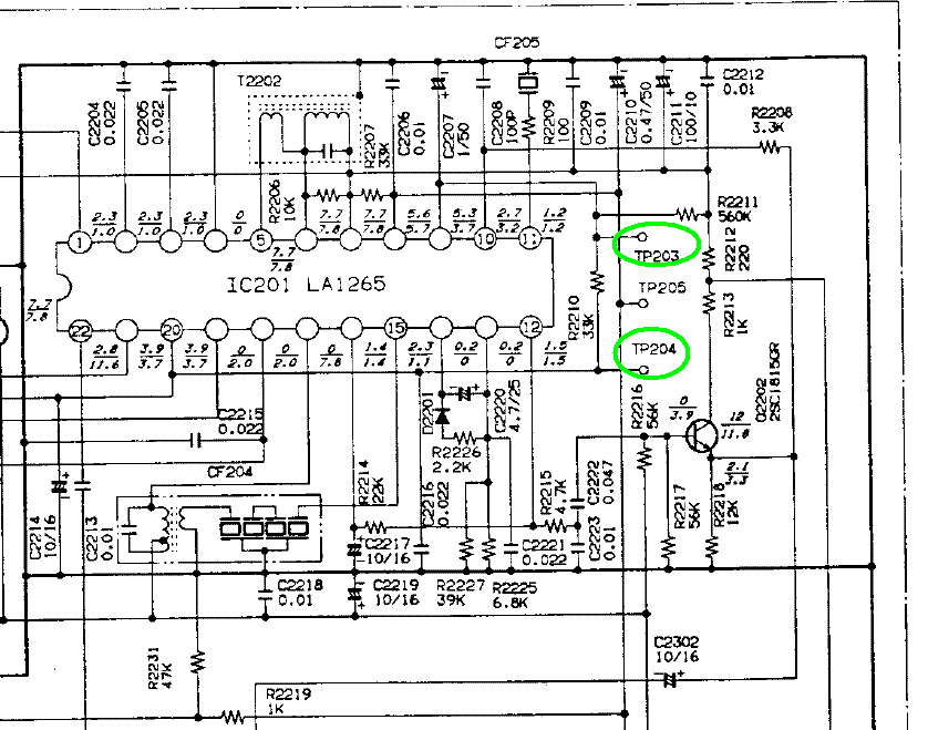

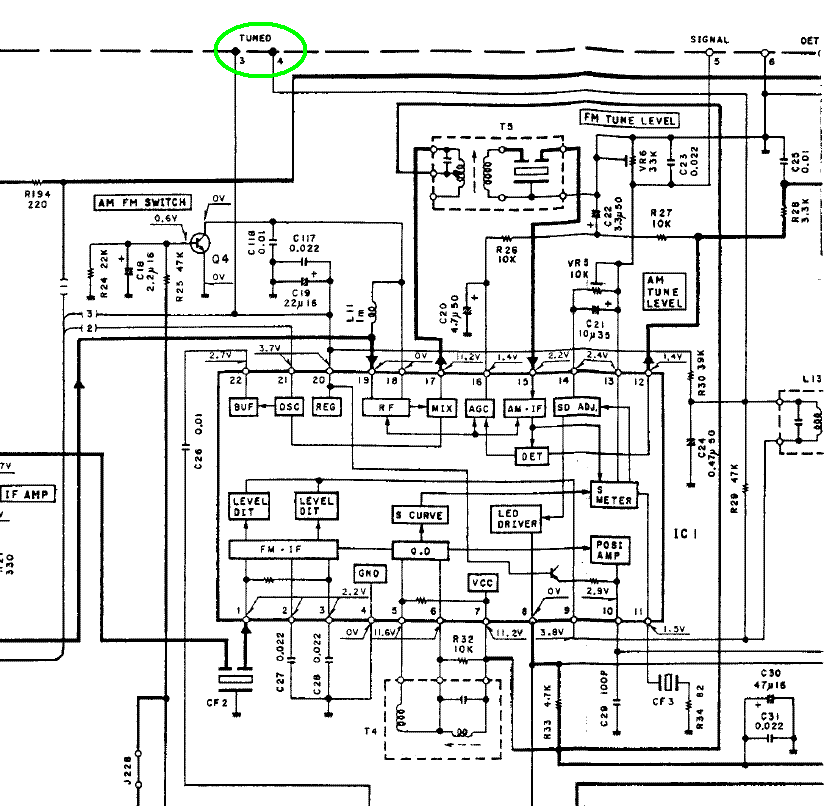

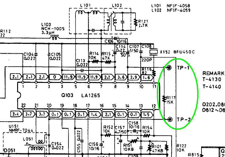

I did mention that T102 requires "few" degrees of adjustment. It is quite sensitive but don't despair. Here are schematics of tuners that use the same discriminator IC LA1265 as your AT-27L. These schematics were taken from the following: Sony FH-215, Onkyo T-4130/T-4140, Sanyo DC D30 and Kenwood T-7X/T-7LX.
You need to figure out where the "NULL" testpoints are on your AT-27 by tracing the connection between pin 9 and 20. The internal picture of the AT-27L from the internet lacks detail. There are at lest 2 testpoints around IC101. You need a digital voltmeter for this and a very strong FM station.
Assuming I'll find the testpoints, what's the callibration procedure?

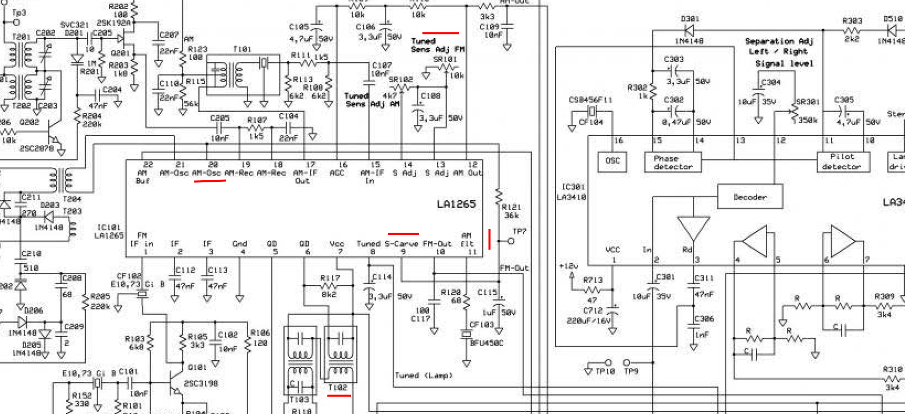

BTW, I found partial schematics of the AT-27L on the net.
I marked on the attached sheet the relevant parts (T102, SR101, pin 9 and pin 20). Also uploaded all the schematics I've found. There's a testpoint TP7 connected to pin 9, and there's a resistor R121 between pin 9 and pin 20 as with, e.g. Onkyo T-4130/T-4140, but there's no testpoint at pin 20 (analog of TP-2 in Onkyo T-4130/T-4140).
So, where do I measure the NULL voltage?

Measure the null across R121 36k.
Success!
Opened the AT-27L today:
1.There's a testpoint TP8 not in the schematics on the other side of R121, so measuring was simple.
2.The discriminator was WAY off (about 4V). After tuning T102 it's imperceptibly (with my DVM) close to 0V and stereo detection is back.
3.I played a little bit with SR102, but there was no major change.
