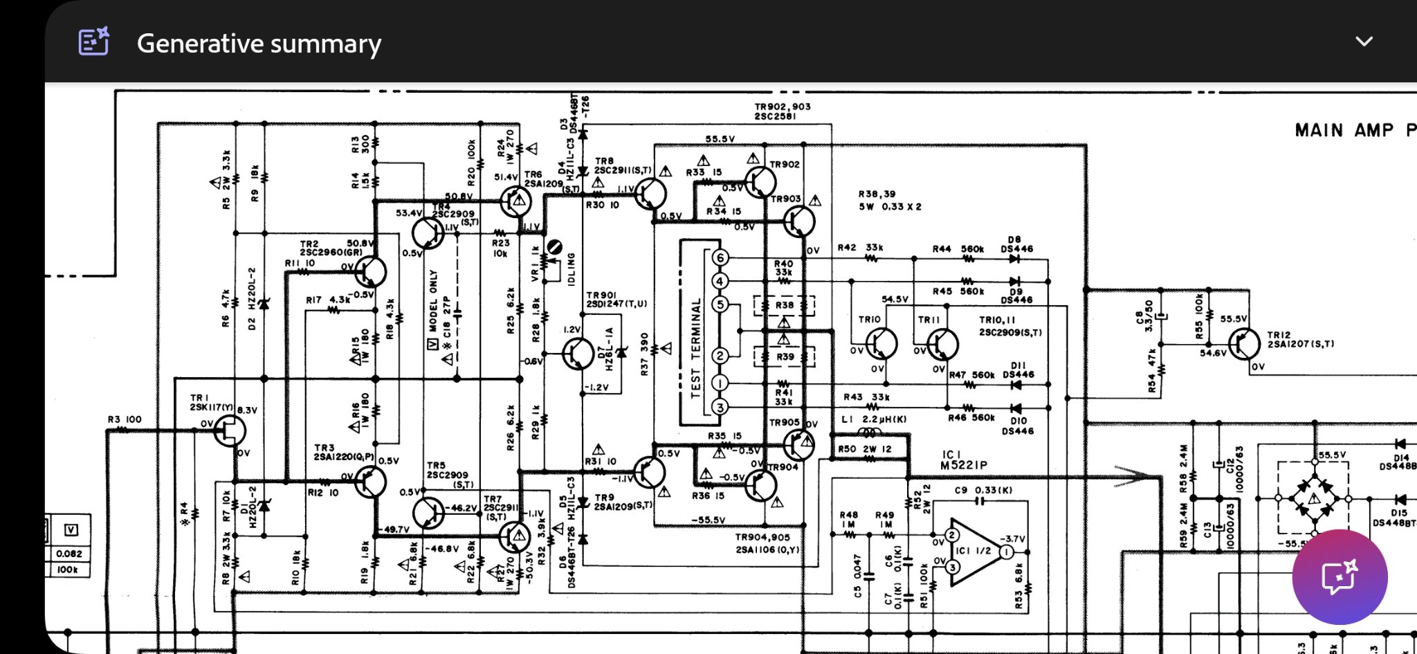

I'm looking at fixing my Akai Am-A70, problem is the relay keeps going on on off randomly,
Power supply voltages seem to line up with the schematic
+/- 54vdc
+/- 16vdc
+ 12vdc
Offset at emitters on one channel under 10mv the other 100mv, no adjustments that I can see
Where to start from here?
