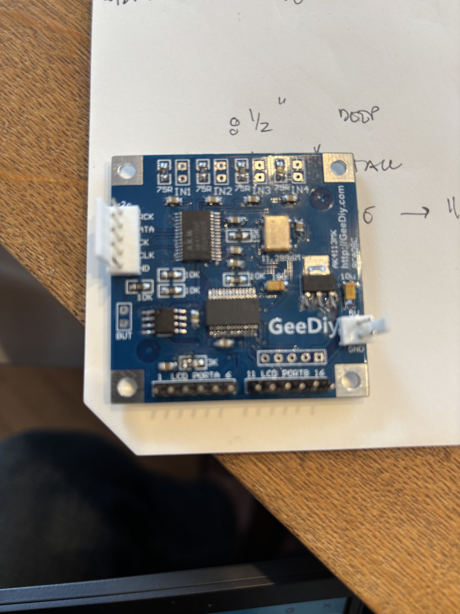

To connect coax RCA to the board, is the square top IN1 via GND or positive?

Are asking if the square pad is GND?
If so, it is and it can be determined by the thermal reliefs i.e. the crosses that connects the pad to the ground plane. Its there to be able to solder the pad as if there where no "cross", one would her a very hard time heating the pad as the ground plane would be one large heat sink.

- is IN1 a square top - this is what you might be saying...
- do one reach IN1 (whatever that would be...) via GND or positive (pad?)
- is the IN1 via, a GND or a positive... could be another interpretation....
A bit blurry... But I think you want a coaxial output? The only outputs are next to the I2S inputs at the bottom..

Is it for a coaxial input or output..?

If the question is whether the square pad of IN1 is connected to ground or to the supply, that should be easy to measure with a multimeter, if it is not possible to see it.
