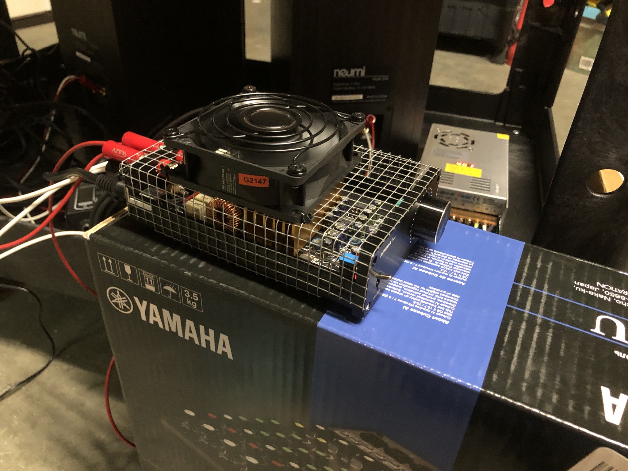

Got my A07 last week ...connected it to a Yamaha MG10 mixer (using xlr to rca adapters) to the amp then to some Neumi BS5 speakers ... seemed to work great.
My wife is using it as a practice unit for a chorus she directs.
Now after a week, I notice when my level meters on the mixer go to 0 (when talking into a microphone), the amplifier cuts out (meters are -20 to +20)!
It will sometimes come back ... sometimes I need to power it down then turn it back on.
I have the amazon version that came with 32 v 5A power supply.
I have the volume about 3/4 up.
Do I have a bad amp?
I am not an electronics guy (just know enough to be dangerous) ... my assumption was that if I played the amp at high volumes for long periods, it could over heat and shut down but I didn't think overloading the inputs (I don't think I am ... the meters say I am not) would cause it to shut down.
Seems to be getting worse.
Any idea what is happening and why?

If possible activate the high pass filter on the microphone input (subsonic filter). I suspect too much low frequency power being generated by the mic input. We must not forget that it remains a living room amplifier, not suitable in my opinion for the sound system.

A microphone will easily reproduce low frequencies at the subsonic level which saturates the amplifier. Just touching the microphone with these fingers causes these bass peaks, hence the interest of activating the subsonic filter on the microphone input. The A07 can push around 58w per channel based on Amir's measurements. Changing the PSU to a higher voltage will not provide more power and this is due to poor ventilation and a somewhat small heatsink. An IRS2092 based amplifier would have been a much better choice than the 07, I understand the budget issue.
Yes, has to be infrasonics or some other problem. The +4dBu level of the mixer and 21.5dB gain of the amp should put the output power well below 58W into his 6Ω speakers.A microphone will easily reproduce low frequencies at the subsonic level which saturates the amplifier. Just touching the microphone with these fingers causes these bass peaks, hence the interest of activating the subsonic filter on the microphone input. The A07 can push around 58w per channel based on Amir's measurements. Changing the PSU to a higher voltage will not provide more power and this is due to poor ventilation and a somewhat small heatsink. An IRS2092 based amplifier would have been a much better choice than the 07, I understand the budget issue.

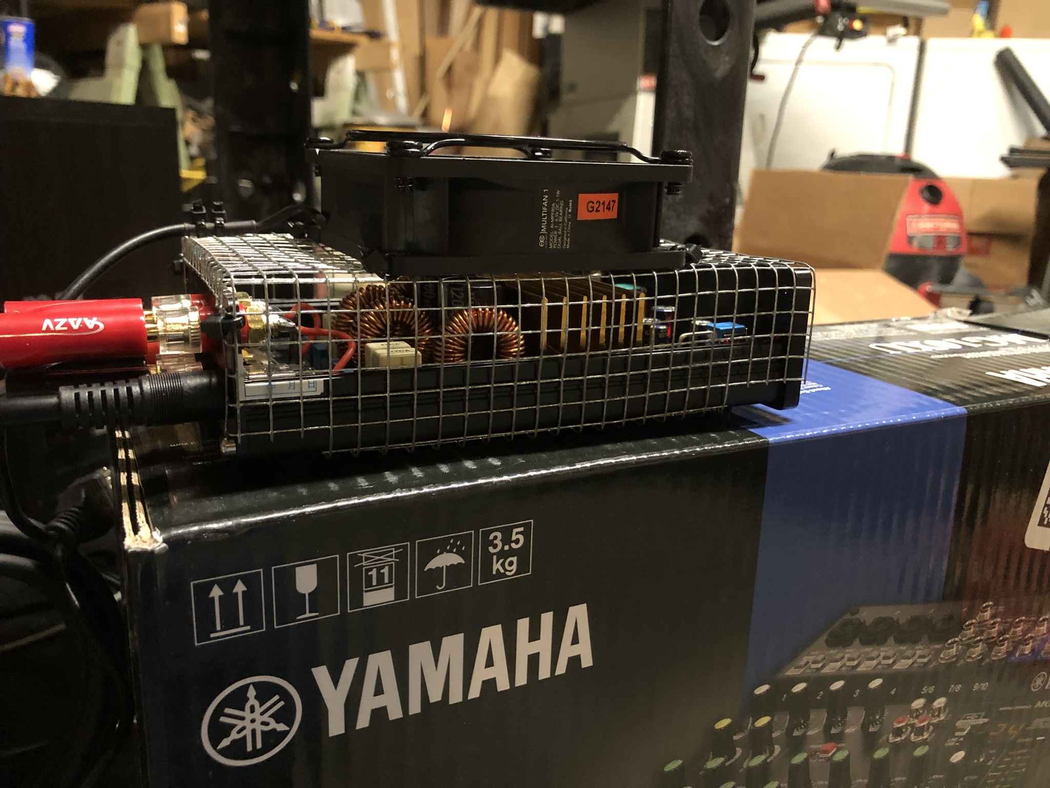

Just an update ...
With the stock 32 v power supply, I kept having the amplifier shut down when the input reached a certain level. I figured it had to be either a protection on the input or on the output. The meters on the mixer were no where near the red.
I got a 0-48 volt supply (10A ... $35 on Amazon).
I set it to 40 volts ... no more shut down!
I "guess" is the caps (or ??) simply ran out of power and drew it down to a level that shut down the amp for a few seconds till it sensed the voltage was above some minimum.
I may even try a bit lower voltage ... my speakers are only rated at 100W ... right now I just leave the amp about 3/4 volume.
I was still worried about the heat.
I got a small USB powered fan ... bent some 1/4 inch welded wire into a cover and put the fan on that.
Seems to work great!
Also, the mixer was a balanced (XLR) output. I used a Pyle PDC22 in reverse of what most people do (balanced to unbalanced) to match the input / output.

Have you added the US powered fan? How and where? On the top or on the side?To this end, I bought a small USB powered fan. about 4" square ... very quite.
I am planning to pull off the cover and drill a bunch of holes in it, then mount the fan on top.
