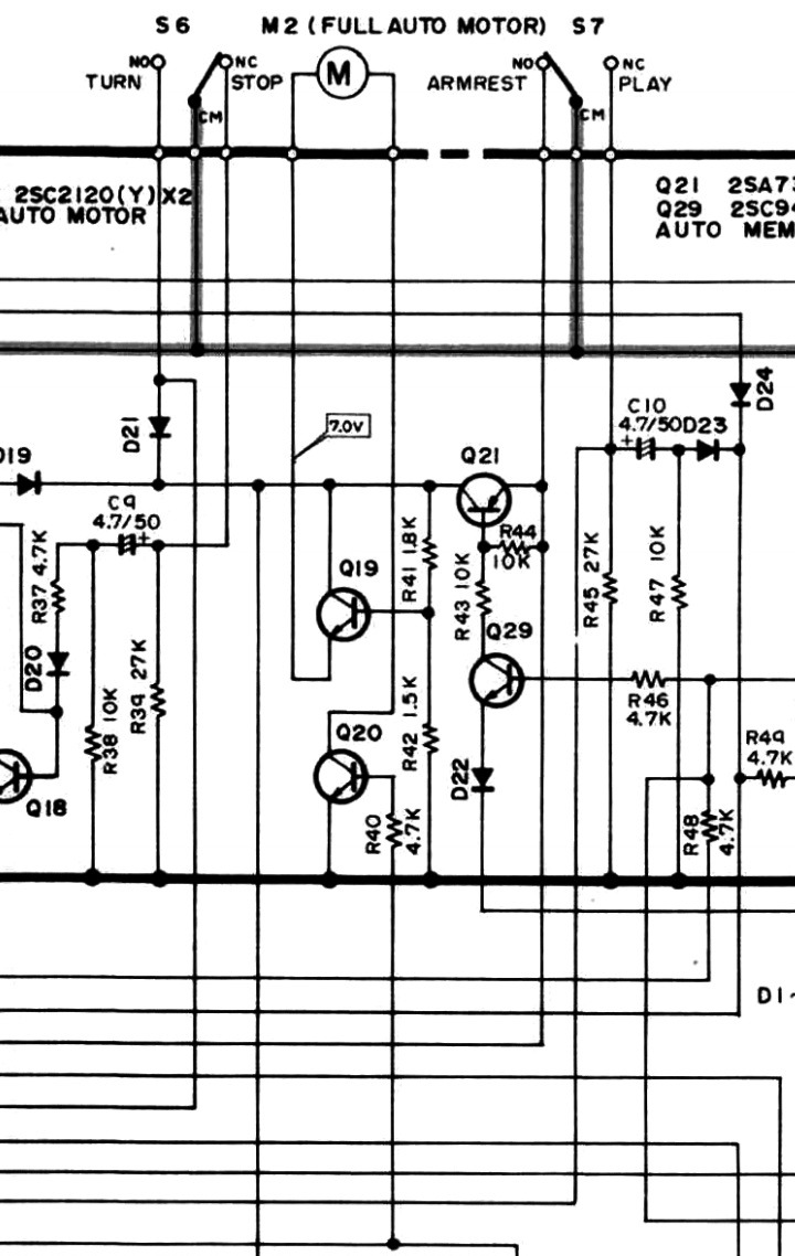

I've restored an Aiwa AP-D50 turntable and have even sourced a replacement end sensor. Everything runs perfectly (the usual fault of the tray not ejecting unless pulled) but one very annoying fault that I haven't been able to fix is that the tonearm lifts and returns to the rest. Sometimes as soon as the stylus drops sometimes towards the end of the last track, sometimes halfway through the first track. Occasionally it will play through without happening. I've studied the manual and schematics. Can anyone offer advice?
Could S3 the load play/cut switch be ghost triggering? I've cleaned it with deoxit. If I turn the switch to manual the fault still occurs. I've spent a long time on this restoration and this final fault is driving me crazy.

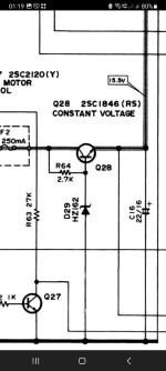

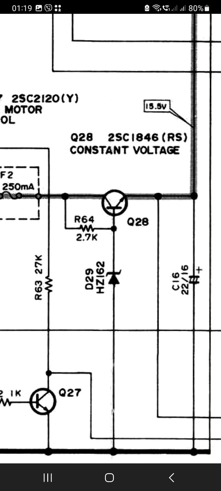

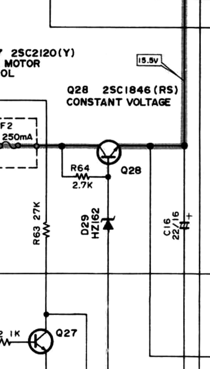

I'm wondering if D29 could be somehow the cause.
So when the fault happens you can hear the motor start to turn and the usual whirring sounds, just the same as if S3 were pressed.
