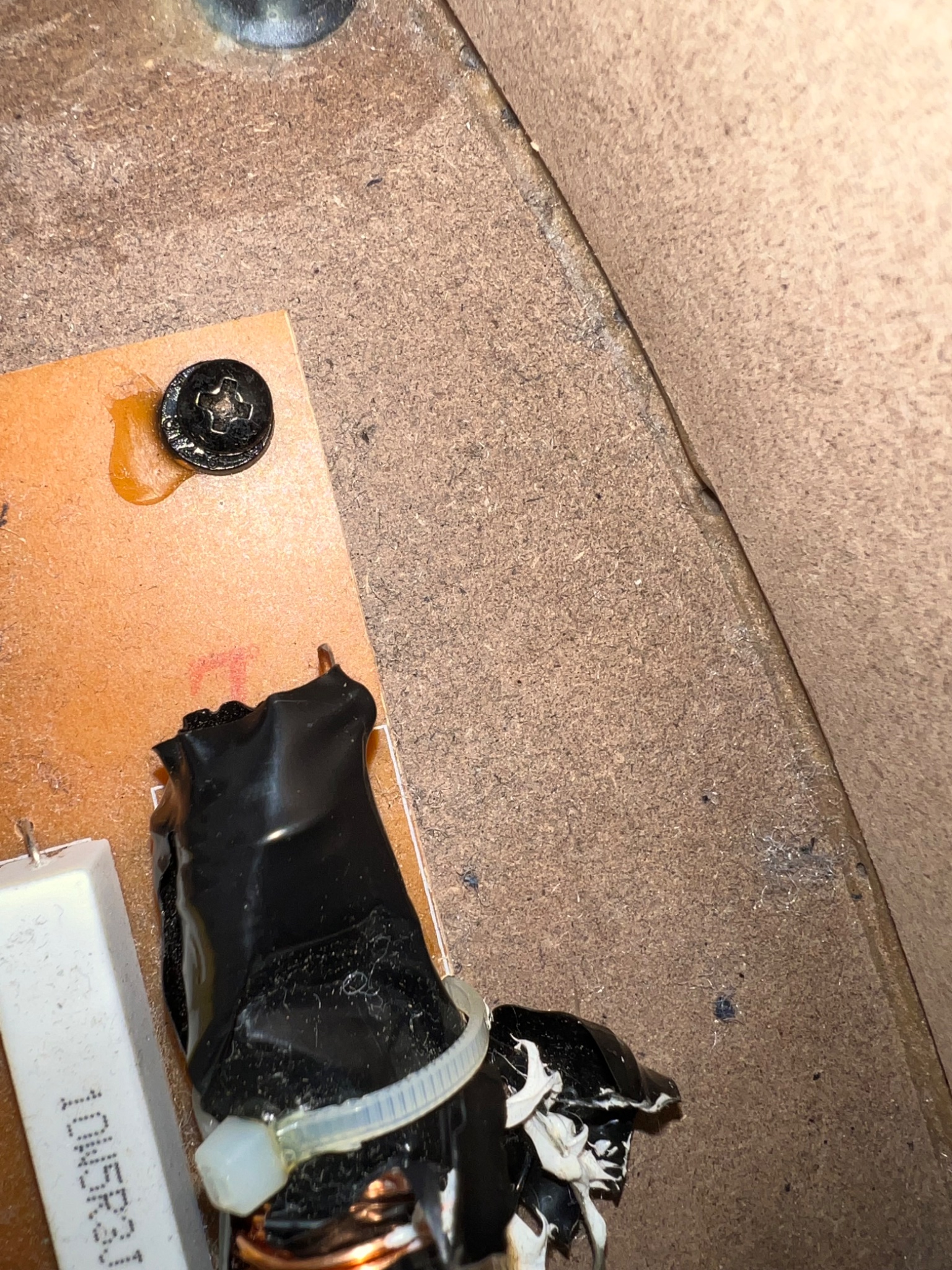

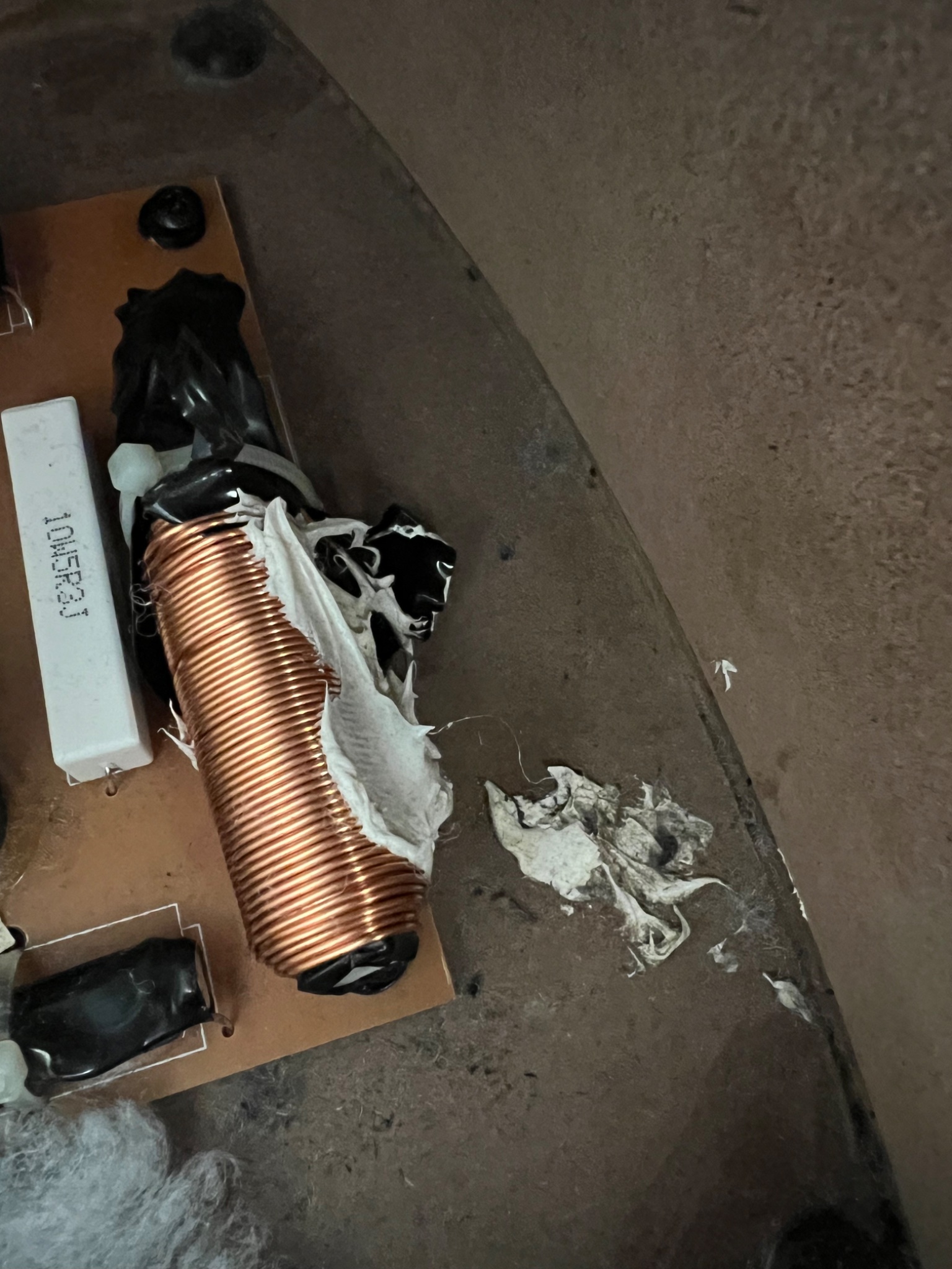

The air inductor in my speaker unraveled. Looks like it came out of the plastic cover and was glued to the bottom of the speaker.
Any ideas what happened?
Any suggestions on fixing this?

It would appear that one or both ends of the inductor coil have become detached from the crossover board.
I suggest you remove the plastic tie and the black plastic wrapping in order to locate the soldering points to which you may reconnect the ends of the air coil.
Comparing the board with the one in the other speaker of the stereo pair may help.
Reactions: Luvchampagne
If some of the wire has unravelled from the coil former, simply wind it back on. There should be no need to replace the inductor.
Even if the wire which is coiled round the former is slightly shortened by having to remount the inductor this will have an insignificant effect on the inductor value.

As to why the inductor became dislodged, such events are usually the result of a speaker having been dropped onto a hard surface.
I would certainly inspect the other speaker of the stereo pair in order to check the condition of its air inductor.
My first blush response was "Sproing!"...
Others have given you good advice as to what to do and how. I bet that is a rod-core, either steel or ferrite, due to shape alone. The glue, wrap, and tie were for keeping the windings adhered and for mounting. Electrical tape works, but at these voltages so does duct tape which can also take the heat.

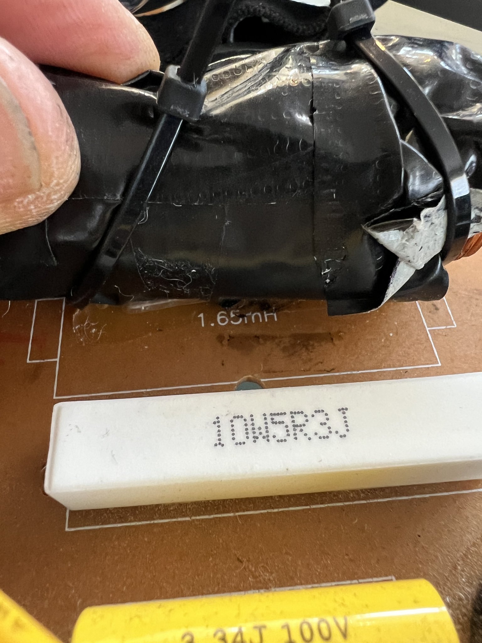

P.S. Did you find out that your damaged inductor is 1.65 mH by googling?
P.P.S. If you did substitute an air core you would have to match up the series resistance with that of the ferrite core.
Ok. Not going to do that. It is a Revel M16 so not that expensive.
Got the 1.65mh off the circuit board. See photo above.

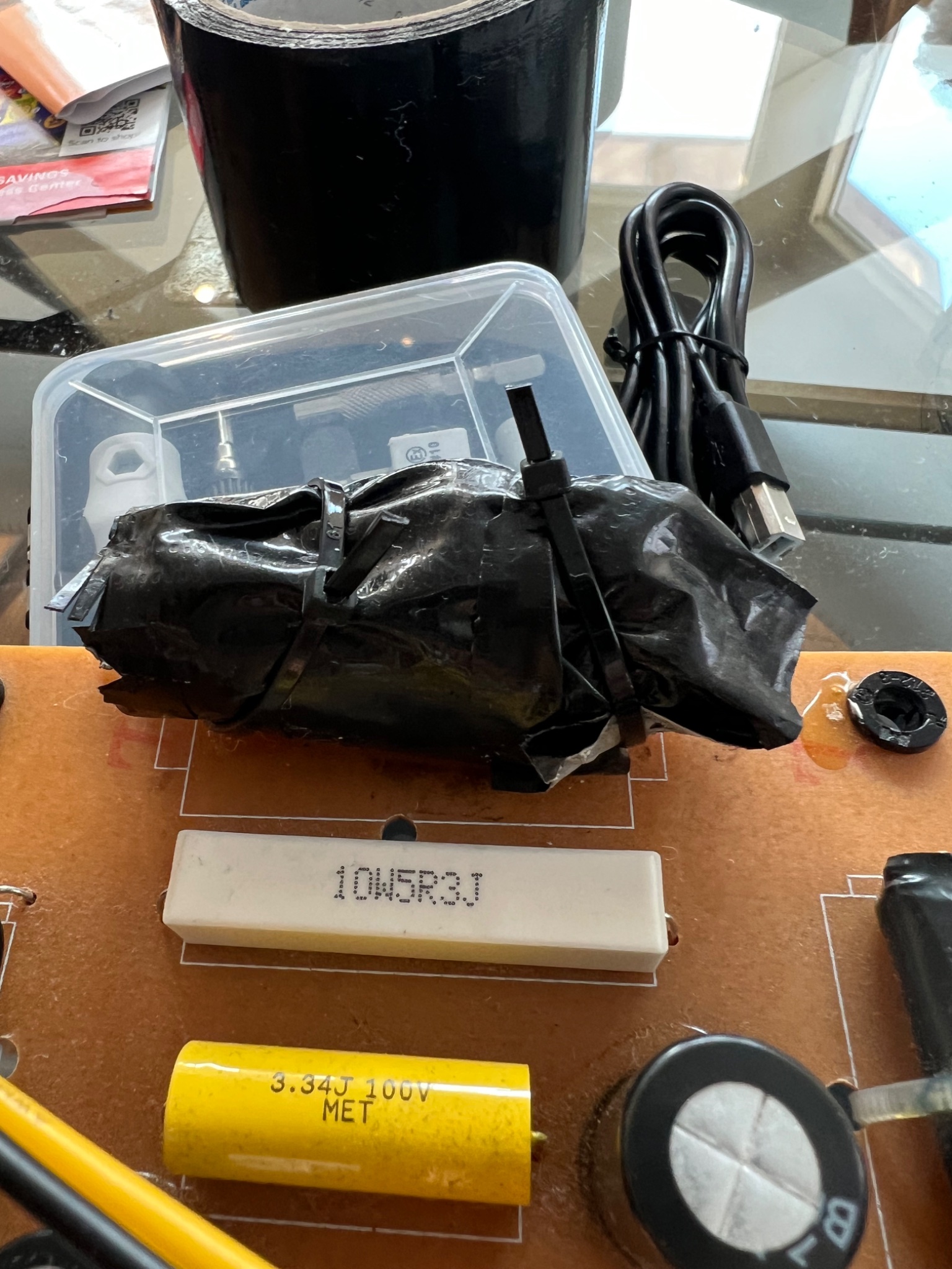

Not very pretty job of fixing. Wrapped it with duct tape and zip tied it. Looks like an ugly burrito.

As noted by @Galu the dc resistance of a replacement should match the original. If you introduce more dc resistance, it will likely attenuate the bass response (assuming it is in line with the woofer in the circuit).
For example, a 1.65 mH ferrite core inductor like that may have a dc resistance of around 0.10 or 0.30 ohms (even with 18 or 20 ga wire).
A 1.65 mH air core inductor would probably need to be made from 12 or 14 ga wire to have only 0.10 or 0.30 ohms.
In addition to the larger size, the cost would be much greater.
Based on your pictures, I'd be inclined to fix it and re-secure it as others have noted.
