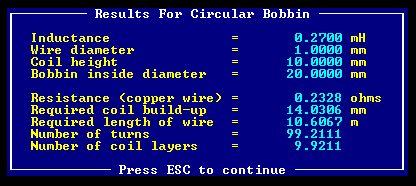

Inductors need to be at right angles to each other to minimize crosstalk. IMO, physical position will have way more effect than inductor construction. The two things you'd think about with construction are DCR and self-resonant frequency due to internal capacitance. DCR isn't hard to calculate, but I don't know of formulas for capacitance. Usually it's high enough not to worry about, at least for normal inductors with round wire.
Wheeler's formula and similar, show minimum DCR when the section shape of the winding is ~square and that the OD of the square is roughly 4times the width and 4times the height of the square.
eg.
choose a core/bobbin diameter of 20mm.
Wind on 10 Layers of 10 Turns in each layer using 1mm diameter wire.
The 10 Turns makes the coil width ~10mm, the 10 Layers makes the coil height ~10mm and the overall diameter is ~40mm.
You will find that these proportions are very close to the theoretical best "shape" for the lowest DCR of an air cored inductor. These 100T will give ~0.27mH and ~0r22
Using the same bobbin and increasing the wire to 1.2mm diameter gives ~0.12mH and 0r1 using ~67T, 8layers with 8 to 8.5T per Layer.

Here's the inductor calculator results for Andrew's first example.
