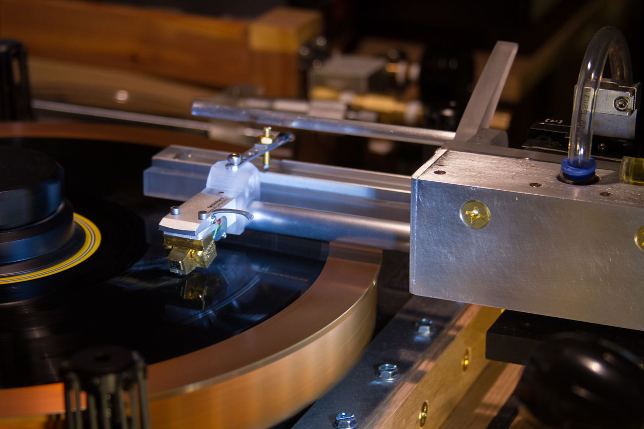

I built my 1st air bearing arm and love it so much that I decided to build 2nd one. The construction of 2nd arm is similar to Walker Audio’s. Please see attached image.
First air bearing arm link.
http://www.diyaudio.com/forums/analogue-source/268614-diy-air-bearing-linear-arm.html
Although I still have a technical problem, I managed to play it. The sound from 2nd one is even better than 1st one. It is free of artifacts. The sound is so smooth and full 3D with the authority in bass. It even changes my impressions of some of my cartridges.
However, I still have a problem to solve.

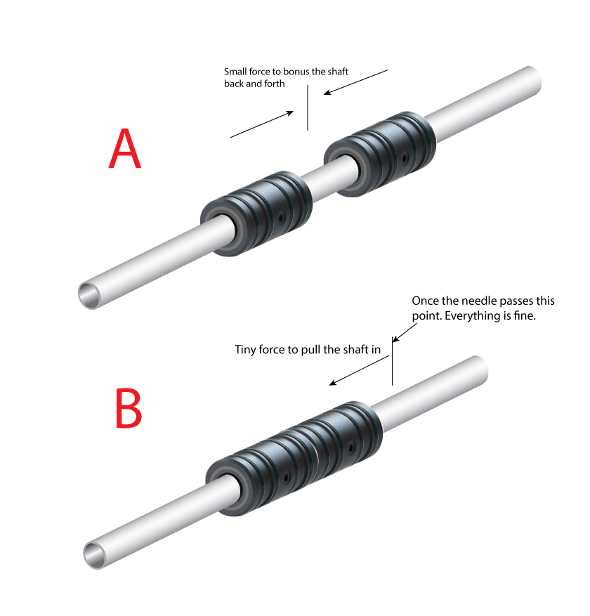

I use two .5 inch Oav air bushings. The shaft is 11 inches long 2024 aerospace aluminum tubing. It weighs 30 grams.
The first construction I did is A in the attached image. But it bonus back and forth. I attached a video to show you that.
YouTube Video.
https://youtu.be/pEWht49wbT4
So, I tried the construction B. In construction B, I can play but there is still a tiny force to pull the shaft inwards at most outer groove. Once the needle passes certain point, there is a tiny force to push the shaft out. I had to raise the rear end of the arm a little higher to compensate the pushing force.
I have no idea what causes this. The shaft is pretty straight. Its tolerance in roundness and diameter is about .05 mm.If anyone had built similar kind of tonearm or you have the experience with air bushings, I need your advice how to solve this problem. Otherwise, I have to be very careful when I play the records. It also makes me feel uncomfortable to know there is tiny force is pulling the needle at beginning of playing.

Hello super10018
Watching the video, tells me that the shaft is not straight. It also rotates on its longitudinal axis as it oscillates back and forth. .05mm (.002") is not straight enough in my opinion. If the shaft is curved, it would act like a pendulum if set into motion. I would do the following:
Substitute a precision shaft of known straightness to see if it oscillates.
Take your existing tubular shaft and roll it on a clean granite surface plate to see how it behaves. Find a friendly neighborhood machine shop with a surface plate. High quality air bearings, being essentially frictionless, demand a precision shaft. If you visit the web page of the company that made your bearings, you should be able to find out what straightness and roundness tolerances they require.
There is one more possibility I just thought of:
Try rotating the tubular shaft in increments of, let's say 10 degrees, until you find a position where it won't oscillate. Good luck.

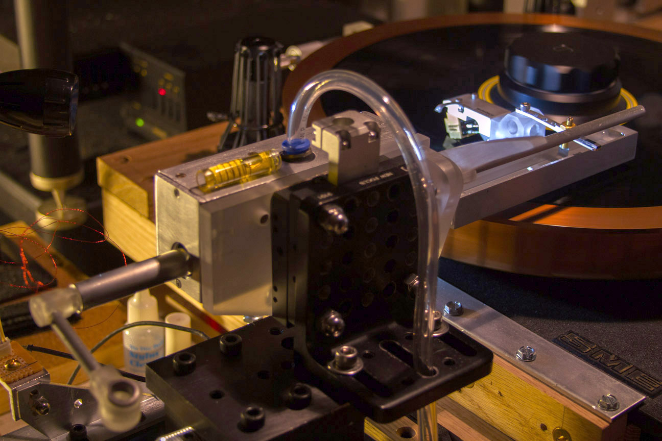

On my 2nd arm, I also add a silicone oil trough for damping. The oil I use is a mixture of 20 wt and 30 wt. and the paddle is just half sunk in the oil. So, the damping is very light. Although the damping is very light, it is needed for certain cartridges and LPs.
For 2nd air bearing arm, my small fridge compressor can’t keep up. I have to order a more powerful compressor. So, if anyone wants to do an air bearing arm which is similar to the construction of my 2nd arm. You should start with a more powerful compressor. I ordered a 1/3 hp fridge compressor.

The problem has been solved.
First, I left a 2mm gap between the air bearings and then, flipped air bearings. I tried a couple of times. It worked. The shaft stays still wherever I move it to.
I guess the gap changes the distribution of air pressure. Flipping the air bearings may make the air bearing to fit the shaft better. And, the air bearings were not lined up properly. I still don’t know what happened exactly but it works now. The arm is very stable.
