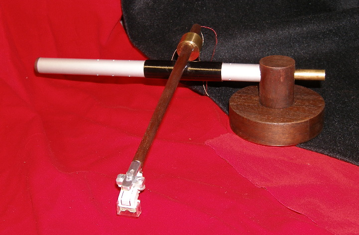

Having gotten my Schroeder clone working real well I had to do something with some stuff left over from that project. Hence a linear tracker with air bearing. I built the start of a Ladegaard but ran into some problems getting the traveler to fly. It didn't even budge with fish tank pumps but did with a Binks airbrush pump. Then I saw reference to a tripod leg which set off a new train of experimentation. In my junk box are several legs from an old Davidson tripod. The bottom extension measures 5/8" diameter and is nicely finished with grey anodizing. Then one day at the local ACE hardware store I happened on plumbing part, a 12" length of full slip repair coupling (copper) which slid over the tripod leg ever so smoothly. Cut a 12" length of tripod leg and a 4" length of coupling tube. Made a row of air holes spaced about 3/4" apart and lined the tube with a strip of adhesive backed copper foil that stained glass workers use. Next I punched 0.012" holes in the foil strip. Put the whole thing together, closed off one end with my palm and pressurized it with my good old lungs. Well let me tell you that traveler flew from one end to the other and back. Next I built up a first try at an actual arm based on the first experiment. The big difference was to use 3 rows of air holes spaced 120 degrees apart to equalize the air flow around the pipe. Then to run a length of air hose up from the cellar to the living room and set the prototype arm on the turntable. With no careful setup it played a half dozen records without a hitch and no tracking errors or distortion. The crude experiment has been gussied up a bit and I'm going to do some serious listening and more reporting to the forum on how it performs. Given some luck I'll attach a picture of the gussied up model. Let me know what you all think of it please.
Bill G.
