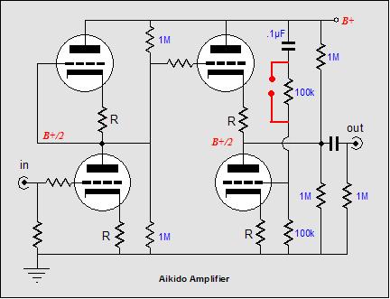

Hi Elkaid
If I undersood well you plan to use 200VDC for the B+. If yes... In an Aikido that implies in 100VDC (half the B+) across each tube. If you go for a B+ of 300VDC you will have 150VDC across each tube, a voltage that is better suited for the 6SN7. The 6AS7 is rated for V Anode max 250VDC, so you can safely run it with B+ of 300VDC, as there will be 150VDC across the tube.
Note that the 6AS7 will draw much more current than a 6SN7. Using CRC filters will make the voltage drop in the power supply increase, resulting in a different working point for the first 6SN7. It will work, but it will be different.

Hi Elkaid
The voltage divider Bas refers to is only passing AC noise present at the power supply. See that it 'starts' with a cap, which blocks DC, but allows flow of any AC. This AC (the B+ noise) is than reduced thorugh the voltage divider...and fed to the grid of the triode.
You can make a voltage divider that is ideal for the 6SN7, and place a jumper or swith across the upper resistor. With jumper/ switch closed the circuit works for the 6AS7, with it open it works for the 6SN7. Should not be much of a hassle, as you can change the setting while you are changing the tube 😀
Hope this helps
Erik

Are you planning to use the 6AS7 as input and output or what?
Your switch bypassing R15 should do the job there. I haven't done the math yet but I don't think your cathode resistor values are going to keep in the proper operating point for a 6SN7.
What about the difference in current draw between the 6SN7 and 6AS7? Don't you need about 50mA for the 6AS7 and 5-8 for the 6SN7? How are you going to change the B+?

The (extra) voltage drop in the PS when using the 6AS7 will be the extra current drawn multiplied by the resistance in the PS (V=I*R).
As you mention, a choke would reduce the drop, as its DC resistance is less for the same amount of accomplished filtering. You could also use a (series) regulator, which would yield constant B+ whatever current you draw - but adds somewhat in complexity, although a Maida is simple and cheap.
Burnedfingers is right about the biasing resistors, you should check if the same value of resistor can be used to bias both the 6SN7 and the 6AS7...you couls also add a parallel resistor, which can be turned on/off with a switch, but that also adds in complexity...
Erik

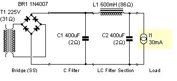

Hi !
Thanks for your replies guys.
For now, I gave up on the "dual personality" feature and decided to focus on 6SN7 only Aikido with a B+ of 300VDC.
Right now, I've got a Hammond 269GX transformer (225-0-225, 65mA) that I would like to use. Is 65mA enough for the 6SN7 Aikido ? The only datasheet that I've found is in German and I'm not too sure whether I should look for cahode or anode current or any other parameter when estimating PS requirements.
Well, assuming that I could use my 269GX transformer, I came up with the following schematic. Your comments would be very appreciated.
Thanks and have a nice day !

If you want to simulate the power supply, it's best to estimate the current draw for your preamp and plug that in to PSUD as a current source. It'll give you a more accurate picture. When you get your transformer, you can actually measure the unloaded voltage, and the primary and secondary resistances. If you enter that into the transformer data, and you have the series resistance of your choke, you will get very close to the real values.
You can estimate the current through the tube by looking at the data sheets for the plate curves. Pick the current you want and the plate voltage (remember it will be half the B+, as you have on section stacked on the other), and from the curves, estimate the negative grid voltage at that point. Don't worry if you have to extrapolate between grid voltages. It not going to be exact anyway. Then pick your cathode resistor to give that voltage drop at your chosen current.
BTW, the plate current and cathode current will be the same in these applications, as you will have no significant grid current.
Sheldon
Edit: This table will give you some typical values: http://www.tubecad.com/2006/05/blog0064.htm

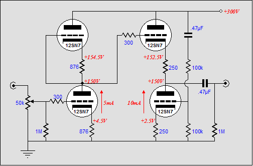

I read in Mr. Broskie's doc that he recommends to drive the output tubes "hotter" than input tubes. Your schematic seems to confirm that (5mA for input tube vs 10mA for output tubes).
Sorry to get down to the basics but... Since 6SN7 is a dual triode, is the 5mA and 10mA values are rated for the 6SN7 tube or for ½6SN7 ?
Ultimately, when calculating power requirements, should I add current values this way :
(5mA * 2 6SN7 Input Tubes) + (10mA * 2 6SN7 Output Tubes)
or that way :
(5mA * 4 ½6SN7 Input Tubes) + (10mA * 4 ½6SN7 Output Tubes) ?
Thank you very much !

For looking at operating points, plate curves, etc., you treat each triode as if it were a separate entity. Of course, stacked triodes must see the same current, whether single triodes or both in the same tube. The current through each stacked section is the same as for the whole tube, since they are connected in series. The current rating for the 6SN7 is about 20Ma, (each or both sections, no matter).
However, since the two triodes are in the same envelope in this case, you have make sure that their combined dissipation doesn't exceed the max. rating for the tube as a whole. The 6SN7 is rated at 5 watts for a section, but because you have two sections in the same tube they cannot both be run to the max at the same time. The total combined power cannot exceed 7.5 watts, or the tube will overheat.
In your example, a preamp with 5Ma in the first position and 10Ma in the second, would have a current draw of 15Ma/channel or 30Ma total.
I think the suggestion for running the second position "hotter" is only indirectly related to heat. The main point is to run a generous amount of current in the second position. The extra current helps to drive any capacitance in the following path and it means a smaller cathode resistor, which gives a lower Z-out.
Sheldon

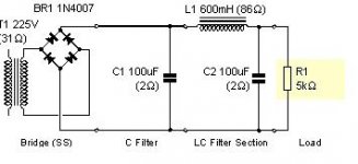

Thank you very much, I'm beginning to understand a little more of what's going on in those tubes 😉
Also, according to your suggestion Sheldon, I modified my PS simulation a little and added current.
With the following schematic, I get around 306VDC with 5mV ripple.
I suppose it shouldn't be that bad. Or is there a simple way to flatten ripple even more ?

I think that level of ripple would be fine. Remember, one of the big virtues of the Aikido is excellent power supply ripple rejection - PSRR.
But, even if you stay with that, by all means play with PSUD. It costs nothing but your time and you can get a feel for what the relative magnitude of effectiveness for various changes will be. Try adding an RC section, for instance - say a 500R resistor and a 100uf cap, or? Play a little.
