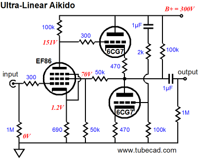

Sure I'll leave the Aikido with 4P1L alone. But I am curious how come no one use EF86 in triode Aikido??

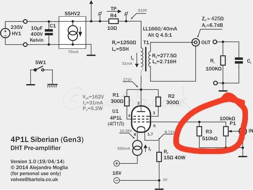

BTW, the Bartola Siberian I'd under consideration but it is quite strange (see attachment)
T
he potentiometer is show wired back to front. The wiper should go to the tube and R3. And the input should be at the top of P1

Putting EF86 into aikido circuit would need 8 tubes for the L and R channels. And since the purpose of the circuit is to cancel power supply ripple, the EF86s at the bottom would need to be curve-matched (not just current-matched) or the cancellation may be poor. The circuit in Steve's post might work better, but there are many much simpler and better ways to make a line stage than either of these.
