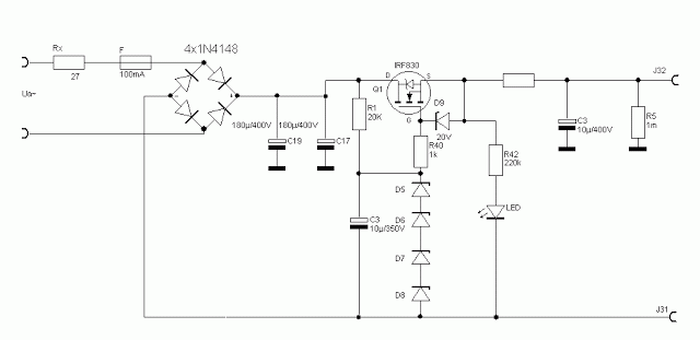

I am building Aikido preamp and I red many reviews and posts regarding the power supply which, most of project builders have used solid state designs.
I found this complete module in ebay, can anyone give any idea is this good PS for Aikido?

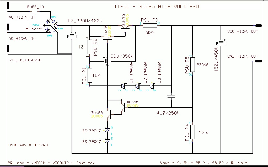

Hi Bekim!
Here schematic quality power supply for yours Aikido tube preamp!😉
Enjoy!![]()

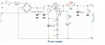

Thanks for the schematics.
This circuit looks ok, just "too" many bipolar transistors on it 😕
I am thinking to use this design for preamp, looks simple and I can purchase pcb in ebay. Anyone, do you think is ok this design, attached in my post.
thanks
1N4148 as a rectifier for Hi-Voltage ?
Don't get me wrong, Bekim, but
don't you think 1N4148 ( 75V-100V, 75 mA-200mA depending on what
database we have) are somewhat too weak for the rest of that PSU ?
Similar psu tend to use 1N4007/UF4007/SF4007 or "tougher" diodes.
Greez
Siggi

The diodes are in fact too weak ...

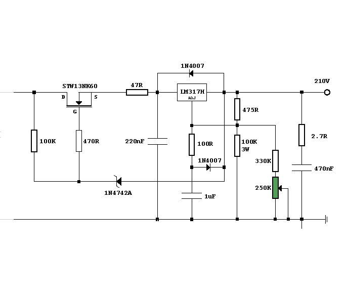

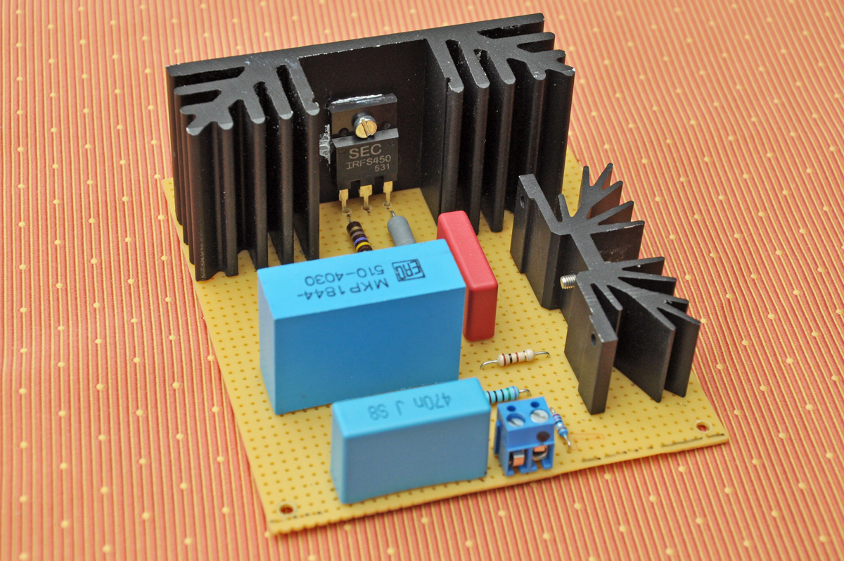

Why not use a Maida reg for the Aikido..?
This is more than up to the task, and even better, I could sell you one ready built!
I used this for my Aikido Parafeed headphone amp but later replaced it with a Salas shunt reg. When you are interested it can be yours for 20€ plus shipping. It is set for 210V out (up to 200mA at least) but can be set for other voltages. It just needs a transformer and CRC prefilter.

Thanks for reply.
Actually those 1N4148 are 1N4007, might be typo in schematics.
Here you find schematics:
https://picasaweb.google.com/vbkolsen/AikidoPreamplifier#5651504948065234066
PCB I found in ebay.de [I hope I post the link right this time] after http:// put ebay dot de
http:// Elektronik, Autos, Mode, Sammlerstücke, Gutscheine und mehr Online-Shopping | eBay /itm/Anodenspannungsversorgung-Platine-/110397932032?pt=DE_Elektronik_Computer_TV_Video_Elektronik_Verst%C3%A4rker&hash=item19b43ac200
Reason I am after mosfet is, soft start, otherwise your designs are great.

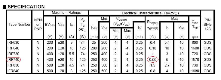

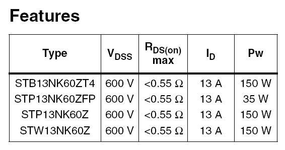

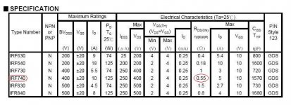

That the DC input voltage (Vin =?) should be on this circuit for the output to be get Vout = 250Vdc.
Is STW13NK60 (IRFS450) can be replaced with IRF830?
thank you!
Hi Bekim!
Enjoy!![]()
Gost22,
I am considering schema you provide.
Do you apply any heatsink to transistors? My transformers output is 200V AC, I=~100 mA, and I need output 240 - 250V DC.
Hi Stixx!
Input voltage should be about 20V higher than the desired output, so ~ 270V.
Don't know about IRF830.... the classic IRF840 would be better.

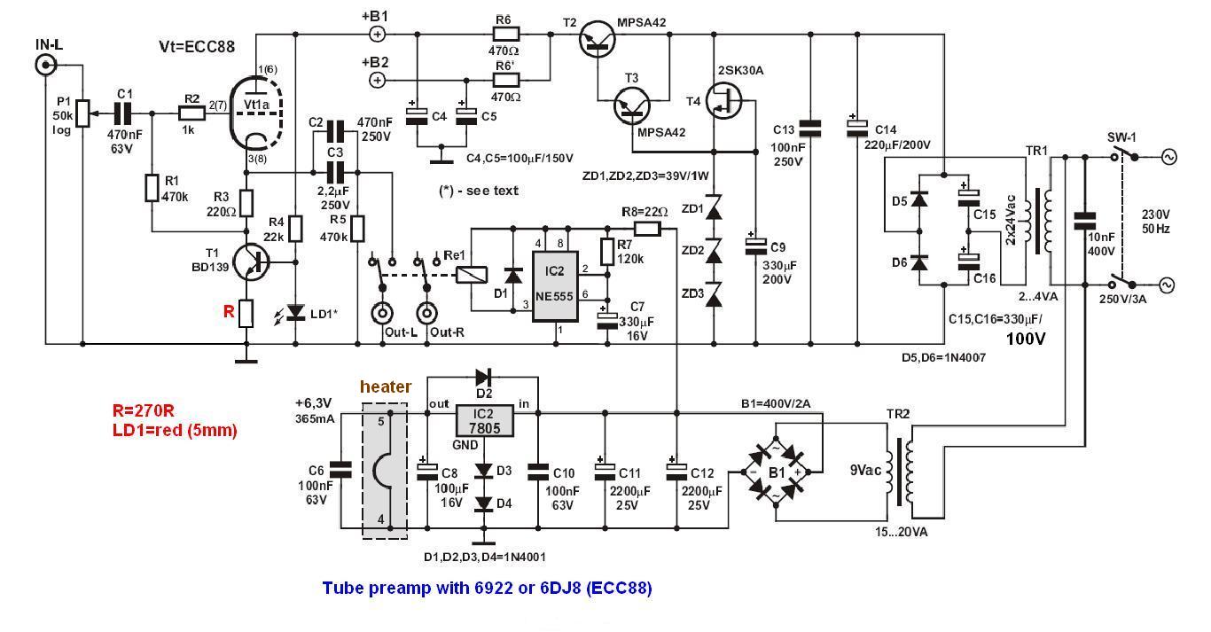

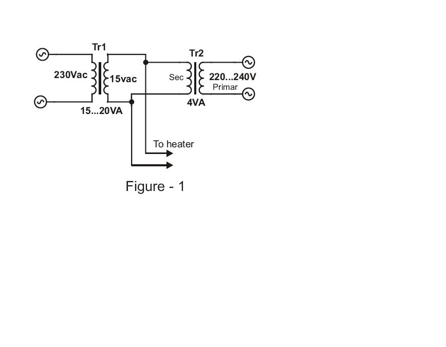

Hi Beikim!
Use 2 a transformer, Tr1 of 15 .. 20VA with second hand of 13 ... 16Vac for power supply heater tube and other transformer Tr2 of 4 ... 6VA the second hand of 12Vac. The latter connect with PRIMARAR the first secondary transformer of 15Vac, so that otherwise get around 220V.... 240Vac for voltage + B node tube. (See schematic Figure-1).
cheers!
cheers!
Hi Stixx!Input voltage should be about 20V higher than the desired output, so ~ 270V.
See table below:
thanks!
Bekim, if you want to complete a quality tube pre-amp I recommend this to with ecc88. Not very expensive for design, but provide great tube sound! 😉
Enjoy!
Cheers!

Gost22.
Thank you for schematics and information provided. Nice design and looks cool.
What I like most is timer.. ;-) I think is set 30 seconds as delay.
Great!
Great!
Bekim, if you do this tube pre-amp on this schematic, the articles are you satisfied with its tube sound?!

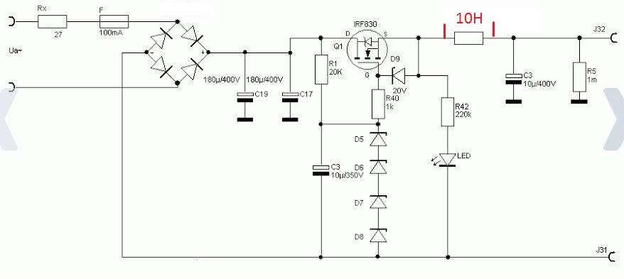

Anyone thinks is good place to put choke as marked on schematics...???
Appreciate your feedback.
The inductance of the coil (L1) can be 10 .. 20H for current> 100mAAnyone thinks is good place to put choke as marked on schematics...???
