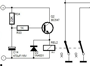

I have an Aikido / NCore setup that gets powered on and off all at once (I know I know...).
The config always had some nasty power on / power off noises...so I decided to add a preamp timer circuit that powers a simple relay to RCA outs. I have the NC of the relay floating, and the NO (timer power to close) direct to rca/amp. See attached...
Power up works great - no noises on power up...but still has a bit of a nasty pop on shutdown.
Concern #1 the preamp out of Aikido to relay is floating while powering up via timer (there is a 1M from output to ground on Aikido board)
Concern #2 the shutdown pop...I could put a 470k at RCA center pin to ground? When all "on" there is the 1M on Aikido and this 470K in parallel, so not per design
Any advice to get Concern #2 shutdown pop to stop? Concern #1 should not be problem, correct?
I worry about damaging the NCore amp modules...

You should worry.
This is best done using the NC contacts directly shorting from the outputs to ground. The muting relay must drop out immediately upon turn-off. I've done this with a reverse 1N4148 diode connected between the timing capacitor and
the timer's raw DC supply.The raw DC supply typically will drop out quickly enough if it also feeds the tube filaments,
and if the 5V timer regulator has a reverse diode across it for fast turn-off.
If it is still not fast enough, add a bleeder resistor after the diode rectifier that is small enough to discharge more quickly.
If you need even faster operation, the best possible scenario is a pair of extra contacts on the AC power switch.
Use those contacts to directly short the timing capacitor upon power turn-off. That will definitely work.
If the timing capacitor is an electrolytic, add a small series resistor in the relay contact circuit, around 100R,
to limit the short circuit current of the capacitor.

So relay isn't "fast enough" on shutdown?
BTW - This is the timer circuit I am using... https://www.ebay.com/itm/321746593997
Yes, very good. Some circuits do need a turn-on time delay as well, so that function does need a timer.
OK, did the addition, but pop still there...so tried a few different amps and all were good - no shutdown pop (or greatly reduced)...Apparently the shutoff pop is on the NCORE amp only...weird.
Also when I switch the AC on/off via switch on amp, no shut down pop on the NCores......I may have to rethink the whole Turn on / Turn off all at once when I turn on my computer (I am so lazy), or just use an amp that has no issues with the arrangement I have...

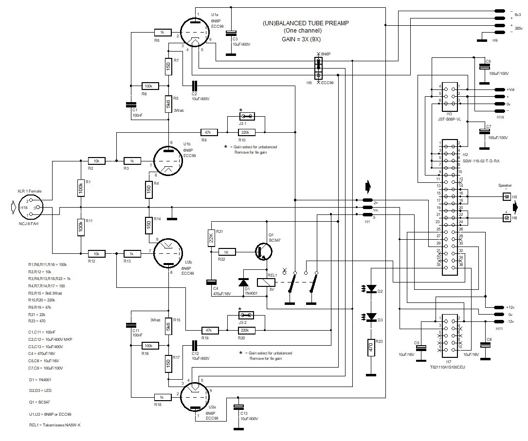

And you should use the free contact of the relay to control amp/on signal of the ncore. See my schematic.
Do not connect as in our schematic disconnecting the signal but switch signal to ground.
