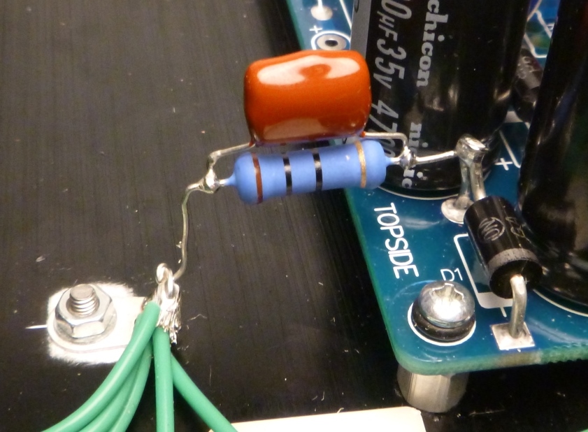

It is usually best if the circuit ground is not connected directly the chassis. I've found that a 10 ohm 2 watt resistor in parallel with a 0.01 to 0.1 film cap works well. Broskie shows a few grounding schemes in his manuals. See picture for example.
Cheers, Steve

Thank you for your advice Steve, you're very kind! The R+C connection is a good idea, I've seen it in a opamp phono preamp schematic I built some time ago. So in this kind of preamp the only connection to chassis would be through this one, right? Only for sonic purposes or will it make the circuit more safe?

The chassis should be connected to the circuit ground in some way or other for sonic reasons, shielding primarily and for safety too. As long as your power amp chassis is connected to the 3rd pin electrical ground and the electrical ground is connected to the circuit ground you should be OK. The interconnects between amp and line stage will connect the line stage to ground.
You aren't guaranteed 100% grounding of the line stage this way. You still might have too connect the line stage chassis to the 3rd pin ground (or the power amp chassis). The best way to determine this is experimentally.
