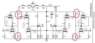

I’ve been running an Aikido 24V preamp (6GM8) but only recently came around to trying to fix an annoying channel imbalance.
Output on the scope is as per photo. I’ve changed tubes around with no meaningful effect (switching channels) but the issue doesn’t seem tube related.
B+ is 24.2V, coming from a Salas regulator (probably overkill here). I see voltages across the circuit being 0.2V lower one one channel. Checked the caps (fine), measured resistors in situ (fine), reheated solder joints, disconnected the headphone driver circuit (R19). All to no avail…
Any ideas?

As the Aikido is direct coupled, any imbalance between the triodes of the input tube can affect the balance of the triodes of the output tube and vise versa. This can possibly be mitigated by changing the "stack" resistors between the input tube and the output tube. R5 and R6 in the attached schematic. These might be different numbers on your board. These resistors are typically 1 Meg. Try changing these out to 100K. It will make a miniscule difference in current draw, but might impose some balance on dissimilar triodes. With a B+ of 24 volts you could even try ~25K resistors.
Compare voltages across R2 and R4 (should be the same) or whatever the designation is on your board. Also R8 and R11.

@rayma i went back to basics with everything suggested.
Indeed I had not measured the heaters. Over the 4 tubes I measured 6.31v, 6.17v, 6.23v, 6.24v. So quite good but swapping the highest and lowest heater voltage showed a slight improvement in balance.
Then I went back to the volume control, which is a lightspeed attenuator. This was well balanced, however accidentally turning the post led to imbalance again. So this is where the problem sits: when the lightspeed att is in balance, the aikido output is balance as well.
In other words I need to investigate tracking problems in the LA (either the alps pot or ldr mismatch)…

I misspoke earlier when I wrote: "Compare voltages across R2 and R4 (should be the same) or whatever the designation is on your board. Also R8 and R11."
Voltages across the "upper" and "lower" cathode resistors of each particular tube will always be the same because they are in series. I you want to see how well the triodes in any particular tube match measure the plate to cathode voltages. With 15% to 20% can be considered a fairly good match.
