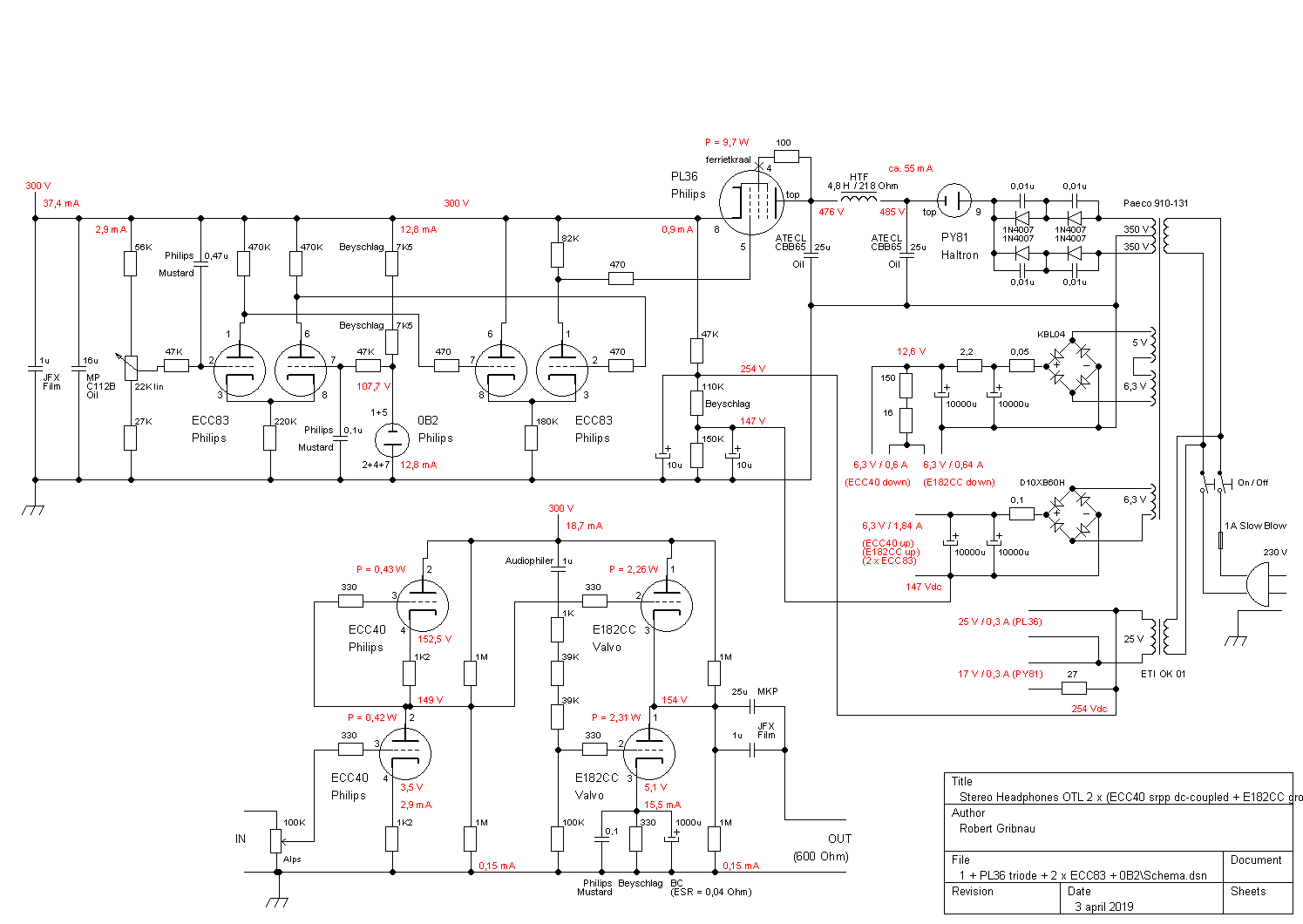

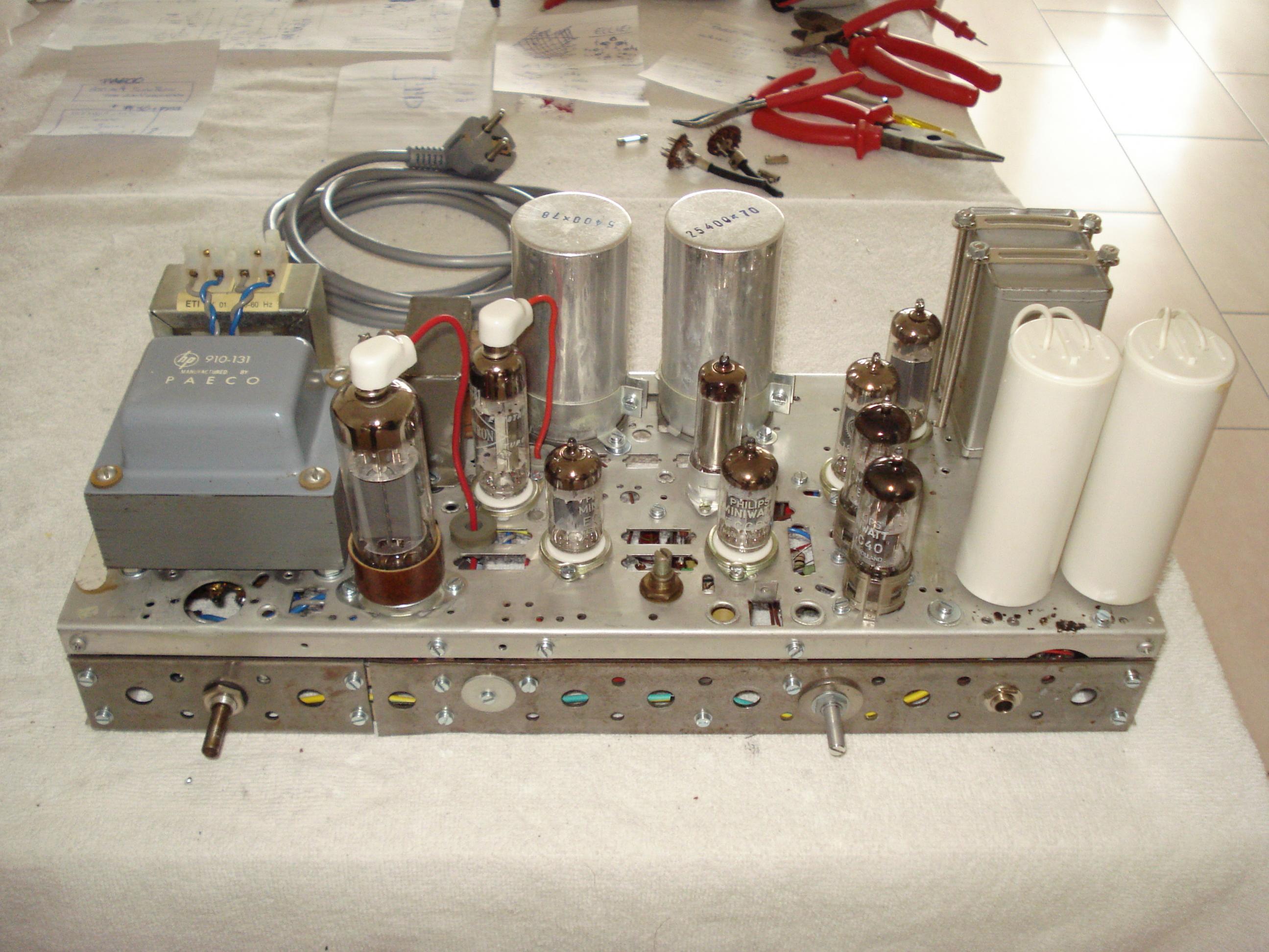

"Aikido" headphones amp with ECC40 and E182CC
Disabled Account
Joined 2009
A photo and the schematic of the headphones amp i have finished, except for the housing. More information (in Dutch...) and photos can be found in this and older postings on my site: OTL800: Headphones Amp klaar
I built it for my AKG K240 headphones (impedance = 600 Ohm).
The combination of the regulated power supply and the Aikido principle is of course over the top. But for me it is a good excuse to use many tubes and the available chassis (from a long time ago dismantled radio).
Greetings,
Robert

Yes, the PY81 is in there for slow startup (and to add to the tube count i confess). I takes the PY81 about 30 seconds to start to conduct and than it comes up slowly.
Greetings,
Robert
