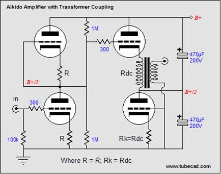

Requires an airgapped OPT, so Im not sure low end iron will beat capacitor coupling of similar cost. Consider using oil motor run capacitors for budget coupling caps as another alternative. From correspondence:

Thanks for correcting me. I was thinking of the attached schematic and thought that the capacitor was only needed for DC blocking for the High-Z output. I also thought non-airgapped transformers were suitable for this service if the DC current was low enough, but it sounds like that's not the case. 🙂

I can´t do the math, but to my eye the circuit first published would seem to work nicely with a Lundahl 1660SE/18mA. Is there something that would make this a bad choice in the Aikido output stage?
Edit: and the second one would do witout a coupling cap, if you don't need the high z output.

Hi Tweeker,
I read your circuit with great interests, as I am thinking of applying output transformer at the Aikido circuit too. It appears that I haven't seen this before at the www.tubecad.com, isn't it?
Have you tried it yet?
I observe that the later part is quite unique. e.g. the secondary of the transformer is connected to the grid of the bottom tube and then tied to ground; the two equal capacitors is tied to the plate of the bottom tube. Can I use a lower value? How to figure them out?
Can I use a 1:1, 2:1 or 4:1 transformer here?
Can you elaborate more?
Thanks.
T.C. MA

The circuit came from John Broskie, though it does not appear on his site. If I used a xfmr Id certainly take advantage of the chance to gear down a bit to something more optimal for my tube and output choices.
The 470uF capacitors are filter caps on the B+, they could be of different value, though they should both be the same and bleeders may be wise.

Hi Tweeter,
Thanks for your reply. I want to try a 2:1 or 4:1 transformer in the circuit.

If using the edcor 10K:150, is the:
a. CT on the output side goes to ground
b. audio signal output is from either one of the 150ohm leads
Is this correct?

No, one end goes to ground and the headphone negative, the other end goes to headphone positive; the center tap unconnected. Since you are trying to build the high-Z version (high-Z cans?), you shouldn't be using the 10k:150, you should be using the 600:600 model Geek pointed out.
I'm sort of lost as to what you are trying to achieve. If you plan on using this transformer, you obviously don't have high-Z cans. Why wouldn't you just build the low-Z version of the Aikido amp, it's roughly the same parts and cost? This transformer doesn't look so good, if you use the 8 ohm taps with 32 ohm cans, then the tubes are driving against 2400 ohms, whereas Broskie has biased them to drive 600 ohm cans.
