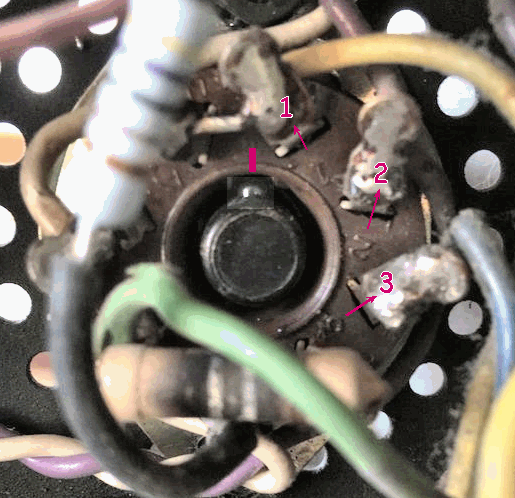

Well this one, sitting directly under the tube, seems pretty burned, so much that I cant read the original value.
Looks like it could do with refurbishing by the look of it.
Let me know which pin it connects to and I can work out what the value is for you.
Bottom right of your photo shows a discoloured component, I would check that one as well.

The pins read clockwise from underneath so if it was pins 6 & 4 that would be the screen grid supply resistor. Pin 6 has no connection in the valve so we used it as a tag to connect components to.
It is a 100R 2Watt resistor. That is definitely not a cause for red plating in a good valve! Check the control grid voltage, pin5, it should be around zero volts.
Well, it is pin 3 and 5, it's easy to see since they are numbered underneath. At the other side socket, its easier to read the numbers
That is not possible to go between pins 3 & 5 it is definitely on pins 4 & 6.
Replace the resistor and measure the grid voltage on pin 5.
CAUTION, there is a possible 350volts on pin 6!
I dont know how you would count that otherwise than clockwise from after fitting slit of socket/tube. I am just reading the numbers pregnated on the pictured downside of the socket. As you can see on picture they are numbered 3 and 5, while 4 is the middel (bottom) one not connected with resistance. So you mean its a 100 ohms and not 1 k.ohms resistans?
Originally we fitted 100R some had 1k0. I prefer 1k0 but measure the others and fit the same.
The link of wire is between pins 8 & 1. so count clockwise from the right hand tag (pin1).

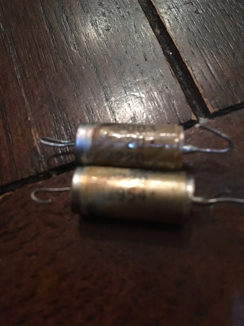

Your picture is not in focus. We cannot read the numbers either...
If they were connected to the cathodes (on pins 1 and 8), they were originally 100uF 100 volt caps. The big gold resistor was 220R originally too.
Makes sense. Yeah its those. Just when I messure one, it shows 58.9 uF and the broken ones show nothing=0.
Well, it is pin 3 and 5, it's easy to see since they are numbered underneath....
I have not followed the discussion to know what pins are in dispute.
However the molded numbers are sometimes confusing. Start from the fitting slot/tab. It is between pins 8 and 1. The molded "1" is near socket 1 but looks closer to socket 2. They should mold the numbers very close to the sockets. They didn't.
To finish the tread: It was, as I suspected from the start, the 100uF capacitor at the picture/tubes that was not funtioning and caused the resistance, tubes and fuse to burn off. After replacing one capacitor 100uF/100V at each channel and the burned out restanses and the 2 Tubes at both channels, it's playing nicely again. Thanks to everybody, and especially Jon for the help. As I explained I am a high (Kilo-)Voltage electrician and not an electronic and tube amp qualified. Am Happy!!
