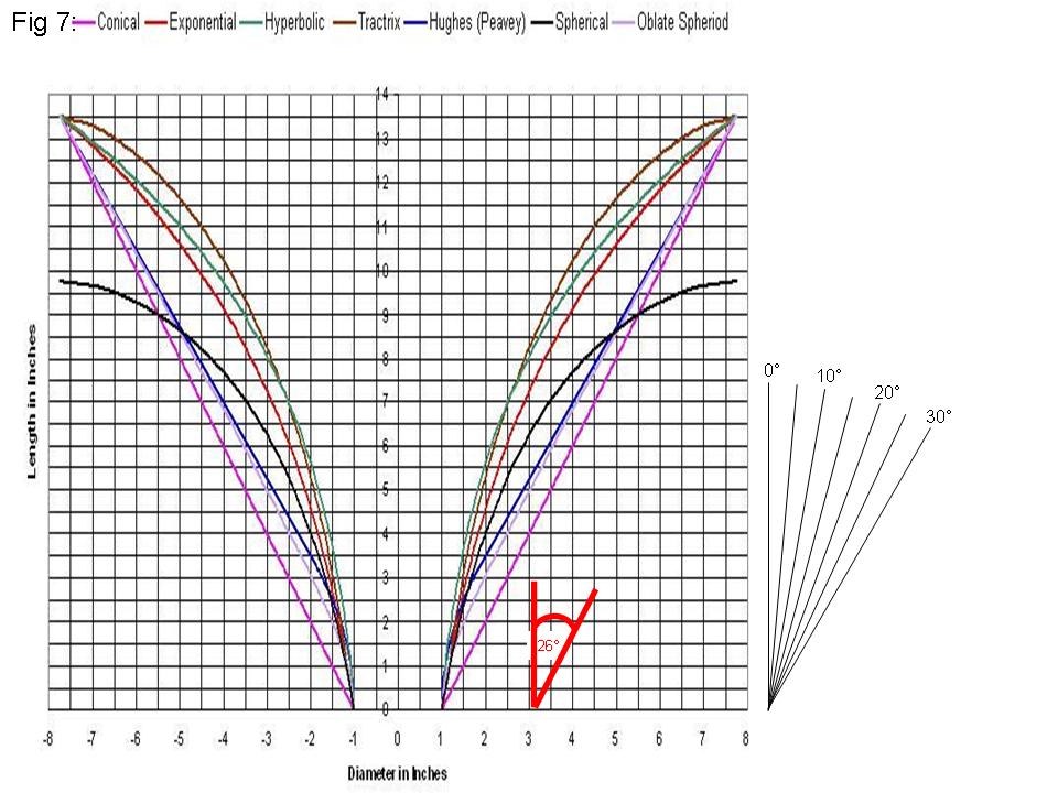

Greets!
FWIW they were textbook design, so can design them with any horn calculator such as Hornresp or simple math, though due to beaming it's better to use Dr. Geddes' oblate spheroid + terminus roundover to at least 180 deg..

Greets!

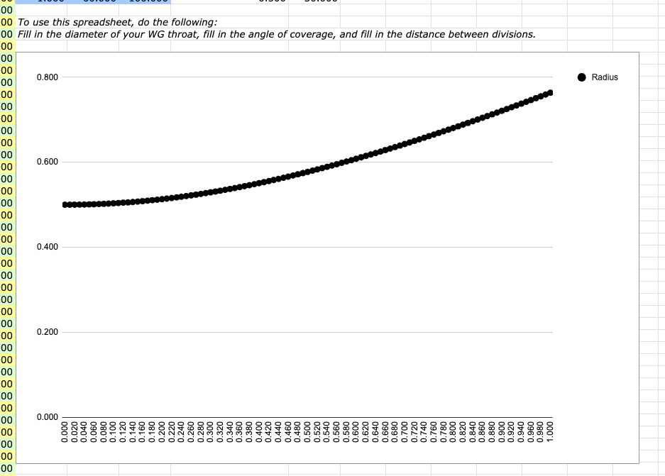

Thanks for the geometry. DId you find this online or use a calculaor? Which calculator did you use if the latter?
I would also like to know how to Blend conical to OS at the throat as I believe you're right that this would yield better results.
I checked my archives, and I have a copy of a XLS from the Geddes OS thread, in case it's not there anymore. I can't vouch for which revision it is. It doesn't have the roundover math.
EDIT: that's not the one you want. There's one that will let you specify the angle. Let me dig it up.
Reactions: GM and Pano
OS is 'conical' for all intents and purposes. You use it whenever you want conical but don't have the starting wavefront for it. The result will be equivalent to conical.
However at no point is it actually conical. If you want to blend one to the other you have to choose some point and glue them together. Working out a compromise requires an understanding of how it works, however just doing the throat seems a popular choice.

Of course I want to try it, I am a bored retired old man. What I am asking is I think if the throat is larger than 1" the arch of the excel needs to also extend beyond 1" and its not, correct? It should go to 1.4" but I am not sure how to indicate that using the excel. Maybe it's not possible there.
