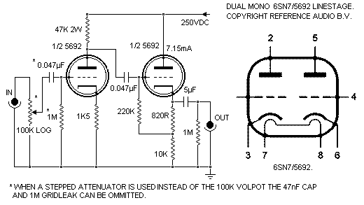

I happen to be a 6SN7 fan and highly recommend Franks line stage.
I built this and I am very happy with it. The performance is very good and sonically very pleasing.
This circuit can probably be improved by simplifying it: remove the coupling cap between the stages, the 220K resistor and the 820 ohm resistor. Directly connect the cathode follower's grid to the first stage's plate. Slight readjustment of the 10K value may be necessary depending on the plate voltage of the first stage. It appears that it can then be increased in value to maintain the 7.15mA shown in the schematic. A higher B+ wouldn't hurt with 6SN7s. A CCS instead of the 10K would be better still, but departs from the inherent simplicity of the design.
This unnecessary AC coupling between a common cathode first stage and CF second stage shows up periodically for some reason. Usually in a well designed common cathode stage the plate sits at roughly 1/2 of the B+ (which can be made higher in this design). This voltage is usually an ideal bias point for the grid of the CF anyway, so why add the colorations of a cap if you don't need to?
