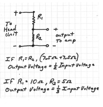

I would like to attenuate the voltage reaching my car amplifier by about 50%. This is because it is a stock amp with only high inputs, and my aftermarket head unit puts out a great deal more power than the original head unit. This hasn’t been a problem for me until I added a subwoofer suing the low RCA outs on my head unit, now the system isn’t balanced because the stock amp is so loud.
I realize that I could wire a potentiometer and find a good level, which might be what I end up doing, but I thought I would ask the forum if anyone could guesstimate a good resistor value for me to put between the head and amp.
It *would* help to know the input impedance of the stock amp.
But, you can make a voltage divider that should work anyway.
Per channel, tie two 7.5 ohm resistors in series and connect the pair across the speaker outputs of the head unit. Obviously, these will dissapate a fair amount of power, so they will need to be rated for 15W or so.
Output of the voltage divider will be at the junction of the two resistors for (+), and head unit output (-) for ground. Maybe a diagram will help...
Unless the input impedance of the stock amp is very low, this should divide the voltage roughly in half. An option to reduce the voltage by two-thirds is also noted in the scan.

Yes, I thought about that one, But I don't want to use big resistors, and that's just a little too much stuff to bundle up with the wiring harness for four channels. Thanks for the idea though.
I guess what I really wanted to know is if there is a standard impedance for speaker level inputs. I guess I'll just have to go to the trouble of wiring a pot inline in the car and seeing what resistance works. I imagine that the input impedance is relatively high and power resistors won't be necessary.
