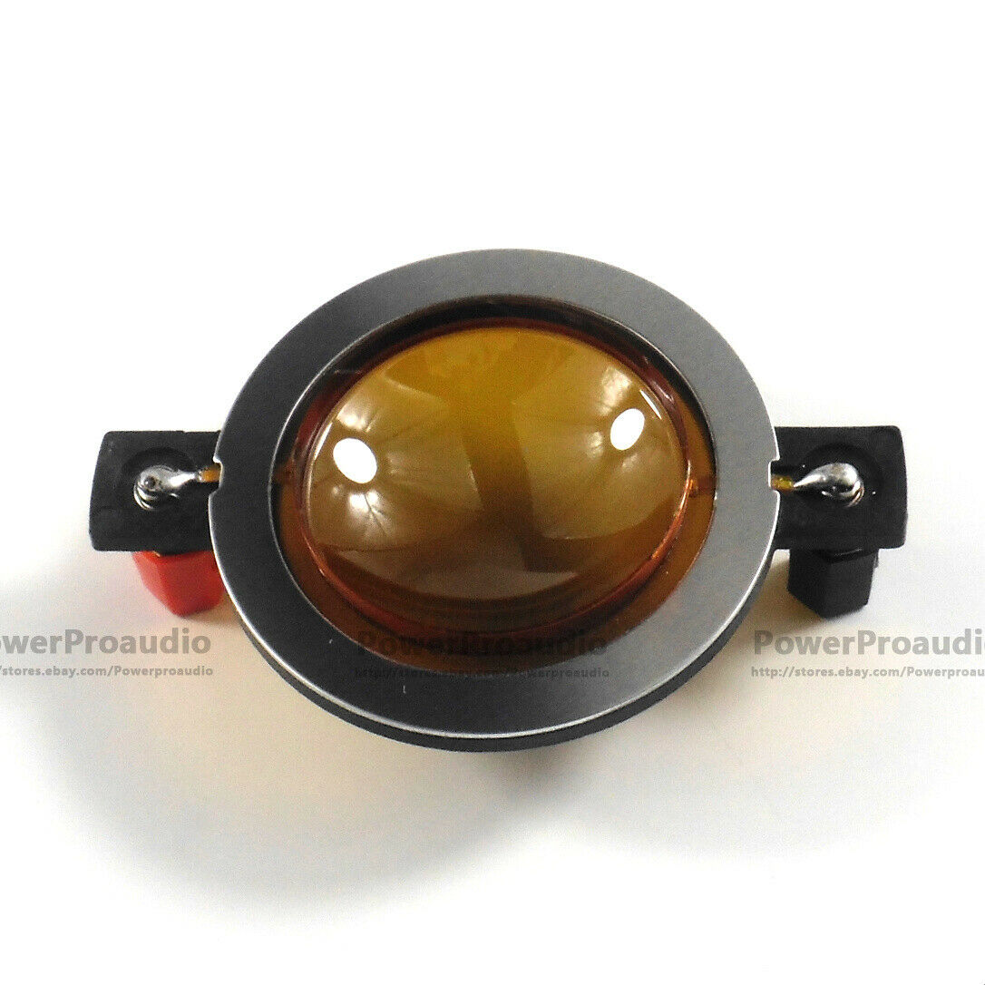

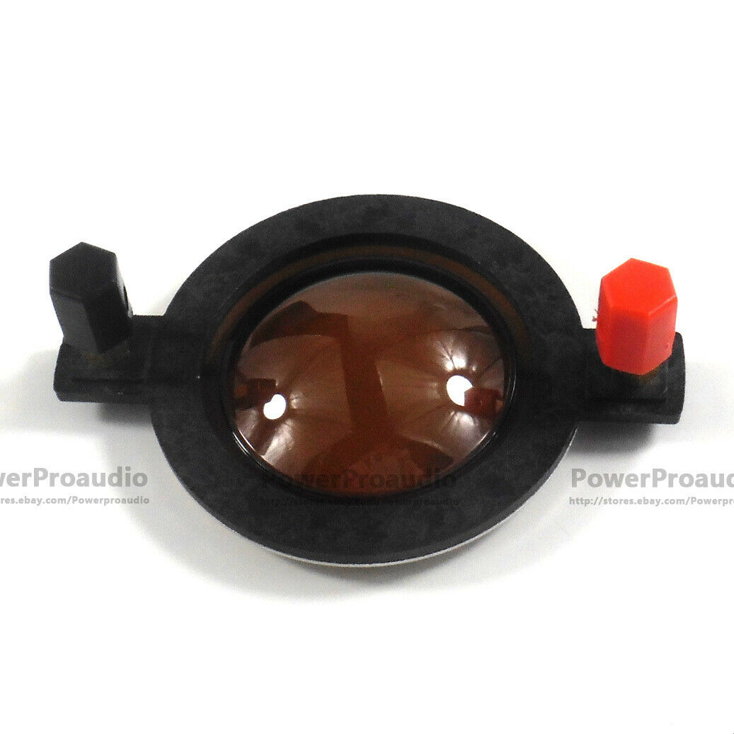

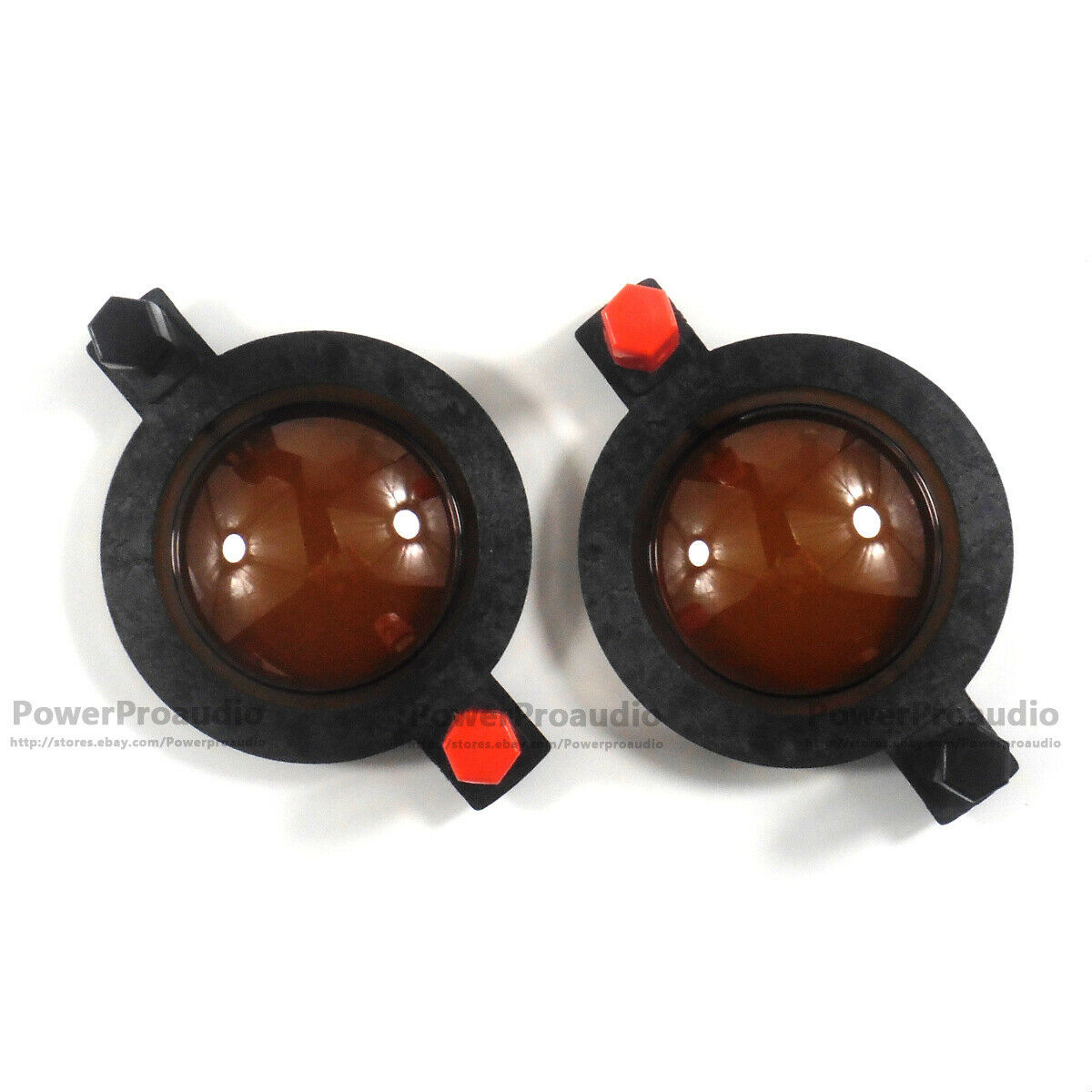

The recommended crossover frequency is 1600Hz , can it be lower for Hi-Fi use?
Dead URL. I have upload the datasheet.
I am looking for such a driver from this manufacturer, but without titan diaphragm and suspension (e. g. glass fiber, cloth or polyimide).
Who know the exact naming of this (may be very old) type ?
Maybe it was under the naming of the Turbosound parts.
Thanks for an advice.
