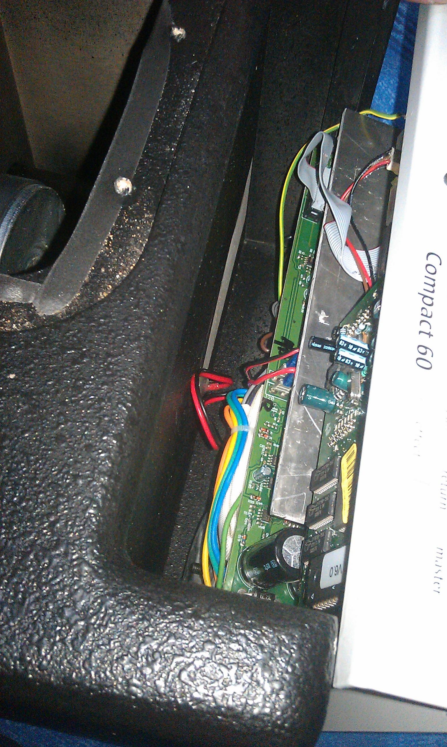

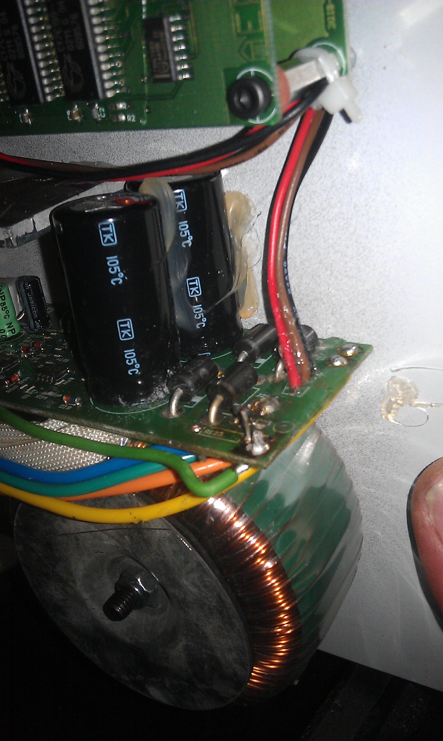

Hi everyone, I have had a look through articles relating to chip amps and bleed resistors. Just need to also know if there is a relatively easy way to calculate the correct bleed resistor value and wattage. It was hard to see what the value of the blown bleed resistor was - as it burnt the casing somewhat and almost took out a small capacitor (!). I have attached photos for reference. Power caps are 4700uF each at 35V.

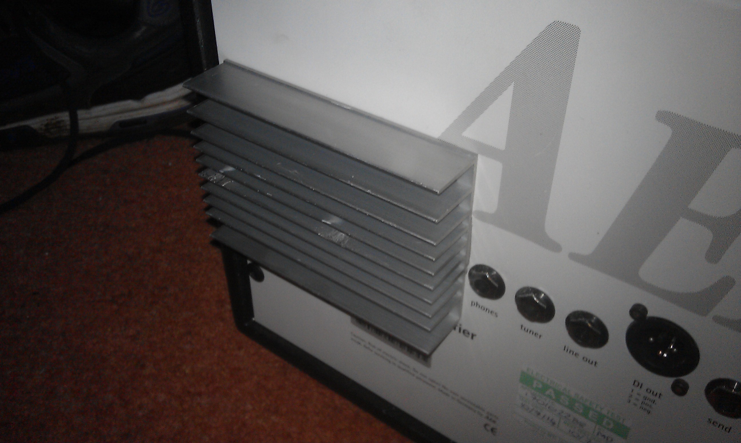

The other option could be to pop a larger heatsink on the back of the amp - bolted through the casing. The IC uses the back of the amp to further dissipate the heat. Perhaps a large heatsink on the back of the amp might help with drawing heat away and thus avoid the need for putting a fan in there?

if the bleeder resistor in the supply section is cooking i'd suspect that this unit is breaking into high frequency oscillation (which is also a likely source of the original complaint: shutting down thermally) time to break out the o'scope or contemplate replacing the main filters.
100k as a value for bleeder
Aha - I think you have nailed it! This could certainly explain the shutting down. This would also explain why it doesn't ever shut down when I put my hifi tuner into it and only shuts down when a guitar is fed through it. I don't yet have a scope (getting ever closer though!) so instead I think I will go ahead and replace those power caps. From memory, they seemed fine when I tested them on the ESR meter. Better be safe than sorry though. All rectifier diodes tested OK. Any particular caps I should be getting? I usually buy Panasonic ones from a reputable supplier.
respect temp ratings on the caps or uprate. and without a schematic it's hard to say but if the output of the chipamp has a Zobel make sure it's ok that could be another reason it might be oscillating.
sorry i was editing the previous post but in case you didn't catch it 100k should work.
I read the colour code on the original bleed resistor (it wasn't easy as it was somewhat burnt) as 10ohms. It looked like a 0.6w resistor. 10 ohms seemed much too low. Sure enough, when I replaced it with a 3W rated 10 ohm resistor, the resistor glowed hot like an element and almost set fire to the board! Thank goodness that I saw it quick enough to cut the power.
Update on progress - I measured all the caps and they were within ESR limits, so I popped a large heatsink on the back of the unit using the same bolt which currently goes through the metal bit of TDA7294. I then put another bolt in line with that one and put thermal paste behind the heatsink where it contacts the back casing. Not sure if this will work but there's only one way to find out - time to get my mate to put his guitar through it!
