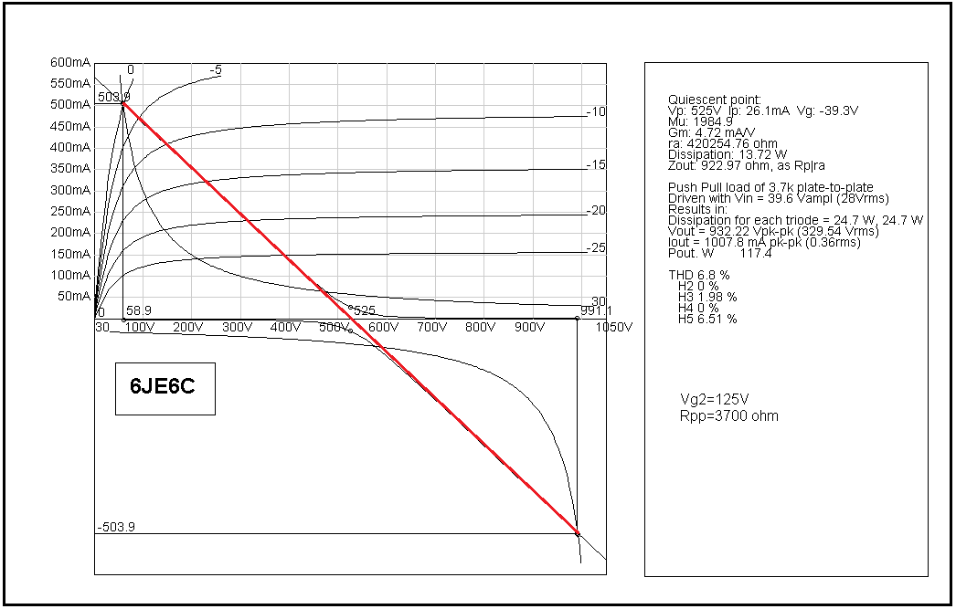

Do not you think it be better for load line tube 6JE6C right?.
... A model we generated composite chart and it looks like Raa = 3700 ohms would be more appropriate, I guess!

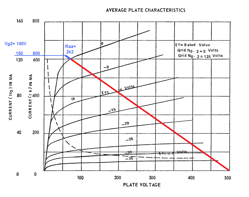

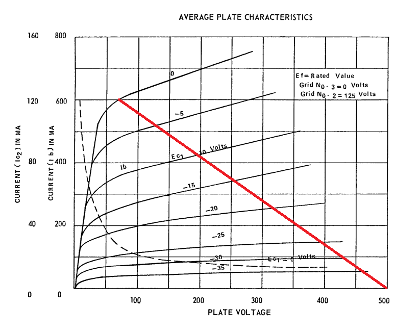

Ray, here's the loadline I originally drew. That shows a 2800 ohm load. Probably close enough, especially considering that your speakers will not have anything vaguely approaching a flat impedance.

If you adapt the vertical scale for Vg2=150V the same loadline is then for Raa= 2k2 🙂
