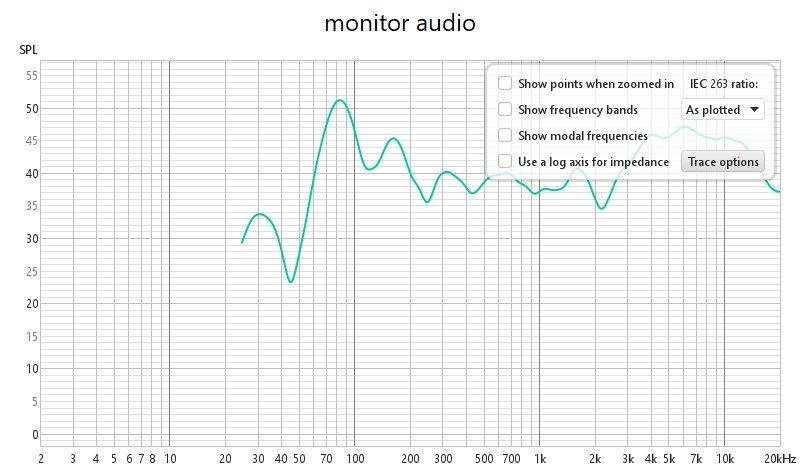

Monitor Audio (old), stand mount bass reflex. I don't know the model number.

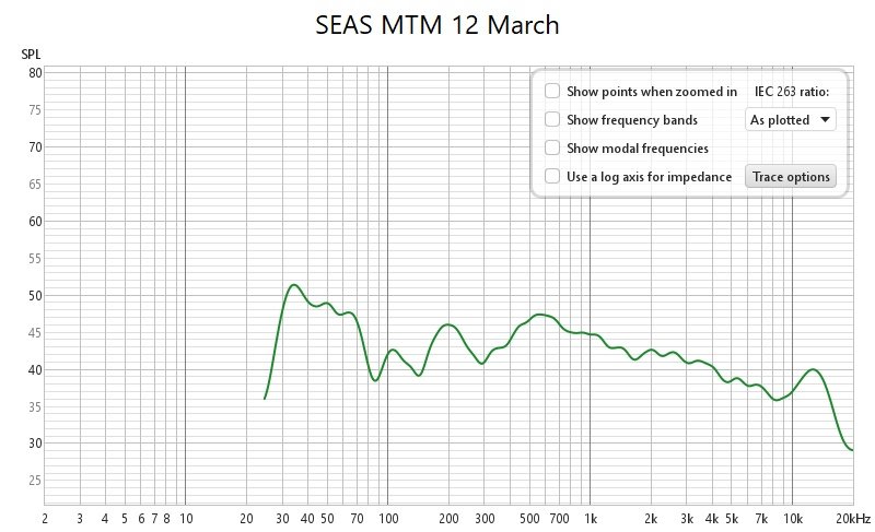

My SEAS ER18/27TDFC MTM:
The Monitor Audio sounds reasonable, the SEAS MTM sounds very good even though its FR does not look so good.
To me, the new Purifi/Be MTM plot looks the best, as with 1dB per division the variation is not that much. Am I kidding myself????

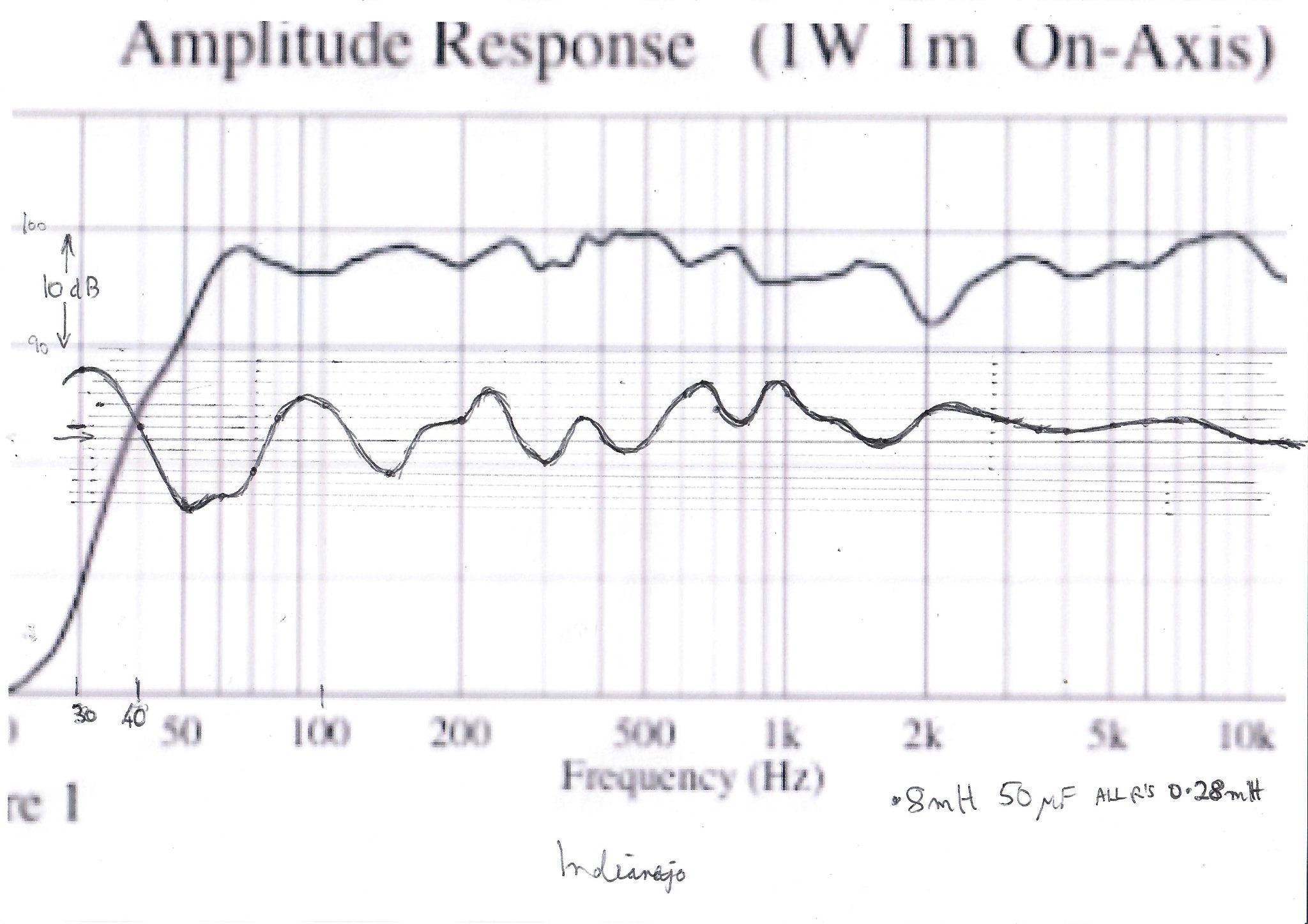

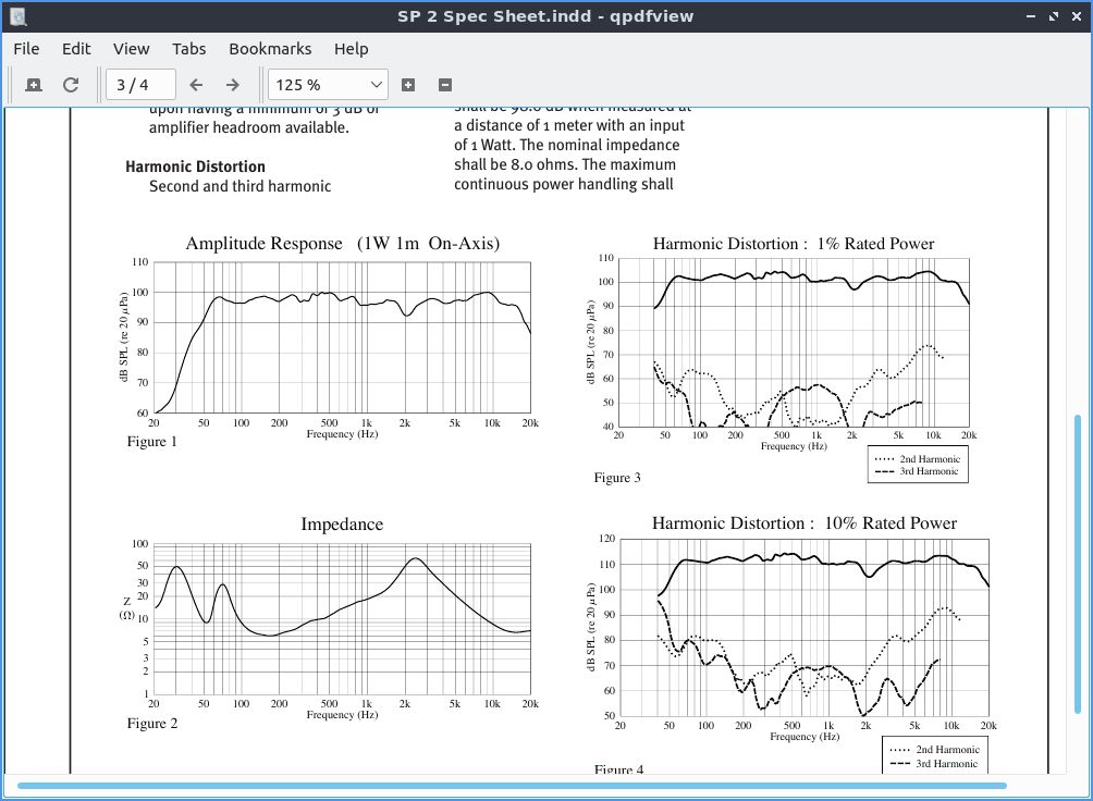

Those are really bad responses, even above 100 hz. minus 5 db gaps at 150 hz & 300 hz? What gate did you use on the REW? If room response, okay, but learn to use REW the right way.
Here is a anechoic +- 3 db plot from a commercial speaker I have in my music room. These are the best speakers I have heard in my flyover metroplex.

Indianajo, your words and pictures are most useful and are noted; the plot gives me an idea of what to aim for.
I had disregarded the odd result below 100Hz as being room related and (forgive me if I'm wrong) not untypical; as the bass seems good quality and about the right quantity, I have not been too concerned here.
The dips at about 130 and 300Hz I did notice, but a rough mental calculation suggested wavelengths about 7 feet and 15 feet, so though I don't know enough to know how the dip results, with a ceiling height of 7.5 ft and room depth 14ft this seems quite a coincidence.
I also note that your plot shows a dip of about 5dB at 2k Hz, which compares with my dip of 5dB at 1800Hz, and that in your case it does not seem to spoil the sound.
Other than this dip, your FR is within a range of 4dB; mine is within a 6dB range other than the 1800Hz dip and the above mentioned dips which may be room related - and OK, should not be ignored without investigation.

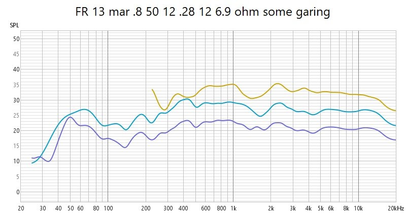

Thanks folks, this is all most useful. I have tried gating and moving the speakers, all of which were useful.
The fundamental problem remains, the room is a store/workshop with lots of stuff; I'm very much OK (can do sailing, DIY etc) but have to be careful over heavy lifting, so I can't get the speakers outside or improve the room.
The above shows gating at 3.3mS and also with a large number to get the bass. I know I'm not using REW properly but don't kick me too hard as I'm definitely getting useful results which correlate with listening, so voicing is going well. I will discuss this more in my thread about my fun MTM speakers.
Indianajo, I know you are right, even so I guess some irregularities are due to the poor environment. When I plot your sample of a good speaker, and my FR (the lower one) to the same scale, mine is definitely not as good; it needs some work, but it doesn't look too awful to me.
