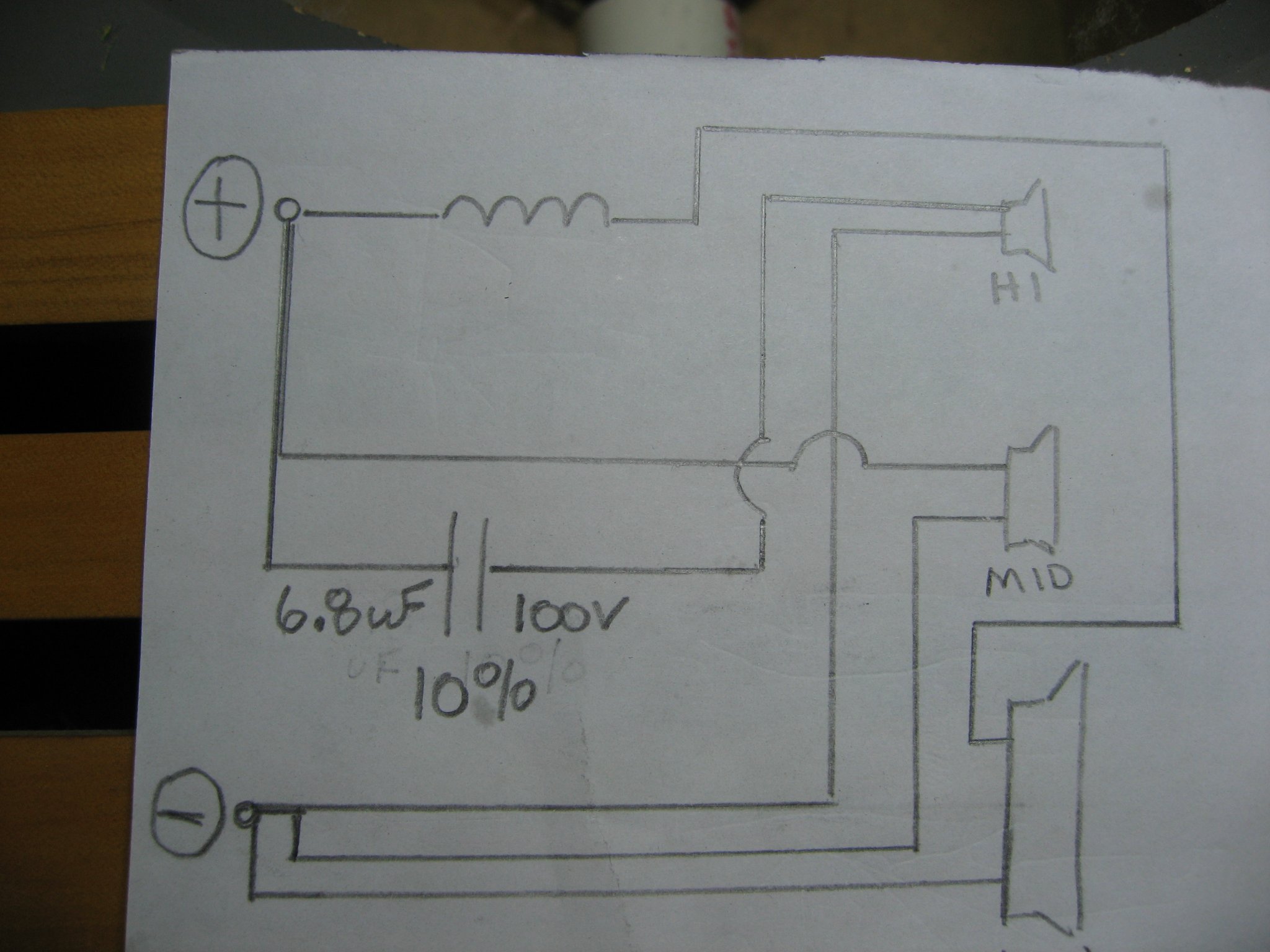

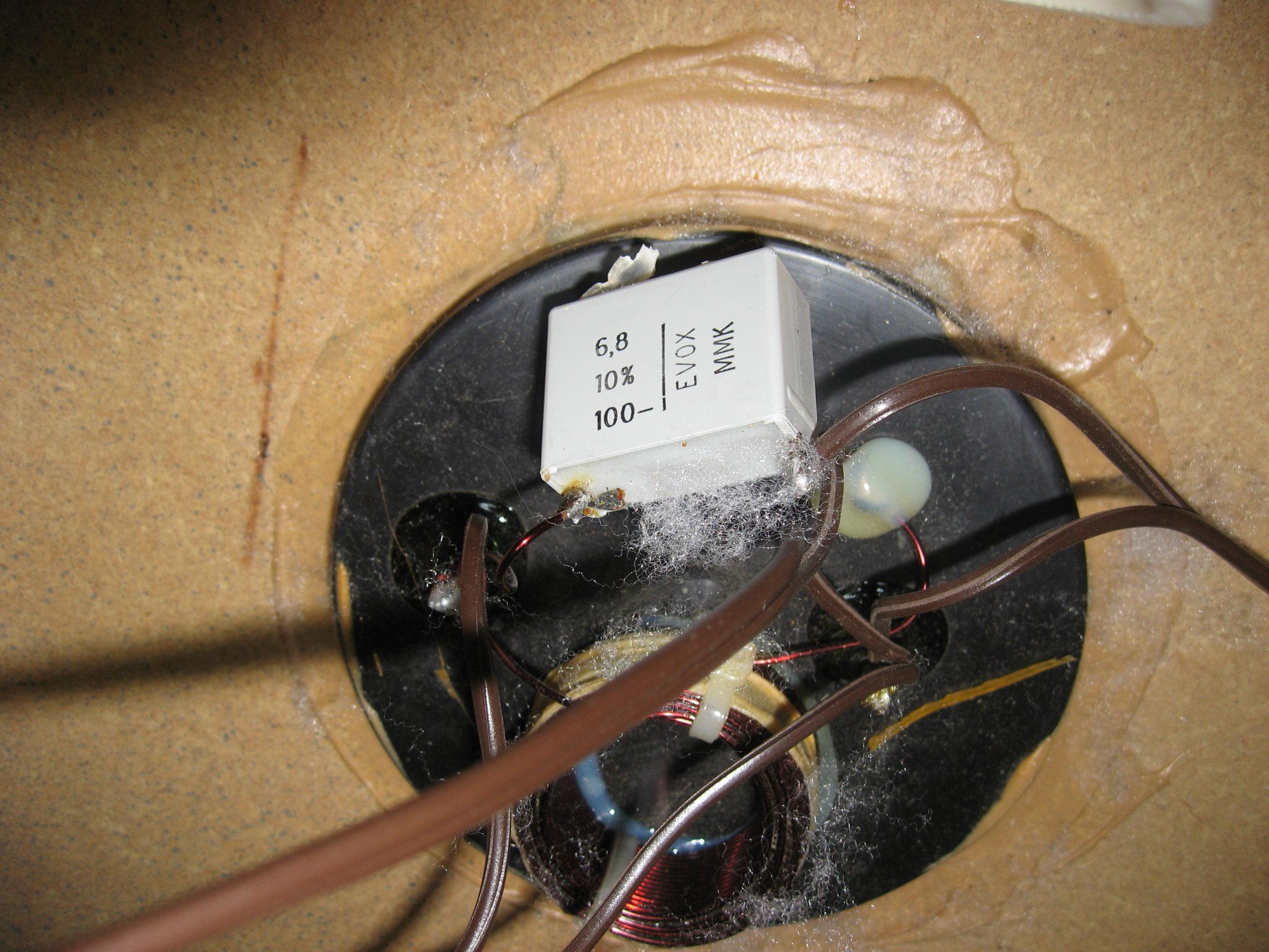

How's the capacitor feeding the component? I mean which value?
Probably under 10 μF, which don't go well with the type of midwoofer I was thinking of. Indeed the midrange dedicated speakers that Scan Speak and SBacoustics produce. Probably also the little PA midranges . Faital Pro etc. The woofer should be low-passed, though...

Wired in parallel, so higher current? Regardless, recommend inexpensive PIO motor run caps like the pioneers used for most natural speech BW. No clue without actually 'voicing' them by various age females.But I wonder why a 6" speaker rated at 10 watts and acting as a midrange is getting the full brunt of an amplifier's output? The speaker system itself is rated for 60 watts. Perhaps those who built the speakers thought that arrangement achieved the best sound? If any driver within a 3 way system was wired as a full range, I would have expected that to be, in this case, the 12" woofer.

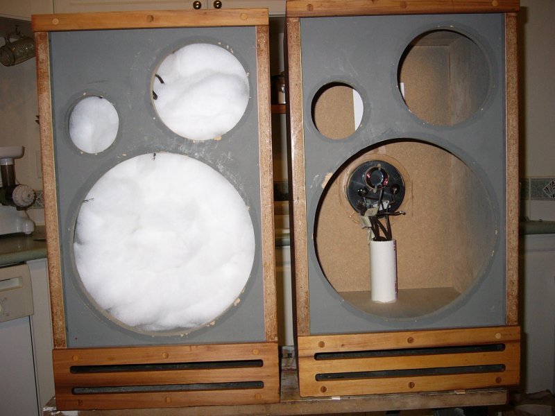

For what it's worth, after removing a woofer and the stuffing, the photo is what I found. And I drew a schematic of how it's wired to the drivers.
The only thing that came to mind is that the components we see are the residual ones of a bigger crossover.

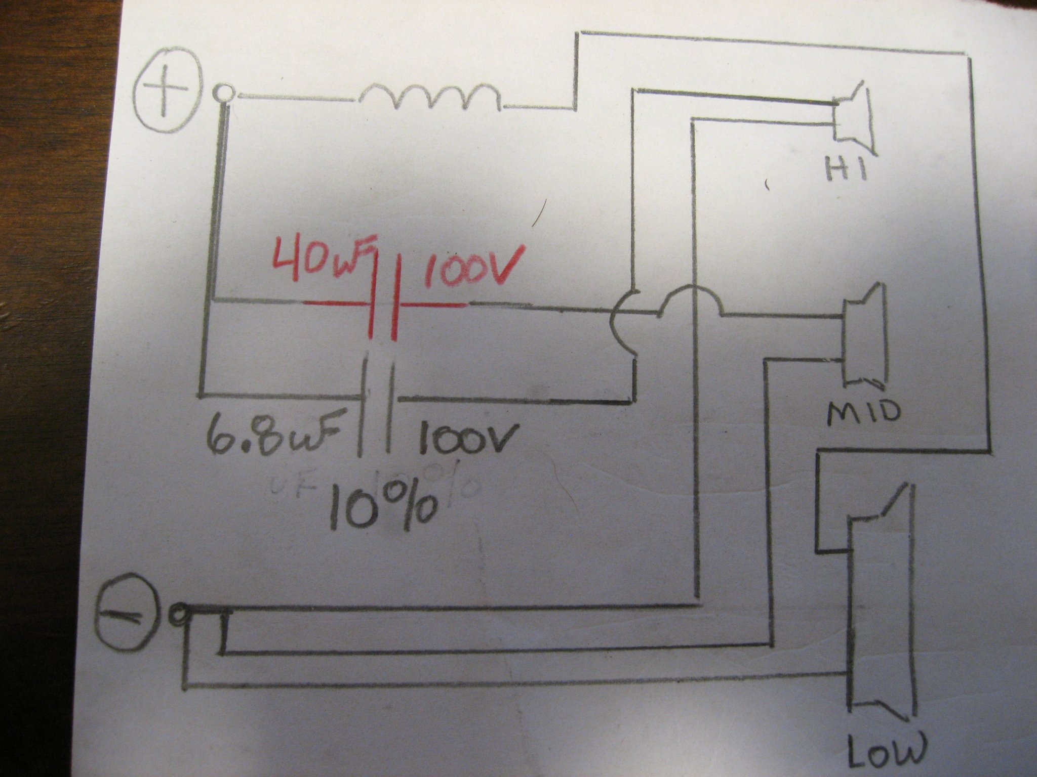

I drew in red what I think would be the correct placement of that 40uF capacitor.
The placement of the cap looks correct. Using a text book 1st order high pass, you'll want around 90 or 110uf to get down to 300 or 250hz, respectively.

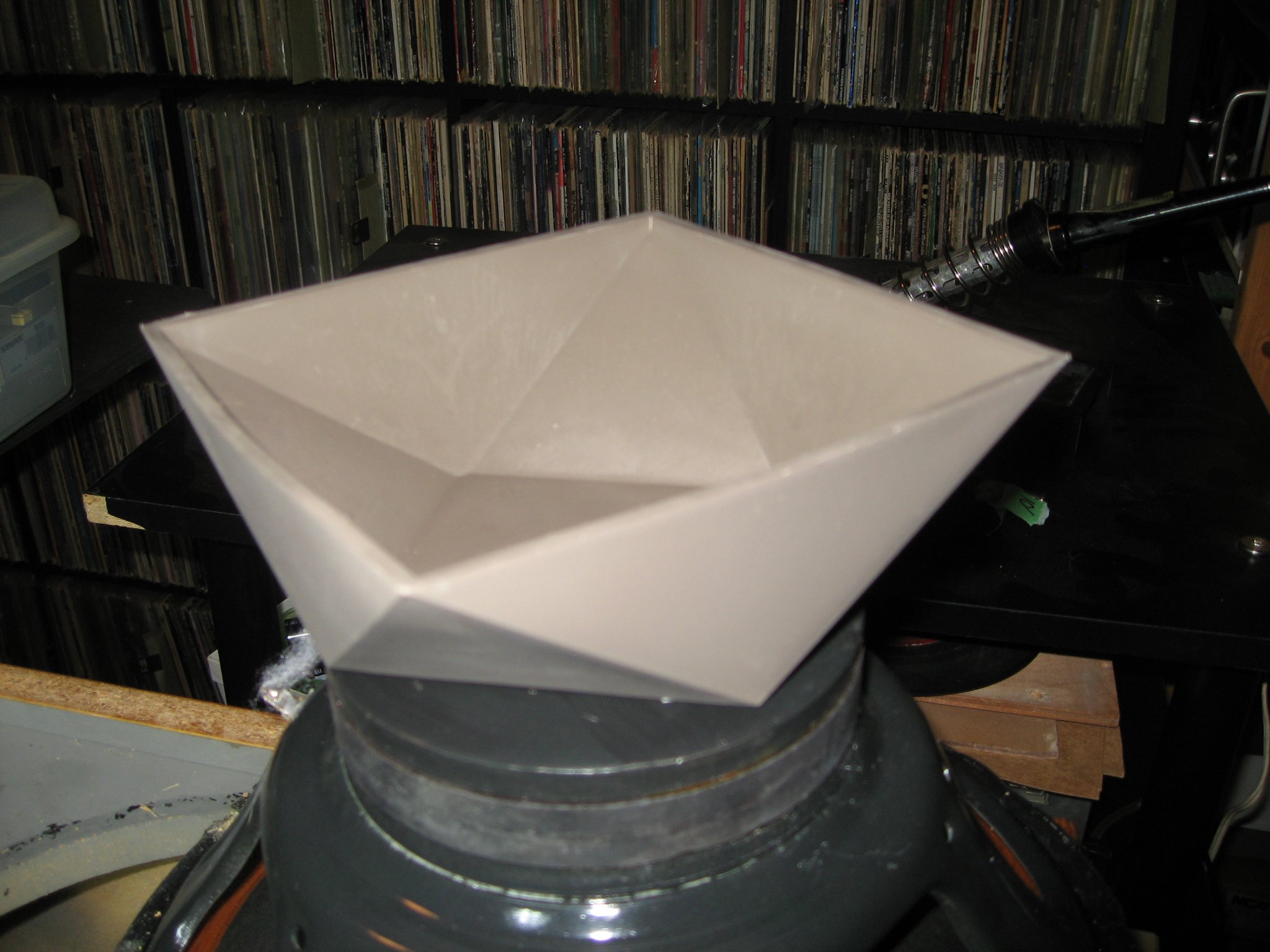

I used to have access to a nicely equipped woodshop but that luxury is gone. I may be able to cobble something together at a friends place who has a radial arm saw. I don't visit frequently as it's an hour's drive each way. I will see what I can come up with for materials to accomplish it.
It would be a box which must fit through the woofer cutout. Then be glued and screwed onto the inside of the front baffle.
I abandoned the notion of constructing a wooden midrange enclosure and took to looking around for alternatives. The other day, I slowly walked the aisles of the local Dollar Store and spotted some shallow plastic plant pots. I took two of them home to check for size and they seem to be a perfect fit. They are exactly the same 6" per side as is the 6" diameter of the midrange cutout and deep enough to allow clearance for the magnet. Or more precisely, clearance for the magnre of the Realistic 6 1/2" woofers.

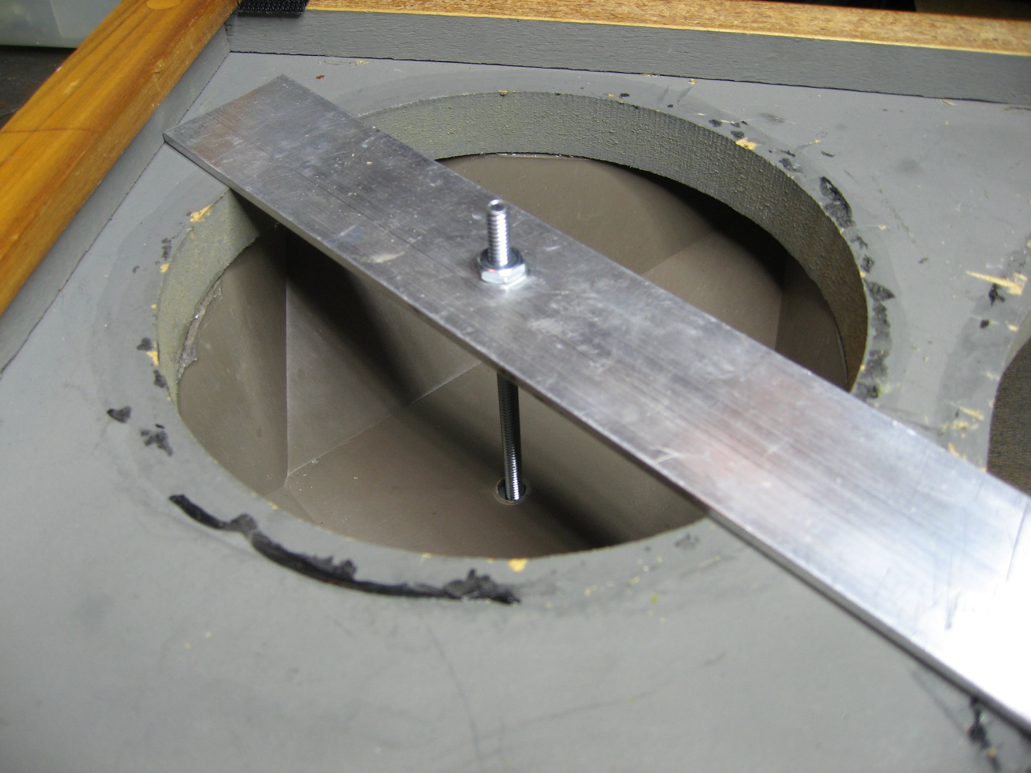

I have some LePages gel glue called Extreme Glue that, according to the packaging, will glue nearly anything to just about anything else. Plastic and wood are cited as bondable materials.
I concocted a method to apply pressure to the join so the glue can cure for 24 hours. Tomorrow will tell the tale of whether of not the glueing was successful.

FWIW, the picture below is the interior of the speaker enclosure. It shows the vertical PVC pipe entering a bottom chamber which then in turn vents into the room.

My second finding was that I preferred how the speaker with the isolation chamber sounded without the 100uF capacitor in place. In other words, wired as a full range.
The 100uF capacitor will be elimated.
Next I removed the original CTS 6 1/2" driver from the stock cabinet and fitted the new Dayton 6 1/2". This cabinet has no isolation chamber so the Dayton driver shares the internal space with the 12" woofer. And again, being driven as a full range
My impression here is I prefer how that cabinet sounds over the other which has the isolation chamber. I will remove that on isolation chamber that I installed.
My preference likely contradicts everything connected to loudspeaker construction. Perhaps others would hear things differently than I do or can critically listen better but for my own satisfaction, I will leave the boxes as is. So all I am going to do is swap out those 10 watt CTS 6 1/2" woofers and install the 50 watt 6 1/2" Dayton woofers and call it a day.
Your ears, your speakers, so do what you like.Perhaps others would hear things differently than I do or can critically listen better but for my own satisfaction, I will leave the boxes as is
