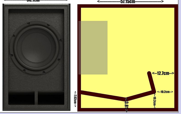

So I've pondered things over Christmas and have finally made a decision.
Upon reading TONS of pages of info on tapped horns I've decided that front loaded is a better option for me.
I fell in love with the Welter's 2xLAB12. The problem that I have right now is is that I don't really need two 2xLAB12. I don't have the amp power, nor $ to invest in 4 x drivers + another amp. So I started messing around in Bassbox. First I modeled the LAB12 and then started playing around with a single LAB12 box that had the same freq response. Obviously it is 3db down on the the 2xLAB12 output-wize per box, but I managed to get everything else matched up one-for-one with the Welter 2xLAB12. Outside box dims come to 15" high x 24" wide x 19.5" deep (with front baffle @ 18"). Full-height slot port on one size.
Started making sawdust yesterday; I'll post some pictures once I make meaningful progress.
Thanks for all the input and guidance. I"m really looking forward to getting my rig up and running.
Vince

Vince,The problem that I have right now is is that I don't really need two 2xLAB12. I don't have the amp power, nor $ to invest in 4 x drivers + another amp.
The single 12 box will be 6 dB down in output from a dual 12, -3 dB from loosing half the cone area, -3 from half the power.
Your box is now almost the same size and shape as the DSL CS-30, you might want to consider the port design it uses, similar to the diagram below.
Art

Art,
Of course it is 6db total... I meant watt-for-watt (so 400W for one box), a single is 3db down on a dual due to cone area.
Can you shed some light on the advantages of a such a port vs a standard slot port? How is such a port tuned? Basically becomes rear-horn loaded?

Vince,Can you shed some light on the advantages of a such a port vs a standard slot port? How is such a port tuned? Basically becomes rear-horn loaded?
The port is still a port, but probably behaves a bit better at high excursion.
From the DSL CS-30 specs it looks like it tunes close to what it would if it was as thin as the center of the port.
The inside (right side) upward leg of the port end mimics the front baffle, so the air flow in and out is more similar than a regular slotted port.
Your cabinet is 3" more shallow (and has less cabinet volume) than the CS-30, so unfortunately to tune as low as the CS-30 and still maintain the back distance on the upper leg would require a smaller center area, which may be too small for full excursion without excessive air velocity.
By the way, had you made the dual 12" box and just used one cone, the output at 40 Hz is within a dB of the dual using the same drive voltage.
Art
Ok, that makes sense. I agree that I don't think I can tune quite as low as the CS-30, but it is still an interesting port concept.
In post #14, the drawing shows the narrow portion of the port to be 3.81cm. It APPEARS that this is is an OD measurement (including the cabinet and port wall), however I doubt that. Assuming 18mm plywood, that would mean a port size of 2.1mm??? 3.81 must be the ID measurement...
If so, that is not far off of mine. My port came out to be 13.5" high x 1.9" wide x 22" long. I could work a CS-30 style port into my box... hmmm!
Vince
Vince
I assume that with a 22" long port in a 19.5" deep box means you have one bend already, the inside "leg" of a venturi port would be away from the cabinet wall, so it should work about the same as the CS-30.
Your smaller cabinet will need a higher tuning to keep the low end "bump".
Or you can tune it lower and have it flat or slightly dropping off towards Fb.
You can check Patrick Bateman's drawing for accuracy, I pulled the picture from post #7 in this thread:
http://www.diyaudio.com/forums/subwoofers/226235-featherweight-title-fight.html
Art
