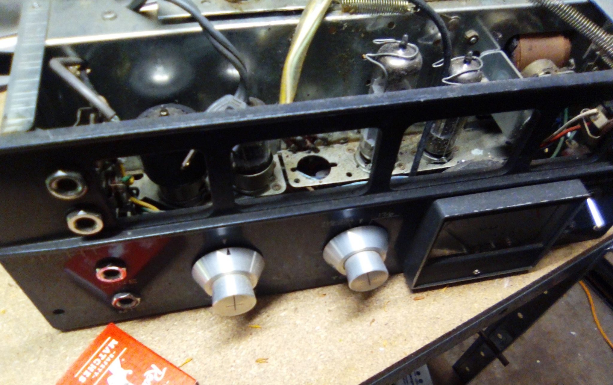

My brother gave me the amp or one very similar to this one:
https://www.diyaudio.com/community/threads/chinese-single-ended-class-a-questions.278409/
I would like to use, if possible, 6ar6 or 6v6 tubes as I have lots of them.
I can change the wiring for the 6ar6 but am concerned (from googling) about the screen voltage for the 6ar6 and all voltages for the 6v6.
My tube knowledge is minimal but I can follow instructions and will not electrocute myself.
Thanks for looking, mouse.

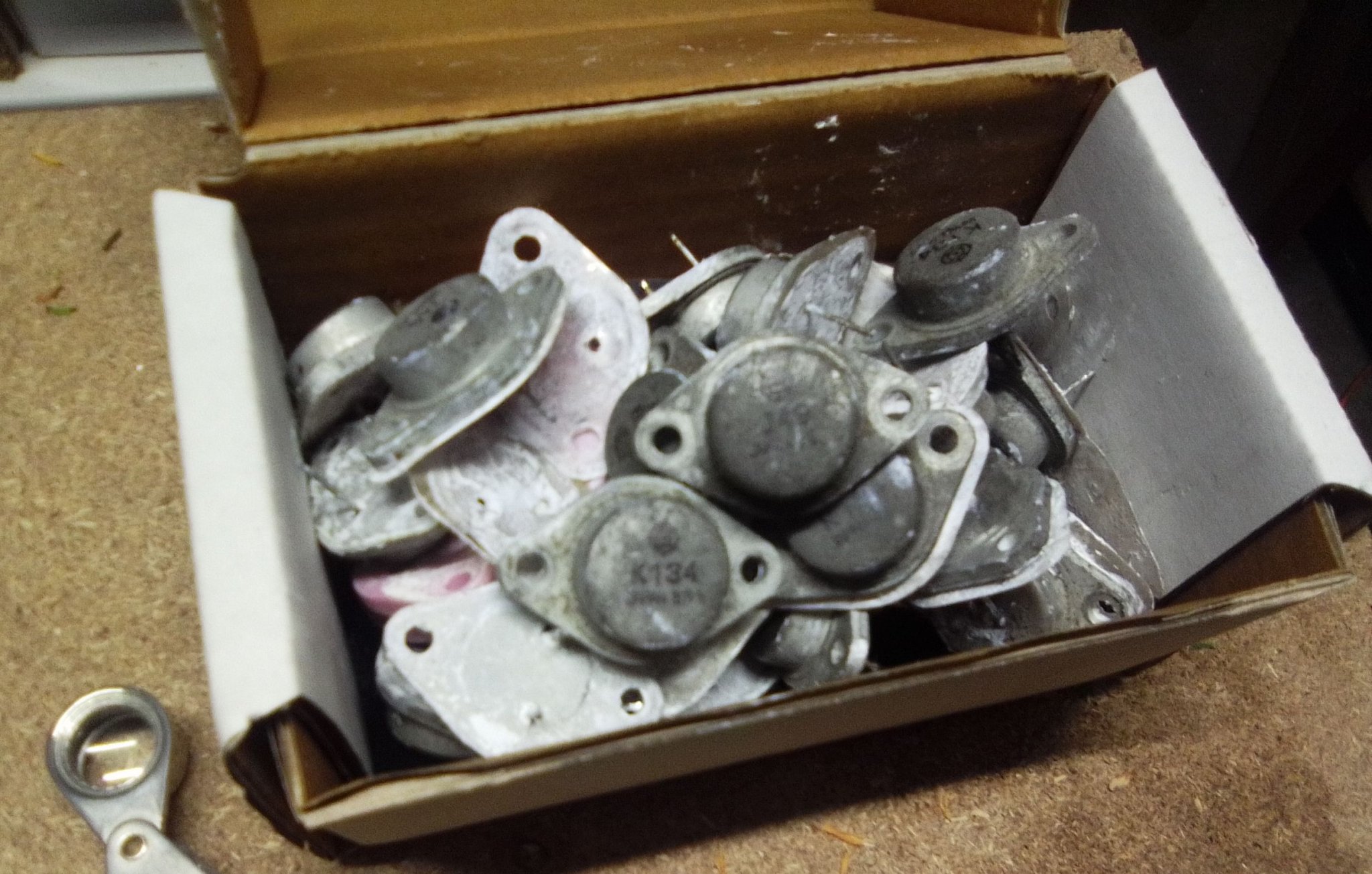

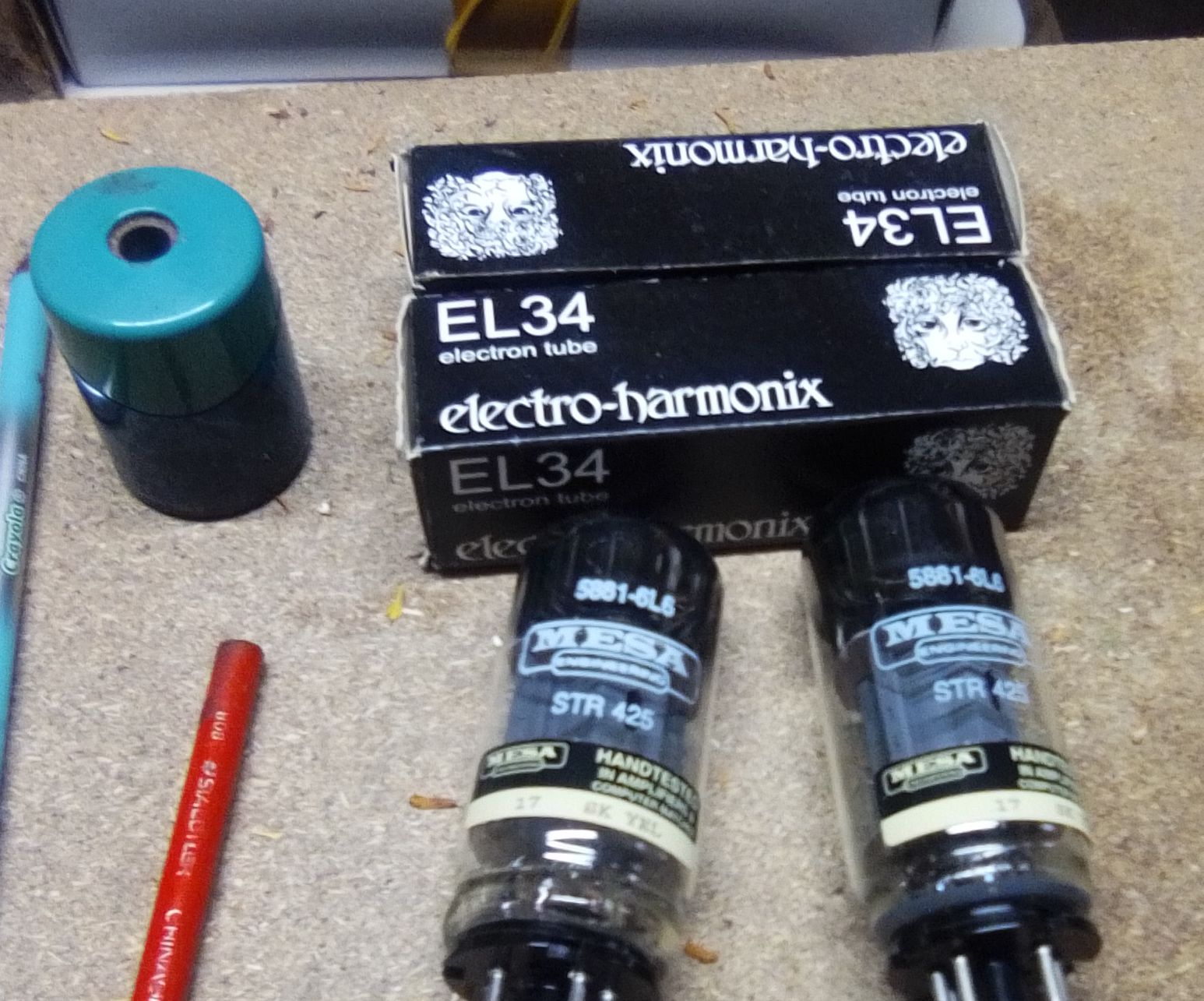

I'm back with news!
My brother told me to stop messing around with this amp and came up with new 5881 and el34. He said use el34 in winter because the transformer will get hotter.
Still want to use the 6ar6 and 6v6 with some se 3.5k transformers he will find and or these amps from an Akai tape player. It uses an el84 which he has but won't give me.

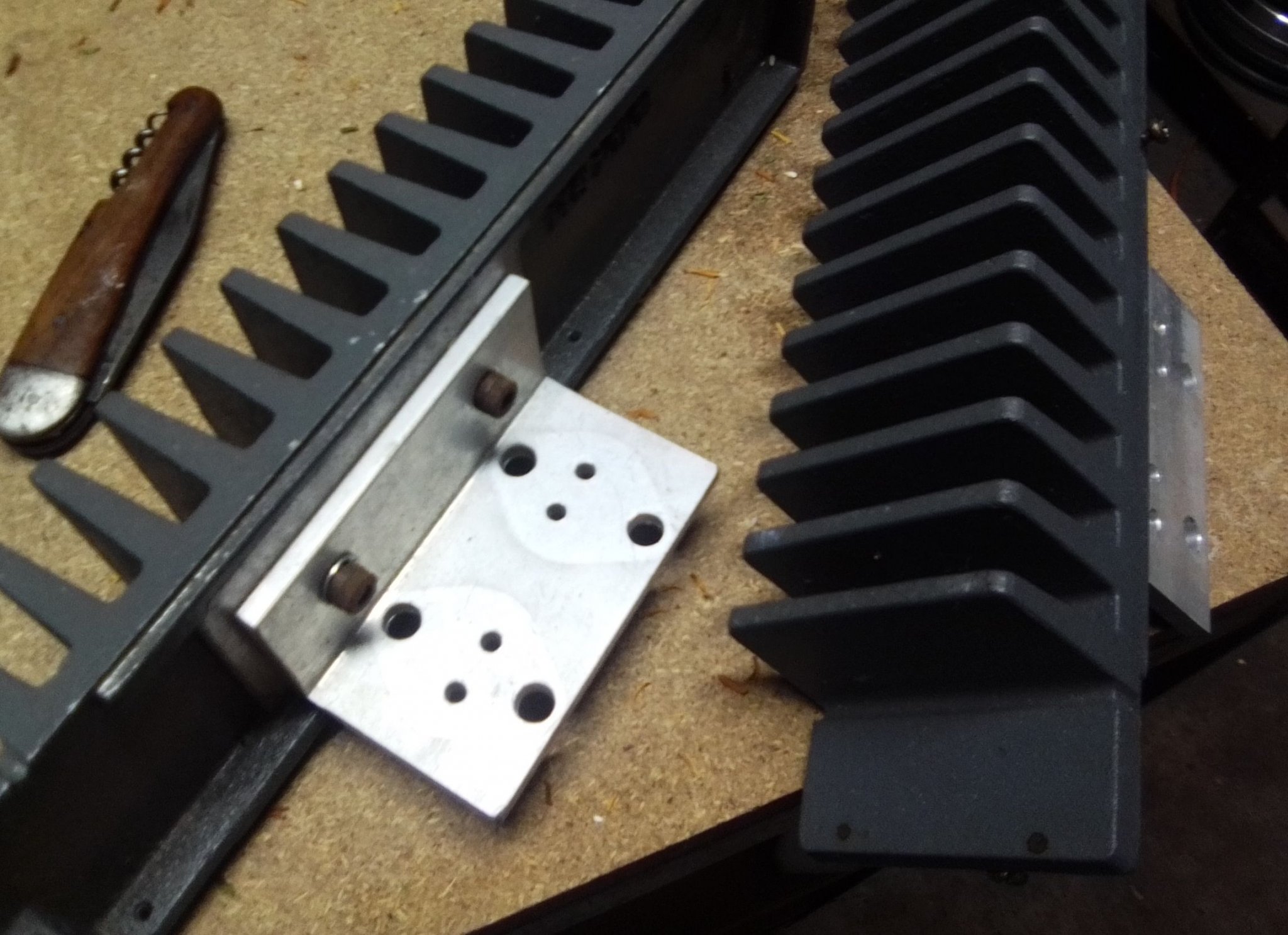

He also gave me some old Hitachi MOSFETs and some rather nice cast heatsinks so I'm not complaining.
Any advice on using these new transformers appreciated.
mouse
