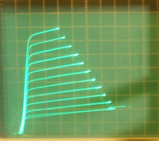

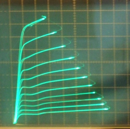

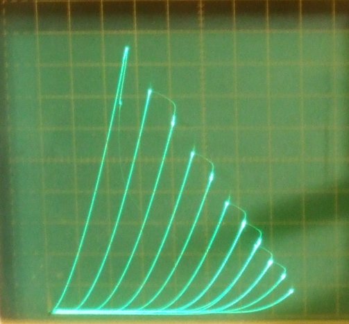

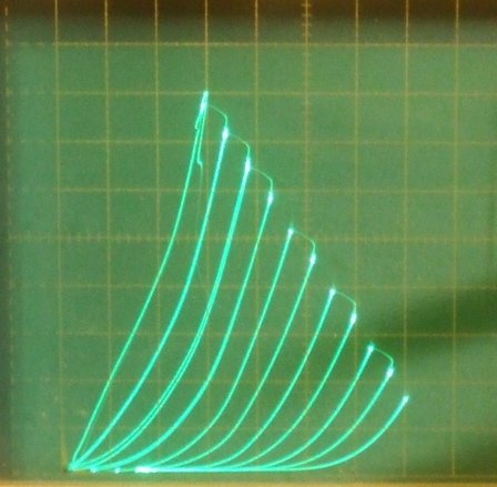

21HB5A/21JZ6 g2 or screen drive curves: (stop that drooling!!)
50 mA/div Vert., 50 V/div Horiz.
I suppose one could combine screen drive with Schade to the driver cathodes if you want to break the tube amp laws. ( super ultra mega linearity)

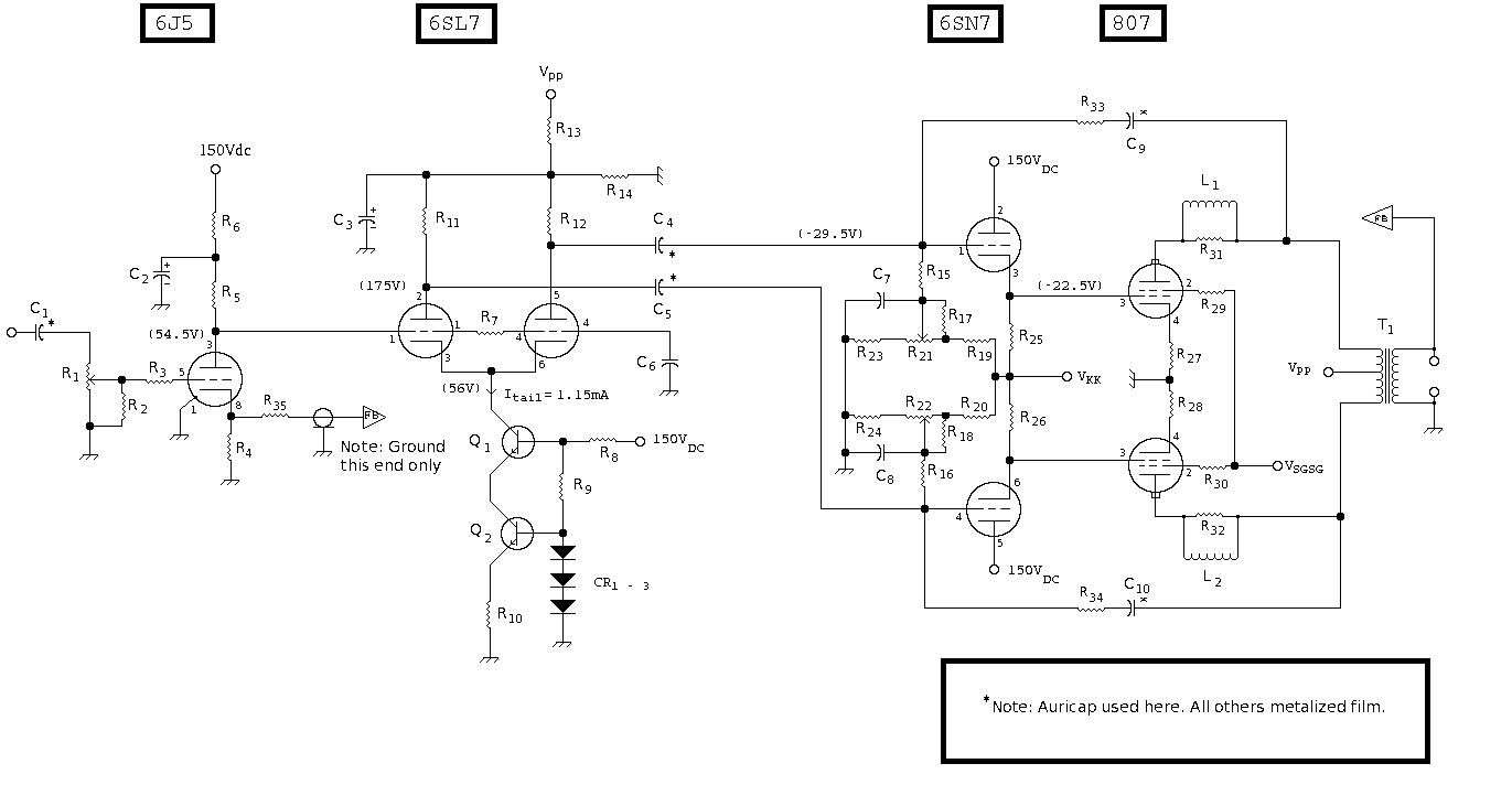

Attached, is an RCA Schade configured amplifier schematic. If you ignore, or remove, the feedback R22, R23 going back to the 6CB6 cathode(s), it would then be a normal Schade configuration. The Schade feedback resistor(s) R21, R24, are from the output tube plates back to the 6CB6 driver tube plates. The 6CB6 load resistors, R15, R19, going to B+ act as an R divider to attenuate the Neg Fdbk, and essentially set the gain of the output tubes. (for an Op. Amp. the V gain would be Rfdbk/Rin or R21/R15) In the tube case it is an Iin to Vout gain that is set. (the Rfdbk determines how much current is fed back, and the Iin has to counter that current and also produce the actual grid swing voltage as well, since the tube is not internally infinite gain like the ideal Op Amp.)
One interesting point about the RCA 50 Watt amplifier is the additional Neg feedback R back to the 6CB6 cathodes. It apparently is used to linearize the V to I conversion in the 6CB6 stage (by shunt current bootstrapping of the cathode R, making it look like a higher value to, in effect, increase the driver plate Rp), as well as to provide additional Neg Fdbk for the output tube.
This circuit looks to be a very practical Schade driver, not requiring any super devices for the driver tube. Apparently it has not been well understood previously in the tube brotherhood. And it certainly could use some simulation testing to verify and illuminate exactly what it is doing and how well.

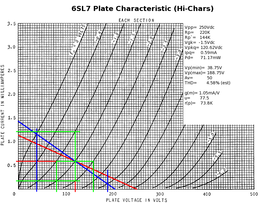

I used this type of lNFB with the Vixen. Schade's paper Beam Power Tubes (scroll down) recommended feeding back 10% of the plate AC. The design nominal power output for the load taken from the STC 807 application white paper was 26.5W, but since this design includes grid drivers, it goes a bit into AB2, and the measured power out at 1000Hz was a little bit over 32W. So use that value:
P= V2/R
V= sqrt(32 * 6600)= 459.57VRMS
V= 459.57 * sqrt(2)= 649.92VP
Vphase= 649.92/2= 324.96VP (325V design nominal)
Vf= 0.1 * 325= 32.5V
The impedance at the summing node: R12 || R15 || rp
From the loadline for the 6SL7 LTP: rp= 73.8K Therefore:
73.8E3 || 220K || 1M= 52.37K
Given the 10 : 1 voltage division: Rf= 9 * 52.37E3= 471.33K (470K design nominal)
The design nominal input voltage for the grids is 22.5VP/phase, which comes from the LTP. The total voltage is:
22.5 - (-32.5)= 55V
Since the grid resistor is 1M, that means a current of 55uA. However, the LTP is supplying less voltage, making the effective grid resistor
Rg`= 22.5/55E-6= 409K.
This appears in parallel with the plate loads, making the AC loadline:
RP`= 143K (design nominal)
This is the value used for the AC (blue) loadline. It does load down the plates quite a bit, but the h2 estimate still looks pretty good, and will be much less in practice since you're not using very much of the entire output swing. It's less than 1.0%, and since it's mainly h2, you lose that since even order harmonics null in balanced circuits like LTPs.
The estimated gain for this LTP is 25, and the actual measured gain is 25 -- a 0% error! O. Schade's recommend was bang on, as the lNFB really helps clean up all sorts of pentode nastiness when using the 6L6/807 and other 6L6-oids. All that remains is adding enough gNFB to help take the "edge" off. Other pents probably don't need the extra help, such as 6BQ6GAs. These make mainly h3, and all you need is some gNFB.
