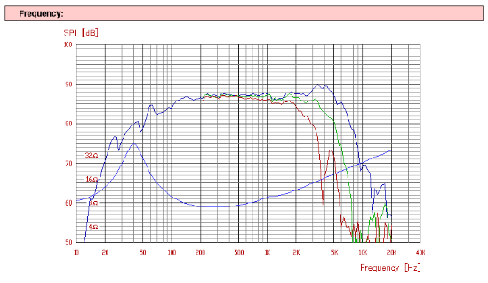

http://audio-hi.fi/download/pdf/Peerless_Vifa_NE180W-08.pdf
http://audio-hi.fi/download/pdf/SEAS_Prestige_H1456_ER18RNX_Datasheet.pdf
SB Acoustics :: 6" SB17NRXC35-8
On this item, main what i see here: H1217-08 CA18RLY is too big Vas needed (32 L)
Otherwise last items response looks for me much better on range 100Hz-4 Khz.
So, what you consider actually important when maching box? Vas, F3, resistancy, crossover frequency, rise and falloff shape or what else??
So many parameters to look @...
I am just curios enough, to wish understand why some item is reccomended against/besides other.

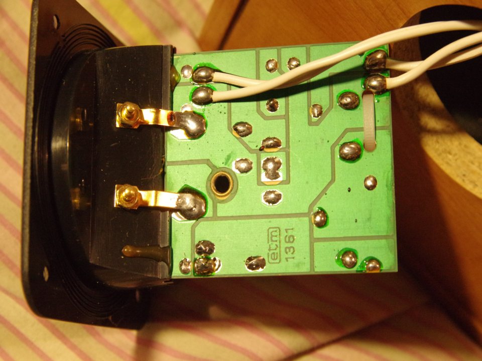

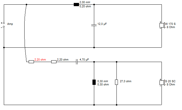

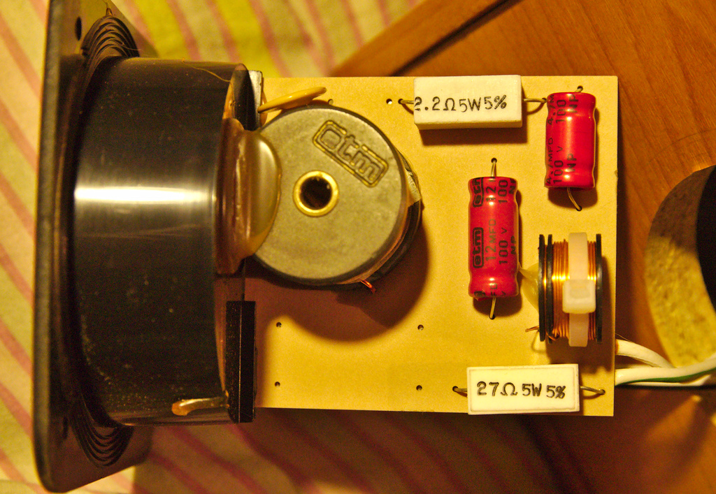

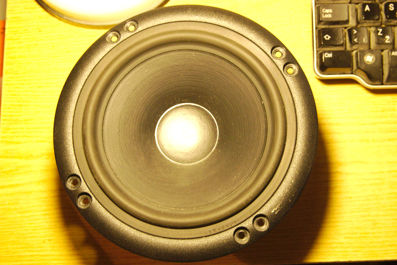

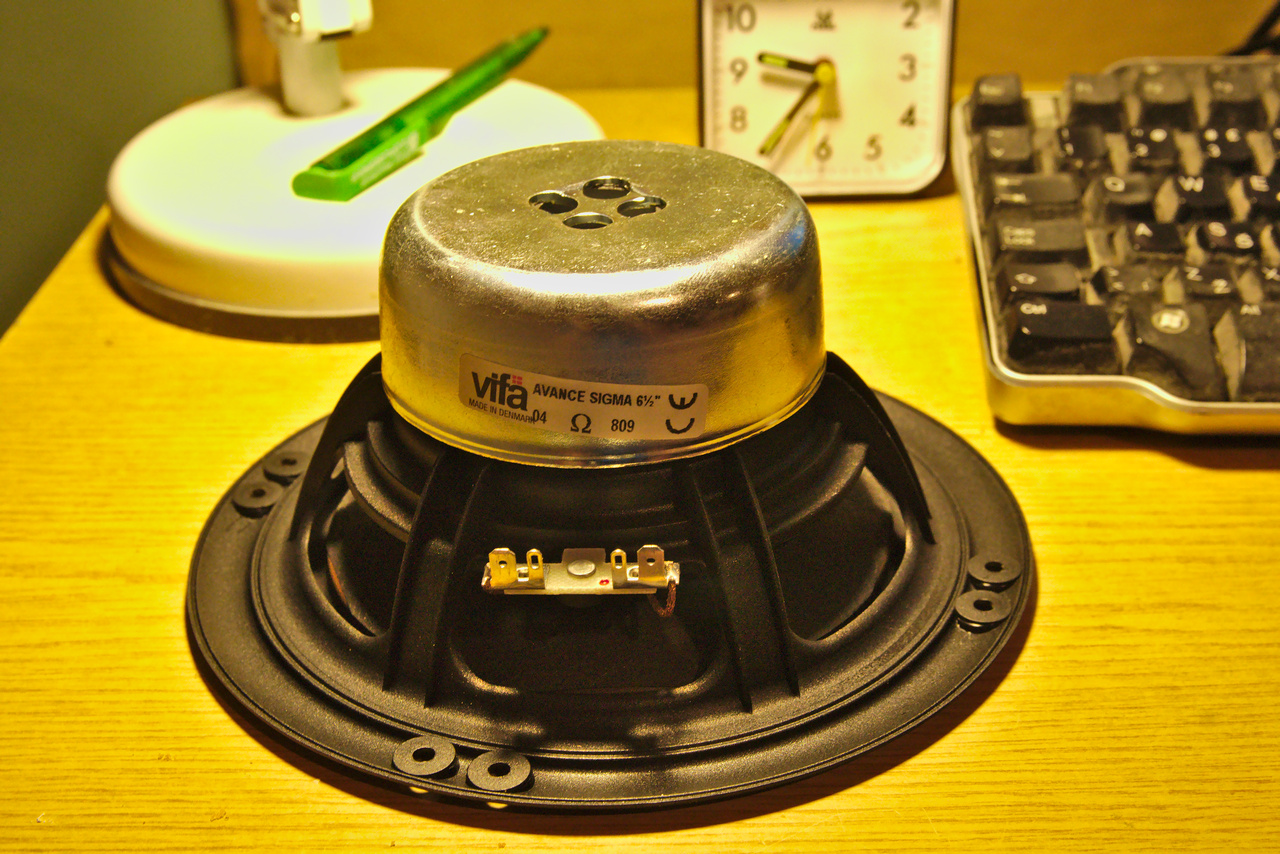

As i am back, i can provide again some info:
Cut-hole for woofer is 148 mm.
Tweeter measures also 6,2 Ohms.
Crossover: you can see it on pictures below.
All labels original woofer has you can also see on pictures. (Have not taken off magnets shield)

Looks a lot like a vifa TC18 series woofer.
lautsprecherkauf.com - Vifa TC18SG-68-08
If that one is no longer available, this one would probably also work, but it is no shielded:
https://www.madisoundspeakerstore.com/peerless-woofers-6-7/peerless-830657-6.5-sds-woofer/
These are cheap enough that you could just buy them and try.

I did a bit of modelling based on your crossover pictures. What I think we have here is a 2.2kHz 8 ohm reflex bass crossover. It's not bad at all. The red element is a semiconductor tweeter fuse or cutout.
