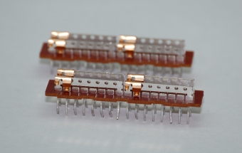

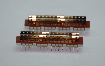

From where I can order the elements from the attached images of the Alps source select rotary switch (listen and tape select - the pictures shows this parts in genuine and cleaned condition) ??
