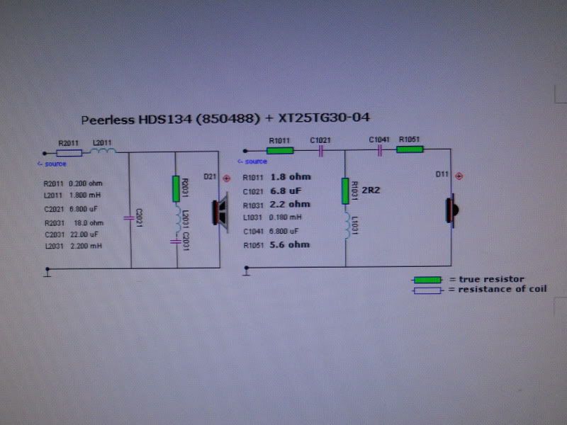

I'd like to raise the tweeter level on my speakers and would like some guidance on which component to look at altering in the schematic.
The resistor ratings in the picture are:
1.8 ohm (top left)
5.6 ohm (top right)
2.2 ohm (runs from top to bottom)
I want to avoid upsetting the balance - I did swap the 5.6 ohm for a 3.3 ohm which was the closest one I had in my spares box but it didn't sound right.
What would you recommend?
Many thanks
Nick

By reducing the value of the 5.6 ohm (R1051) resistor, you will cause a "hump" in the frequency response at the woofer-tweeter crossover frequency.
You will need to listen to your loudspeakers carefully after you make any changes but you may be able to increase the tweeter output by slightly reducing the value of R1051 from 5.6 ohms and also slightly reducing the value of C1041 (and possibly C1021). This will move the frequency of the crossover to a higher frequency.
It may be better to add a little (adjustable) high frequency boost to your system rather than to make changes to your loudspeaker crossover.
I don't think that bypassing R1011 (1.8 ohms) will make a significant difference in tweeter output.
Depending on how much more energy Manimal wants from the tweeter, R1051 could be reduced in value or bypassed and C1021 and C1041 could be reduced in value from 6.8uF to, perhaps 4.7uF.
It will take some careful listening to determine the final R and C values.

Thanks to you both.
I'll try Jerome's strap replacement first (its easy) and then compare with Frank's suggestion. It'll be interesting to hear what the differences are.
The speakers are very good (a Troel's design) but I'd just like to lift that treble a bit.
Huge thanks.

Well I've tried Jerome's suggestion of replacing R1011 with a wire and also compared it to Frank's suggestion of tweaking the values of the capacitors and the value of R1051.
My preference is simply replacing R1011 with a wire. The effect is subtle but I wasn't looking for major change. Altering the other components affected the way the treble seemed to project from the speakers - making things a little bit more forward. Not unpleasant but not as natural as Troel's crossover design had it before.
Thanks to you both for the suggestions.

1. Raising the level of the tweeter, add a little more mid. Not sure, but play with R2031 18 to 15,12,10 ohms... But do it after doing 2
