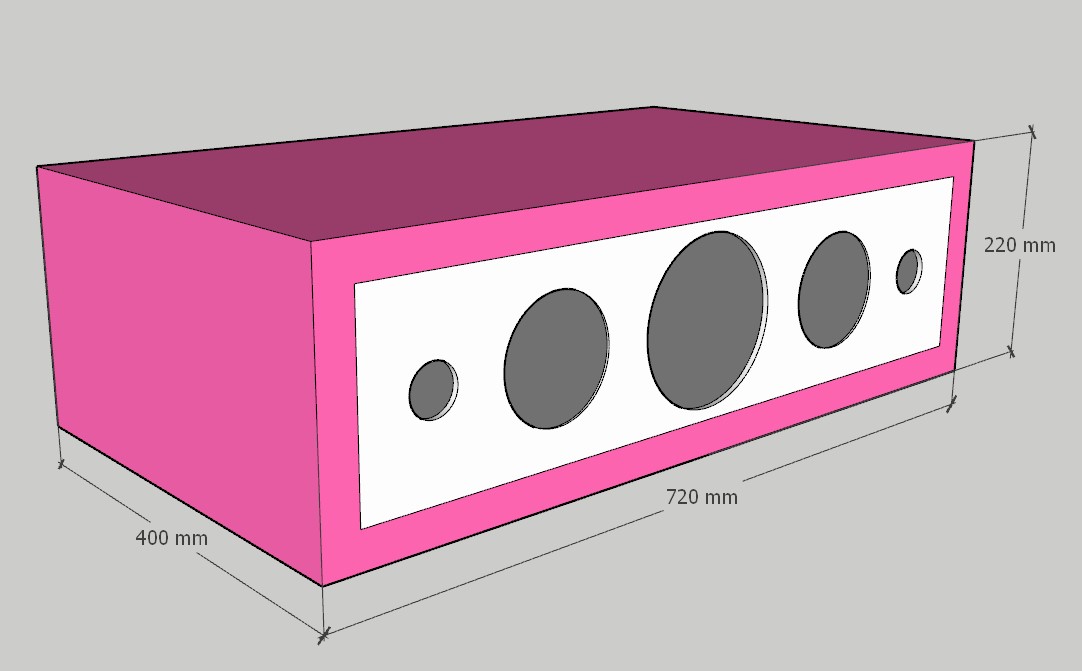

I have a coffee table shaped like a cabinate 720x220x400mm (63liters). a pair of EMU-XM7 (2way -5") (i know i am committing a sin) and a 6.5" Yamaha midbass woofer, powered by an Arylic 2.1 amp.
I want to put all these into the exclosure and know i will be sacrificing stereo.
I have tried to use the cabinate calculator but it has totally confused me and wonder if anyone here can advise me.
1) Is the enclosure too big?
2) Do i need a vent?
3) Should i enclose the 5" and the tweeter?
4) Should i build a seperate enclosure for the 6.5" ? and vent ?
I plan to use the cross-over from the EMU-XM7 for the 5" and tweeter.. and use the subwoofer function from the arylic2.1 to drive the 6.5".
Any feedback will be appreciated! thanks again guys. This is a place full of information though confusing for a newb. 🙂
Here is the ideas of the layout.

Welcome, kerv, I'll give your thread a nudge!a pair of EMU-XM7 (2way -5") (i know i am committing a sin) and a 6.5"
It's no wonder you are apologetic, as you are about to butcher a perfectly good pair of bookshelf speakers! 😱

What is this cabinet calculator you have tried to use?
I would consider the possibility of giving the 5" drivers (plus tweeters) their own small, sealed enclosures within the larger "coffee table" cabinet.
The remaining cabinet volume would then be dedicated to the Yamaha 6.5" mid/bassdriver. Can you give its specifications to determine its suitability for such a role?
You need to download the datasheet on your 6.5" driver to find out qt, vas, fs, xmax
qt > .4 many suggest sealed cabinet. qt < .4 many suggest vented.
I have a datasheet on a 6.5" visiton bg17-8 and the vas is 8.2 L so with a box of 63 L David Weems suggest your resonant F3 is about 1.2* fs. For a ported box.
His chart for 5 cm ID ducts drops off at 60 L but the next entry up in the 40 hz table is 2.2 cm long.
I wouldn't put the 2nd 5" speaker in there, nor the first. Too close to the woofer to bother with. I would spend $3 on a 3" tweeter. You are going to have to buy a box of crossover parts anyway. FIll the box with useful things. My $99 (in 1977) KLH23 were a 10" woofer with a 3" paper cone tweeter, tweeter blocked by one capacitor. Sounded decent.

Since the T/S parameters of the subwoofer driver are not available, we can do little to help you.
The subwoofer driver is intended for a ported enclosure as photos of the original Yamaha subwoofer enclosure reveal.
Enclosures have to be built around known subwoofer paramenters. I'm afraid you cannot just stick any old subwoofer into an existing cabinet and expect it to perform properly.

One possible cause of your bad sound of your quick box is internal reflections. Hard surfaces can cause standing waves at the frequency caused by the speed of sound and the dimensions of the box. People handle this by lining the box with absorbant or stuffing it with fiber. I intend to buy 1/2" thick jute carmat underlayment on ebay. Allegedly better than rubber underlayment available at all carpet stores. I intend to screw it inside the box in a double layer.
stuffing the box with fiber lowers the speed of sound overall and makes the box measure bigger than it is, so I am not going to do that. You had a box, a cabinet, that was nearly too big anyway for a 6 1/2" driver. I was trying to reuse a bit of furniture myself, 28"t x 29"w x 16" d. But bought 15" drivers from eminence to replace Peavey SP2-XT speakers that were stolen last September.

You said you intended to use a 2.1 amplifier, in which case the correct combination is subwoofer and two 'full-range' satellite speakers.i just found another 6.5 yamaha speaker of the same model and will try sticking 2 $3 tweeter with 2 yamaha (6.5")
The woofer amplifier section of the 2.1 amp would drive the subwoofer and the stereo amplifier section would drive two, small, full range drivers - not tweeters.
A 6.5" driver plus a 3" tweeter, with a crossover, is a 2 way speaker. A 5" driver, even full range, is not going to get you much bass. I tend to think of subs as 200 hz & lower. Subs certainly are not stereo.The woofer amplifier section of the 2.1 amp would drive the subwoofer and the stereo amplifier section would drive two, small, full range drivers - not tweeters.
above 200 hz you get into human voice, which requires stereo for proper response.

Yeah i had a feeling that the box maybe too big but i am thinking IF i place 2 6.5" drivers it MIGHT do the trick? Hahaha.
@Galu mentioned that the drivers originally came from a box with a port. Thing is looking at the measurement its rought 1/2 the volume of mine. Do you think that not putting a port on mine would be good enough because of the volume (63ltrs)?

yeah i know.. but i am trying to recycle a:
1) coffee table
2) A pair of speakers (2way consisting tweeter and 5" mid woofer with x-over)
3) 1 (or 2) 6.5" Yamaha midbass wooofers.
I want to put it all into the coffee table. with no satelites 🙂 yeah i know its silly but its the challenge. 🙂
Understand.. thus i was thinking of pairing the 5" and tweeter.. and have the single 6.5" like in the photo is sent. 2.1 in one box with no stereo. 😛
Yes, kerv, the woofer section of your 2.1 amplifier is mono and reproduces only the bass frequencies below, say, 250Hz.
The remainder of the audible range (250Hz and above) is reproduced by the stereo section of your 2.1 amplifier, to which you should connect small, full range speaker drivers which have a good mid to high frequency response.
Something like this, which is available with an impedance of 4 or 8 ohms to match that of your Yamaha subwoofer: http://www.farnell.com/datasheets/2579669.pdf
