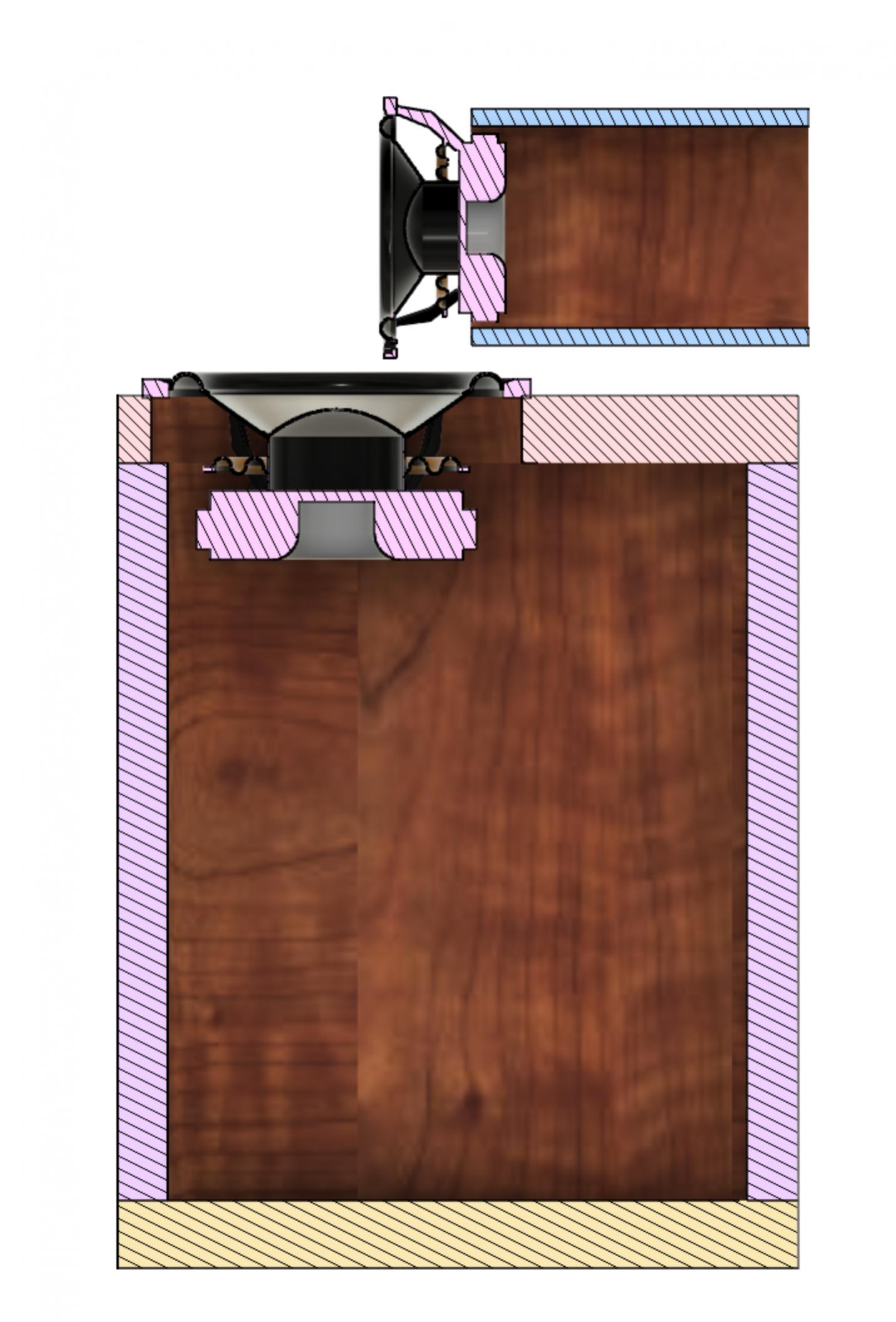

I'm working on a variation of the LXmini, meant for tabletop or stand mount instead of the original straight pipe. SL included a wider/shorter pipe among the examples in his gallery. In addition, while he characterized the pipe as an infinite transmission line (meaning, at least in part, that what's reflected back to the woofer is insignificant), it seems clear that the real goals are (a) no significant reflection back, and (b) no significant radiation off of the walls.
I'm looking at two very similar approaches to a sealed box alternative. In either case, I anticipate building with layers of MDF, which makes it easy to make whatever cross-section is desired. In both cases, I've kept the border around the woofer the same as the original. SL states that there is some baffle diffraction in the original but it's unimportant since the effect would only be heard from the ceiling. It doesn't necessarily follow that added material around the woofer has no effect on the tweeter (comments on that welcomed), so I kept it unchanged.
The picture shows two examples, and I'd be grateful for comments on their relative merits:
Thanks for any suggestions!
Alan
