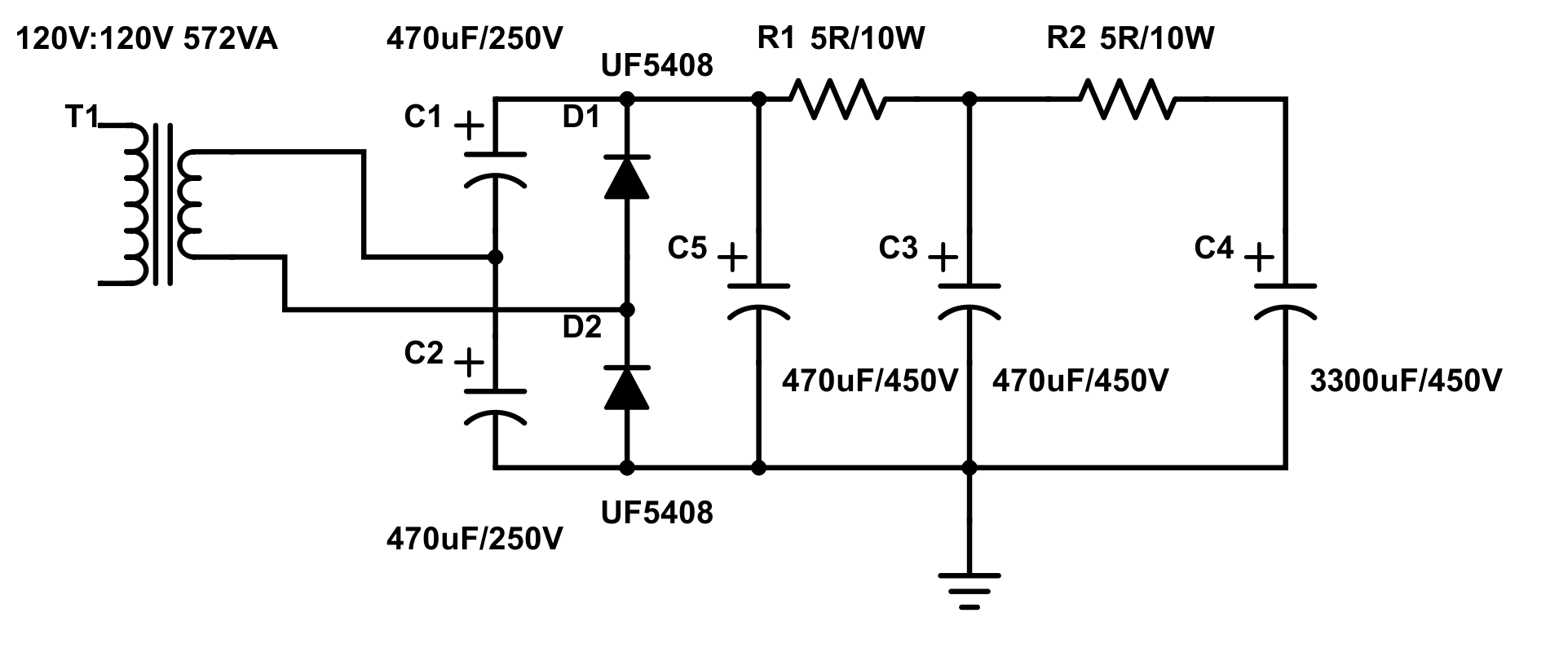

I'd really appreciate some feedback on my circuit. I've been doing a lot of research and come up with the following design, mostly borrowing ideas from hifi amps that make sense to me from a guitar amp perspective.
My first question is about the power supply. Many hifi amp builds I have seen put more emphasis on noise reduction. Many using two chokes and more complex B+ filtering circuitry. I'm more accustomed to a simpler B+ filter design like this:
The B+1 node feeding the OT / Plates of the power tubes comes right off the initial filter cap. No RC or LC filter preceeding. Then I have on hand a smaller choke to help with the screen and the driver tube. Would this simpler power supply design be unworkable in a hifi amp?
My second option would be to buy some beefier 100uf/500v filter caps and add an RC filter to preceed b+1, like this:
The third option would be to also buy a proper choke to replace that 500r/10w resistor.
Would it be a big mistake to go with option 1?

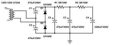

Traditionally, that's how power supplies were built.
Since you aren't using tube rectification, you can use smaller resistors and larger caps.
Here's the PSU I built for my monoblocs...
This is overkill for a class A amp, but 100W AB1 will prevent unwanted voltage sag in the PSU. This is usually desireable in a guitar amp, but sounds like du marde in a hi-fi amp.
BTW this power supply drops less than 10V at 400ma idle @ 320V.

The "full wave" voltage doubler idea kodabmx suggested is the route to high performance at modest expense.
A Triad N-68X, which works in both "120" and "240" VAC zones, will yield slightly more than 100 mA. of B+ and that's enough for a stereoblock employing triode wired SE "12" W. multi-grid O/P tubes.
UFnnnn diodes are among the very best PN parts, in terms of minimum amount of switching noise production. However, zero switching noise is better than low switching noise and this Schottky diode is my suggestion.
Large valued cap. I/P filters generate ripple overtones, which must be filtered out. ALWAYS use a LC reservoir section. When the initial capacitance is gargantuan, the noise extends up into RF range. Scan the archives for my posts about "hash" filters.

Ah, very helpful. I was reviewing Blencowe's page on B+ Filtering - The Valve Wizard. As I understand it, the rectified signal should be DC. So a low pass filter as close to 0 hz as possible would be optimal. frequency = 1 / (2 pi R C).
So a typical B+ filter stage I'd use in a guitar amp would be a 4.7k dropping and a 32uf filter cap.
1.05hz = 1/(2*3.14*4700*32e-6)
However placing an RC filter in front of the B+1 node requires the entire current of the amp to flow through that dropping resistor. So a 4.7k resistor with 100ma+ of current will create a big problem. 100ma of current through 4700 ohms of resistance is a 470 volt drop.
So the solution is to drop the resistance significantly. This will prevent meaningful voltage drop and it will not require such an unreasonably high powered resistor. The resistor and capacitor values are multiplied by one another, so decreasing one while increasing the other offsets the frequency.
i.e. if I drop the resistor down to 470 ohms and the capacitor up to 300uf:
1.12hz = 1/(2*3.14*470*300e-6)
Is there a guideline for the high end of that frequency cutoff point? For example say I use a 470r + 100uf combo.
3.38hz = 1/(2*3.14*470*100e-6)
Also please correct any mistakes in the above reasoning. I'm learning.

Sounds like I need to just bite the bullet and buy a choke.
A decent enough choke can be had for not much money. A Triad C-7X sells for less than $13. Don't worry about the 90 mA. rating. When 100 mA. are pushed through the part, saturation effects will reduce the inductance. 9 H. or thereabout will still provide effective filtering action. 😉 Given the substantial inductance, "normal" caps. in the doubler stack will be satisfactory and a "hash" filter should not be needed. 2X 120 μF. parts in the doubler stack will give performance equivalent to a true full wave rectifier working into 60 μF. That should be plenty. Remember, a 150 mA. rated 6CA4/EZ81 vacuum rectifier is limited to a 50 μF. 1st filter capacitor.
Block potential turn on surge damage to the rectifying diodes and also prevent magnetostriction induced power on clanging, by inserting a CL-140 inrush current limiter in the line between the power trafo and the "center" of the doubler stack.
A https://www.mouser.com/datasheet/2/410/media-1067757.pdf
i use this all the time whenever i could, and since i wind my own traffos, making them to any voltage is no problem for me.....
the pioneer SA-81 that i serviced a few years back used this psu topology...
so did the legendary Harman Kardon Citation 2.....
In my example, the final filter is 5R/3300uF. This is roughly 10Hz and it works fine, no hum to the speakers, however I'm using this only for B+ for the push pull output stage. PSUD2 says that filter has 124mV of ripple at 318V. Push pull has CMRR, SE does not. Whether or not 124mV is low enough hum I don't know, but I would assume you'd need to put your ear in the woofer to hear it.
