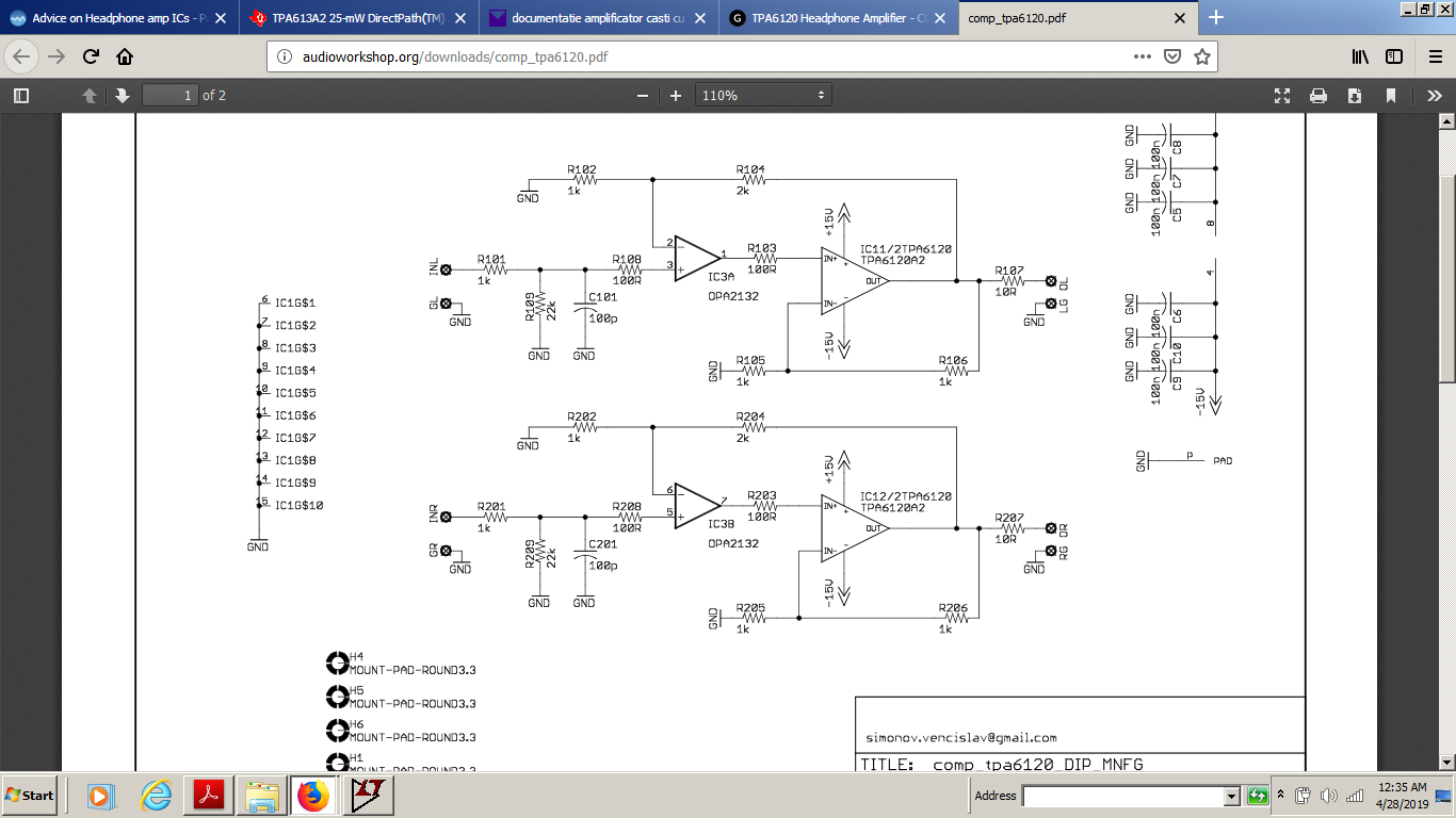

tpa6120 ( ths6012)
TPA6120 Headphone Amplifier - COMPOSITE TOPOLOGY - DIY AUDIO BLOG, AUDIO WORKSHOP
This is what i am using for most of the time and the only am that sound as good as this one is a Kenwood 2x30w amplifier that runs the headphones straight from the speakers output.I run it at 5...10% log volume scale on my headphones.My version of composite tpa 6120 was made by a friend of mine to have smd components and i use opa1642 instead of opa2132 but the sound must be very similar in both versions due to the circuit principle.

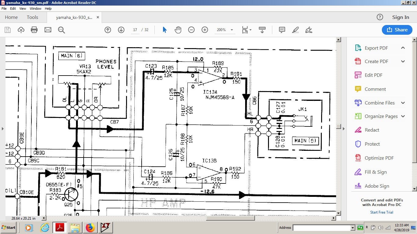

or njm4556 in inverted topology(yamaha kx-930 schematic).
Nothing better in ic form.
