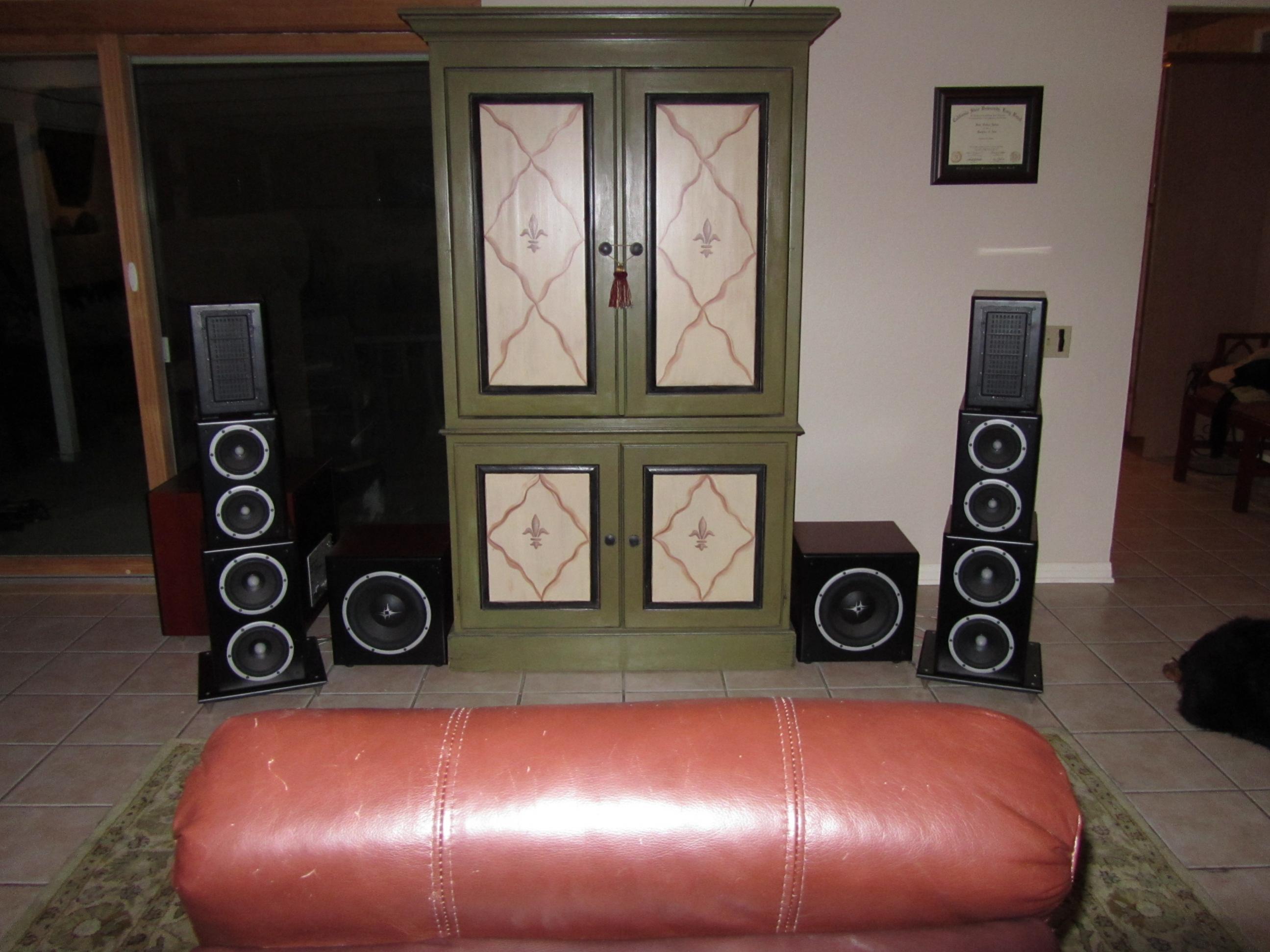

I've built the Tritrix MTM TLs, the ER18s (my personal fav), and the Statements.
A couple things you said that have me wondering are "good w/ drum beats, and the occasional loud party". I'm not sure if you'll be happy w/out a sub. Or, you could build the Statements. Those have great bass and they sound incredible as well. They're HUGE; but if you can get past that, I think those should be included in your options. My $.02
AdasonRemlab, what are you using as a tweeter?
I was hoping someone would ask. I originally used a neo 3, but got the idea of trying the Neo 10 dsp'd flat, as a midtweet. It measures +/- 1db from 300hz to 20khz on axis at 60". The Neo 10 actually has output to 40khz.
http://www.zaphaudio.com/temp/B&G-Neo10-FR.gif
The tightly controlled dispersion is perfect for my highly reflective listening room and the highs are breathtaking with my tube amp driving it in my 5 way, fully active system..
