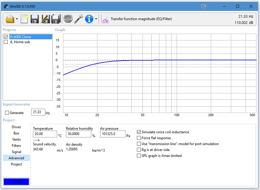

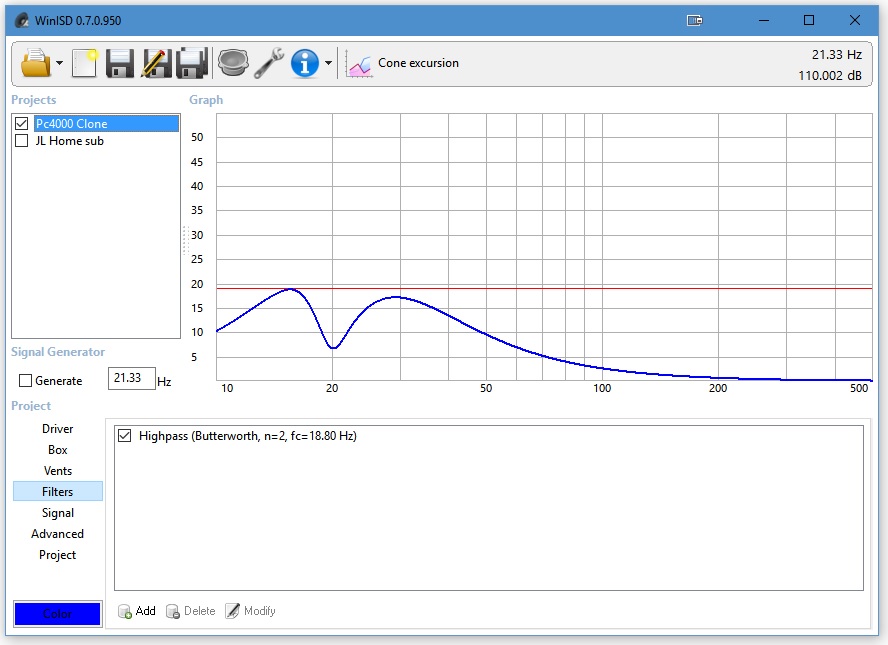

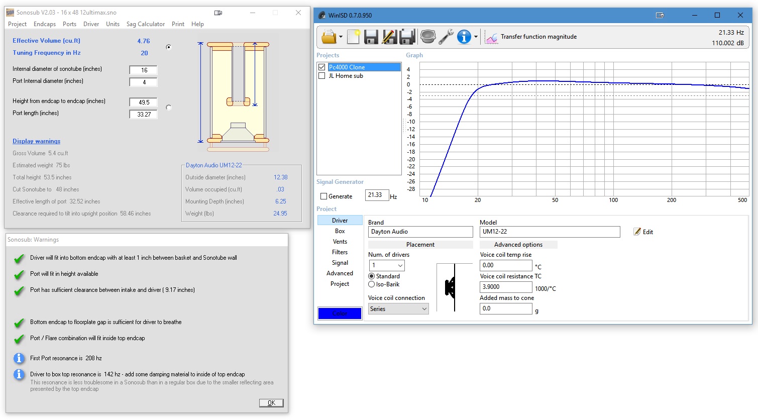

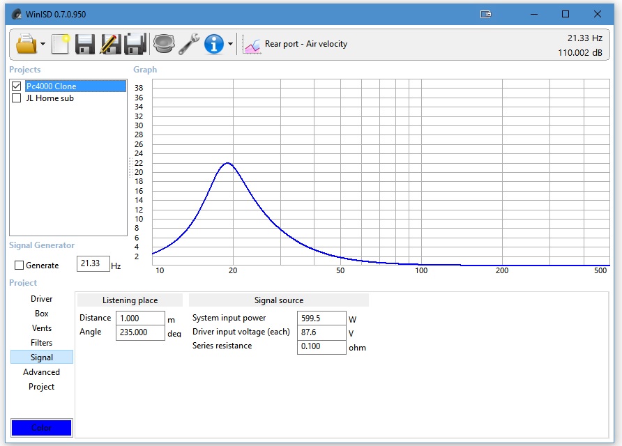

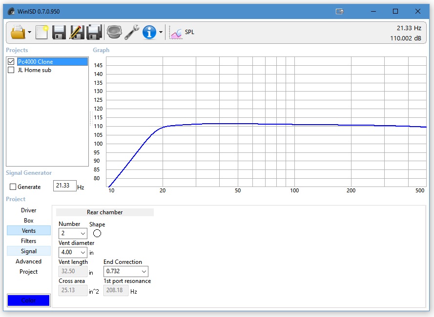

Hey, sorry it took me awhile to get back to you. I've been doing some more research and learning this last week, including fiddling around with winisd. I'm still pretty clueles on what I'm looking at on most of the graphs, but I think I'm closing in on something that might work.
My room layout is a bit challenging in that it is fairly large (6300 cu ft), but only 12.5' wide... so also narrow. It's on a second floor so has the unfortunate aspect of having sloped ceilings on both sides. the side walls go up to right at 56" before angling towards the center of the room at about 50 degrees. Due to this I'm pretty limited on height. I'd say right at 56" for 24" tube and maybe as much as 60" for a 16".
I know my room would do better with 18's, but after really playing around with the configurations, I just wouldn't be able to fit them anywhere in my area.
The 12" in a 16" tube is what I am looking at and have been playing with this week and is what I'm seriously considering right now. I can also source 16" x 48" tubes locally. I could special order bigger tubes, but I'm looking at mid to late march as the earliest arrival and that puts me in a real bind as far as actually having the time to put them together due to it being one of my really busy times of year.
So... Right now I'm really looking hard at the Dayton UM12-22 12" Ultimax in a 16"x 48" tube. I was aiming for a tuning of 17 hz, but I needed a bit more height than a 48" tube could provide, so I raised it up to 20hz. Some people might be able to tell the difference, I've made peace with the fact that I'm probably not one of them, so I think it's a fair compromise to keep my tube where I want it. 🙂 As far as SPL goes, I really have no idea what to shoot for. I'll include the winisd graphs I came up with below (not sure why the last one didn't show). I mainly watch movies with my setup and I like it loud, though I don't often have it that loud. I don't really need wall rattling, wake the neighbors bass. A nice tight response with a little kick to the chest on explosions, would keep me happy. I don't like it overly boomy, and I definitely want to avoid any port noise. I was going to get the NX6000d to drive them, but since I'm looking at building the 12's I'll probably go with the much better matched NX3000d.
Before I throw the graphs up I'll write out the key stats, just in case the images don't work again.
From Sonosub:
Effective volume: 4.76 cu ft
Tuning: 17hz
ID of Tube: 16"
ID of Port: 4" x2 (it's given me the best results in winisd, from what I can tell) Flared 3/4" on both ends
Height (endcap to endcap): 49.5"
Port Lengths: 33.27
Gross volume: 5.4 cu ft
Estimated weight: 75 lbs
Total height (with floorplate): 53.5"
sonotube: 48"
Effective port length: 32.52"
first port resonance: 208hz
boxtop resonance: 142hz
From Winisd
HPF: set at 18.8hz
System power: 599.5 W
Port Air Velocity: 21.87 m/s @18.95hz
Cone Excursion: 18.815mm @15.55hz (xmax = 19mm)
SPL: Shows max around 111.5dB @39hz. falls below 110dB @21hz
That's about all I've got for now. How does it look and is there any other graphs I should be looking at or trying to get data for? I'm not hard set to the 12" ultimax, so if there are any other drivers you can think of that would fit in the enclosure size I'm shooting for that hit a little harder and louder, I'm definitely willing to give them a look.
Images should be attached below... I hope. 😀
