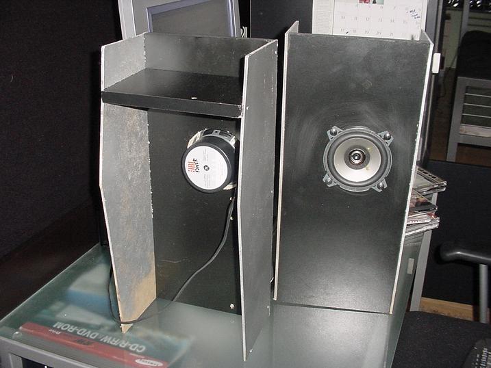

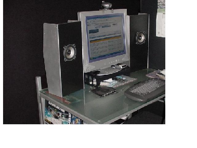

Hi, just thought I'd throw in a different angle.
This http://store.yahoo.com/justdeals/9701010403.html - $65
for you sub + amps (THX certified for whatever its worth)
Plus
This http://www.techronics.com/index.cfm?fuseaction=product.display&product_id=439&aff=31766 - $88
Plus http://www.madisound.com/cgi-bin/index.cgi?cart_id=9394226.19885&pid=411 and http://www.madisound.com/cgi-bin/index.cgi?cart_id=9394226.19885&pid=415 - or something similar + some L-pads. Maybe $20 total or so.
Mount the infinity's Open Baffle. Hopefully you have some form of measurement system. A little experimentation with cardboard was all it took for me. Sounds way better than any computer speakers that I've heard. You may be quite suprised by how good it sounds. You could probably pick up something like the infinity's even cheaper on ebay.
The OB's work well even 10" or so out from the (back) wall. At least for mine it did.
Just my 2 cents.
Cheers
AJ
I'm going to have to disagree with you completely on this one dude. I've owned Logitech speakers and that exact model of Infinity Kappas and they're both pretty horribly unbalanced. The sub is too small, the crossover is set too high and it's terribly underpowered and those Kappas are painfully bright, though just about all inexpensive car speakers are, the Kappas are some of the brightest I've heard. If he were to spend that much on drivers, he should look at Fostex drivers. They're much better balanced. The FE127E is in that same price range and would sound so much better.
Fostex?
First, let's agree that we disagree. The man asked for suggestions and I gave mine. The logitech sub is about 12"x12"x15". Too small? 8" ported woofer with (claimed) 120w rms. I swore he said about 12" per side max. Most reviews claimed it put out plenty of bass. Bass quality might not be state of the art, but we are talking about $65 for the sub and amp FOR ALL CHANNELS. Output for a dorm room should be plenty. (Huge) Mass production allows some quality for that type of pricing. I honestly can't claim to have measured the Infinity's, but I have heard them. Thats the other nice part, so can he, BEFORE he buys them (or another similar car speaker for that matter). The high Qts of car speakers make them ideal for OB down to the 120hz (approx) XO of the sub. They are made for strong off axis treble since most will be mounted in doors. SOME can sound bright on axis, especially to someone like you that favors the Fostex sound. I looked up the FE127 at madisound. The 7db peak at 7k coupled with the plummeting top octave (I especially like the off-axis free fall) should sound wonderful to some. Just not me. The lack of XO may make for a good midrange, but thats about it. Awful bass and treble may again be ok for some, just not me.
BTW I measured my cheapo old JBL P422's using TrueRTA and they measured nearly ruler flat - BOTH ON and OFF AXIS. It would put that Fostex pc. of junk to shame. Have you ever seen distortion measurements on a fullrange driver? The're not pretty!
Once again, for some this is a desirable trait, just not me.
I also said "something like" the infinity's. There are other choices. Together - as a whole - Logitech sub, OB Infinity (or similar) coaxial car driver, I would happily put up against anything you could make for $150. A real tweeter (with lower distortion/better frequency response) and a real woofer (same) may sound better to some, but not all😉 Just my 2+ cents.
Cheers and good luck Dr. P
AJ

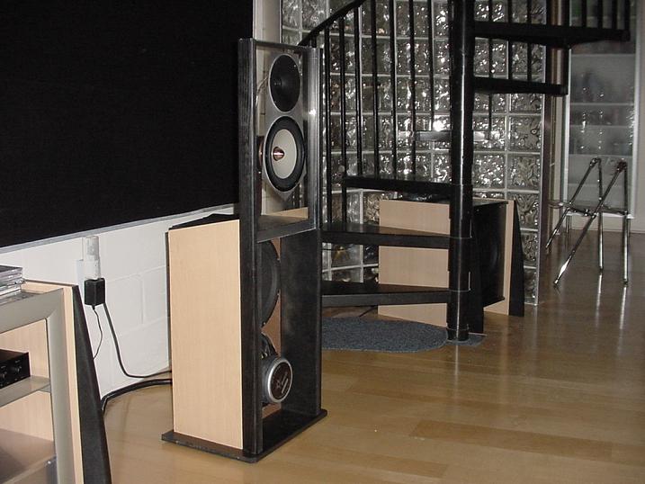

Here's my "reference"
