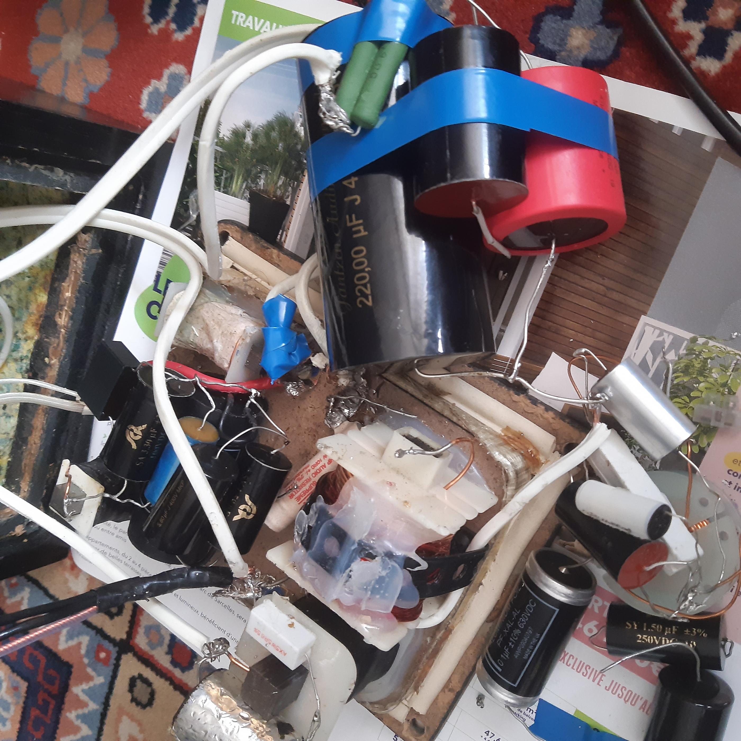

I'm back. Inverted mid is working much much better - my half sim just based on ideal drivers but with te values of the filter worked well here, the deep seen here despite not knowing the acoustical slope of the raw drivers worked quite well enough.
All seems ok now after ten minutes of listening but will go further wih measurements later. For the moment woofer and tweet in positive polarity and mid inverted works fine!
pictures for the fun. Transcients are working fine here : Wild thing - YouTube
coils values are not the real ones, just an abstraction from sim on line. However the design was made with something 260 uf to 280 uf for real 😉. Don't forget this is not the measurement seen by a mic yet. Cut-offs aare from the owner manual. The other caps value are the originals.
Btw again, on the tweeter network I find strange to find C1 & C2 inverted in the loudspeaker I have in relation to the on line sims. I mean 6 uF should be seen first then 14 uF after only ????
The 1 uF // to 10R to climb up the post 10K hz are non an evidence for me, I find it better without.
With respect, the whole thing looks a muddle... 😱
This is how you do a 4th order 3kHz tweeter:
Impedance is then good:
Your bass to mid crossover seems unecessarily low, entailing huge components, Troels does it differently.;
SEAS-3-Way-Classic
Not much difference between third and fourth order tweeters IMO. Probably wire the same. Mid and tweet in phase.
SEAS-3-Way-Classic
